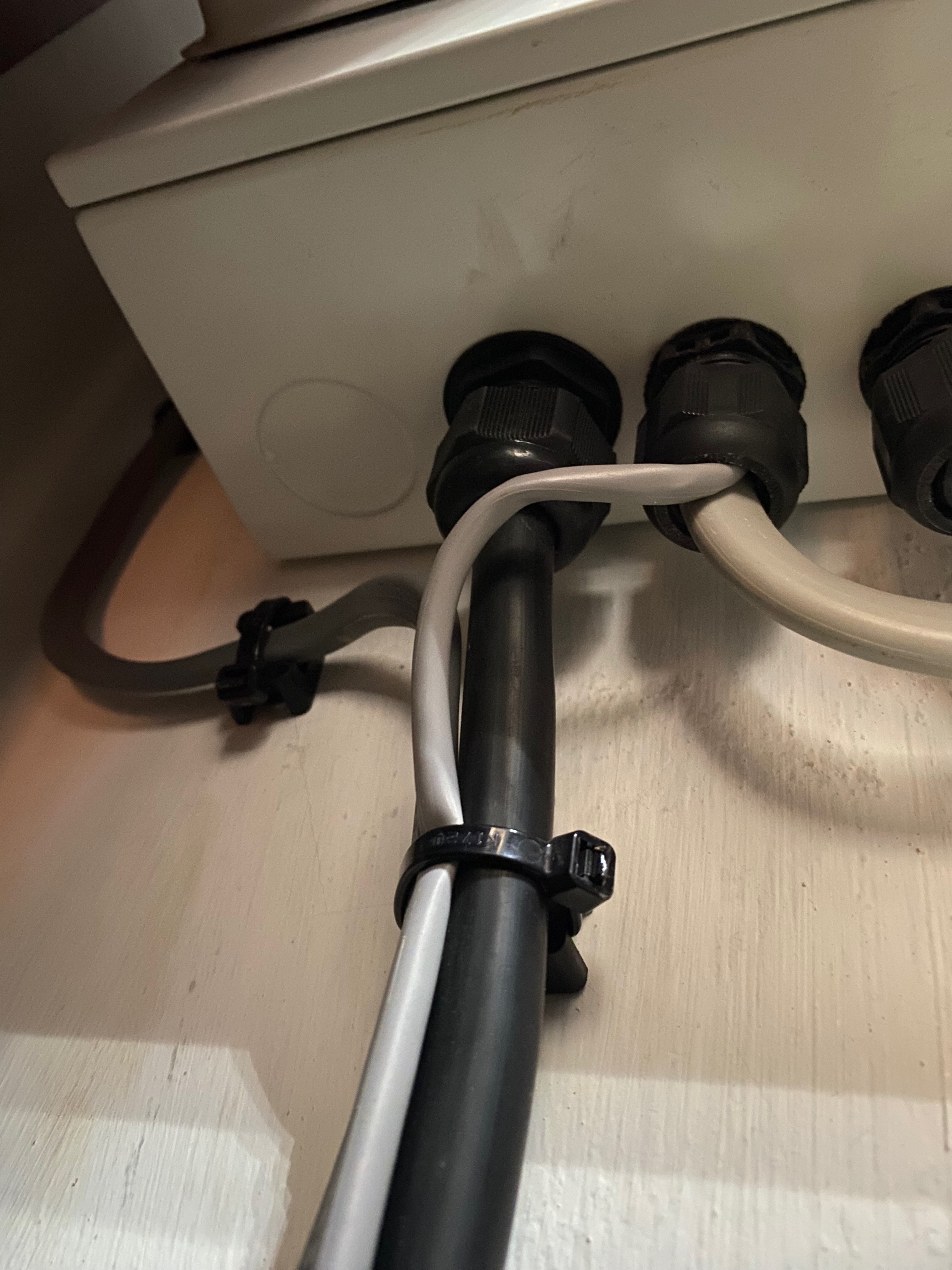

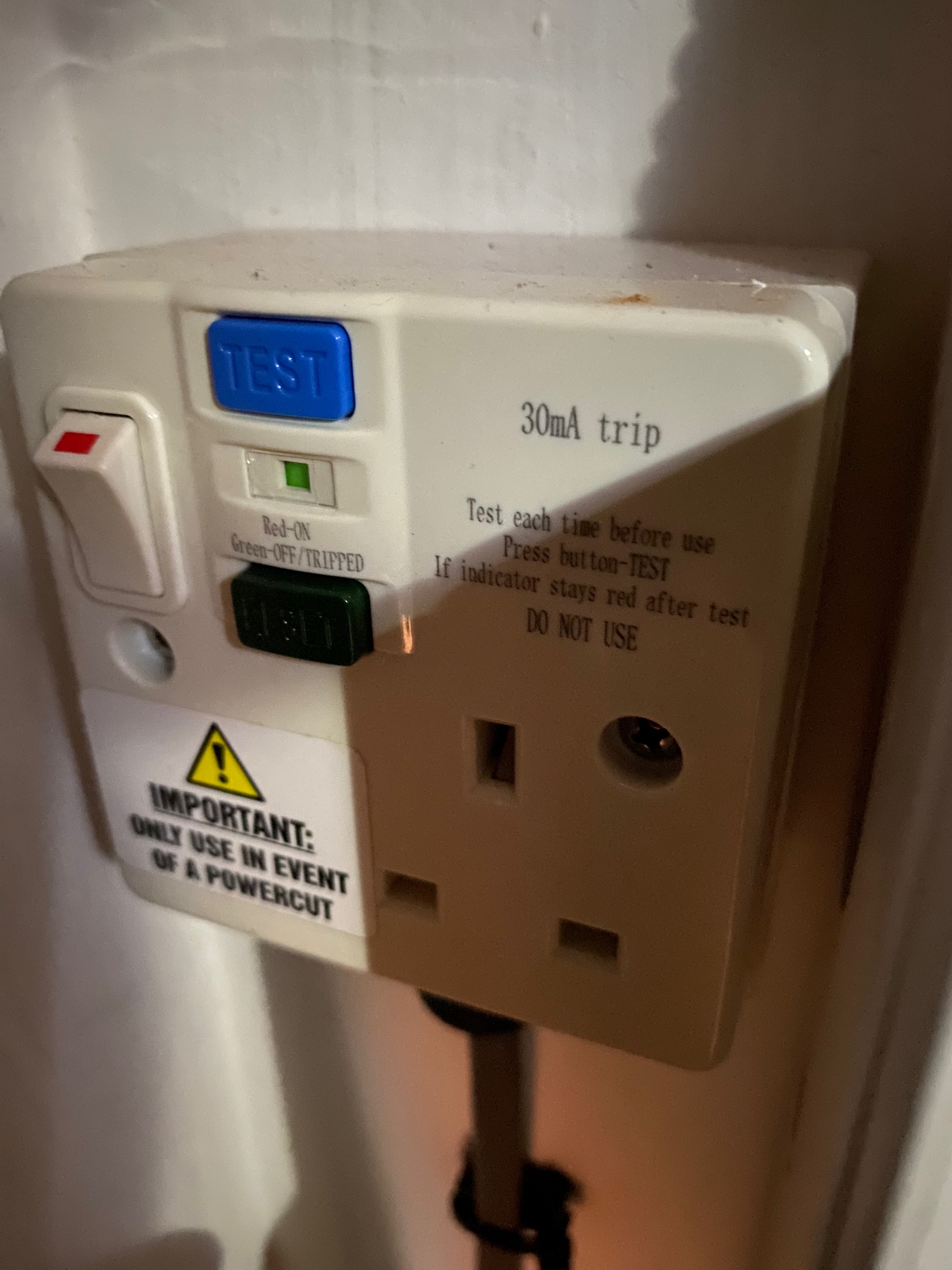

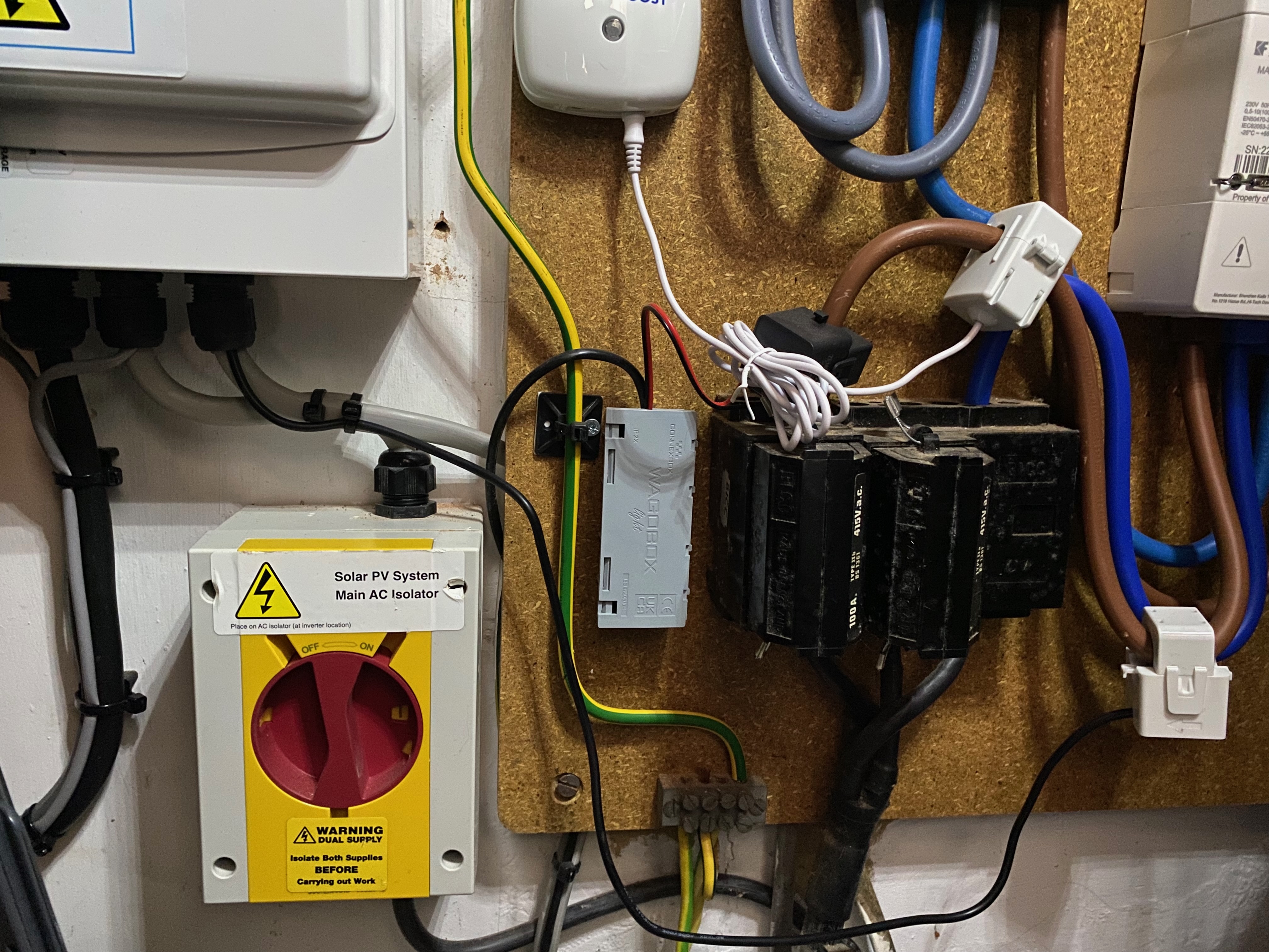

I have taken some photos of the inverter connections and one of the battery connections.
I'm none the wiser; nothing obvious that looks like that square connector.
John
John
3rd picture John,
Meter / CT / RS485 There are some pressure points you push in on both sides (depending on how you look at it) and you can then pull it out.
Before you play tug-o-war, you have to power down the Inverter/battery to do this.
How close this is going to be to your HA Green is another consideration, as you need to feed a cable between the two items.
There are two big problems;
1. Following the cables from the battery (housed outside), I would need to move the HAG to the electrics cupboard under the stairs where there is no socket.
2. The cable enters the house behind either the inverter or battery so I would have to lift it/them off their mountings.
So I'm not yet sure if the hole is big enough for another cable.
What sort of cable is needed? Something like an ethernet cable?
I still think I'm going to need an electrician. I'm comfortable extending a ring main with a new socket but not directly off the consumer unit. And it would take two strong men to lift the battery off the wall to expose the hole in the wall.
John
John
The cable that goes from the Meter / CT / RS485 will enter your house and head towards your electric cupboard, where you should find a CT Clamp.CrabbyHorse wrote: ↑Sat Apr 18, 2026 10:58 am There are two big problems;
John
If you are very lucky, this cable is more than likely going to be a ethernet cable. If you check in your meter cupboard, you might be able to find the CT Clamp wrapped around the mains after the meter. Carefully take a look at the cable feeding the CT Clamp to see if there are some spare wires in the cable.
Depending on what you find at the meter end of the cable, you might just be able to utilise an unused pair for the RS485 connection.
Have a little dig about and let us know what you find.

I have just looked in the cupboard under the stairs and have taken these three photos.
There are three cables coming in from the the external inverter/battery. One powers the emergency socket for when there is a power outage, and the other two go into the bottom of the solar panel consumer unit.
Another small black cable comes out of the same unit (don't remember if it was there beforehand), which goes to a clamp on the the main red solar cable. There are two other clamps on the same cable; one (white) to the iBoost water heater (obsolete now) and another (black) that goes into the small grey Wagobox. I don't know what it's for.
Any ideas? It doesn't look very promising to me!
John
