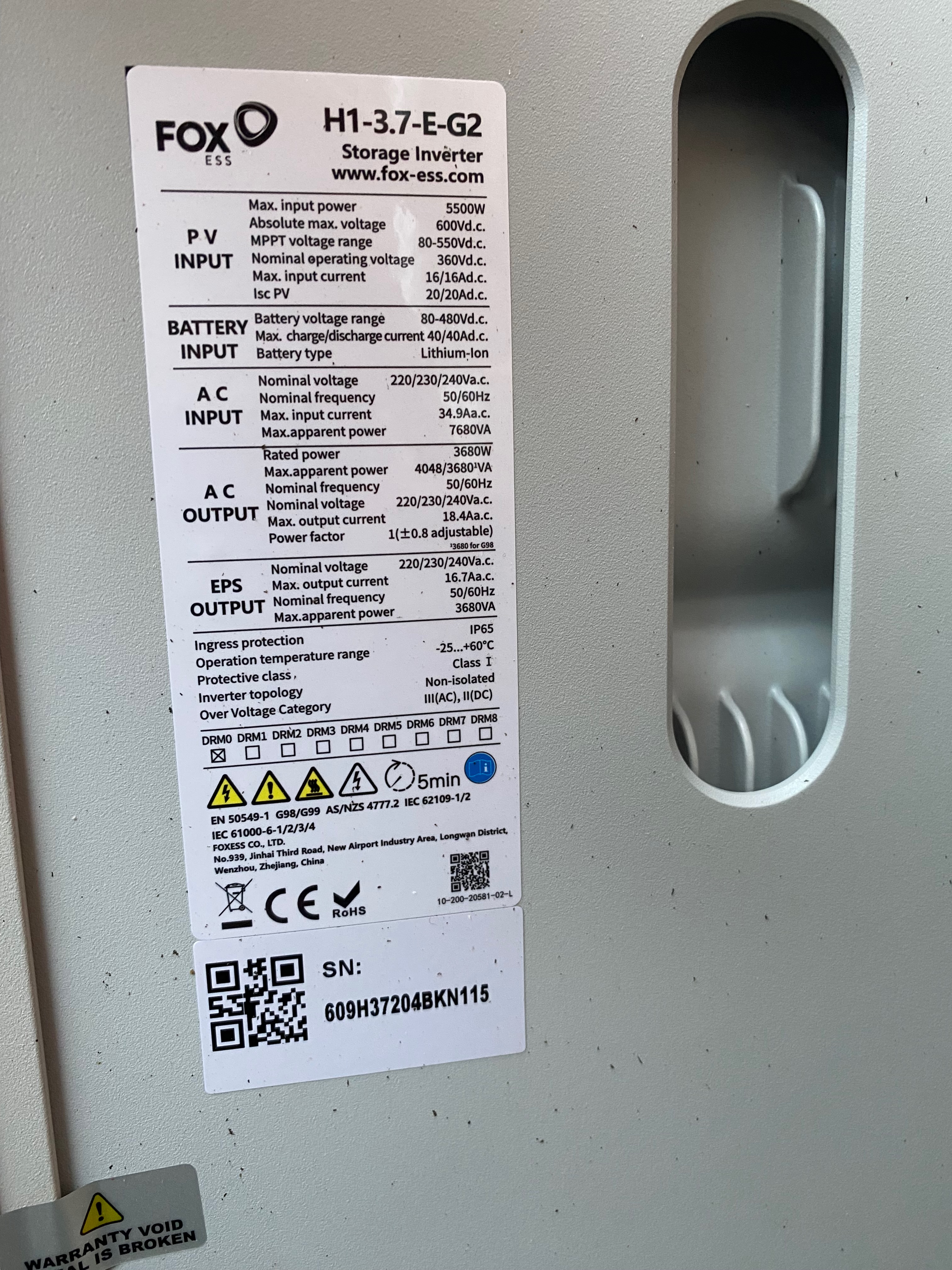

So to talk to your Inverter, we need to have some hardware in the middle of it all. This does depend on what Inverter you have, as some have modbus via WiFi ability.
I have one of these for the hardware between the HA Green and my Inverter.
https://github.com/nathanmarlor/foxess_ ... 85-%28B%29
So what Inverter do you have, you might be a lucky one with built in communications.

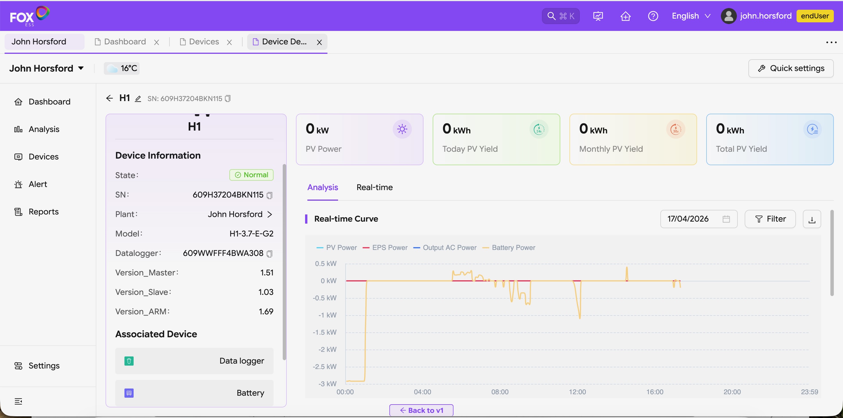

Here is the rating plate:
And the info from the App :
So it has a data logger if that is what is needed?
