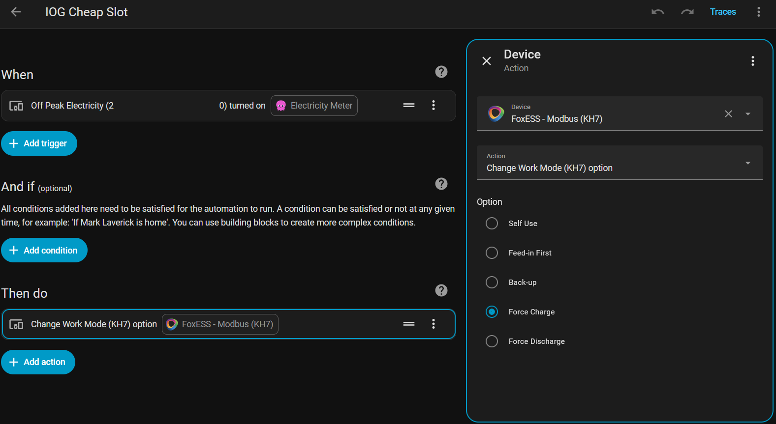

I have an H1 inverter - so if you set the Minimum SoC it doesn't charge the battery at all (but does stop discharge) - so below is the code / automation I use to change the working mode.
Notes:
Enjoy... it may take some time to get the code working... but using ChatGPT can help a lot!
Notes:
- When setting up, I created a blank automation, then used the 'id' for that and replaced the generated code with that below.
- Also the notification is just so I could check it works reliably, will probably remove those after a few weeks
- Replace the XXX with your entity / meter number
- Is based on 7p / 25p import rates, at the point of creating this - can adjust according to need
- This code goes into automations.yaml file - but be careful with any edits!

With Will's solution, that I have implemented on my HA Green, it simply listens for the 'off-peak electricity' flag to be turned on, which should happen during the overnight period OR if you get a random slot assigned outside of the fixed off-peak times. It works fine with my Zappi, I do not control it at all. I am not sure what integration there is with the Ohme within the HAOS, but there could be some 'flags' there to capture when it is commanded to start.
