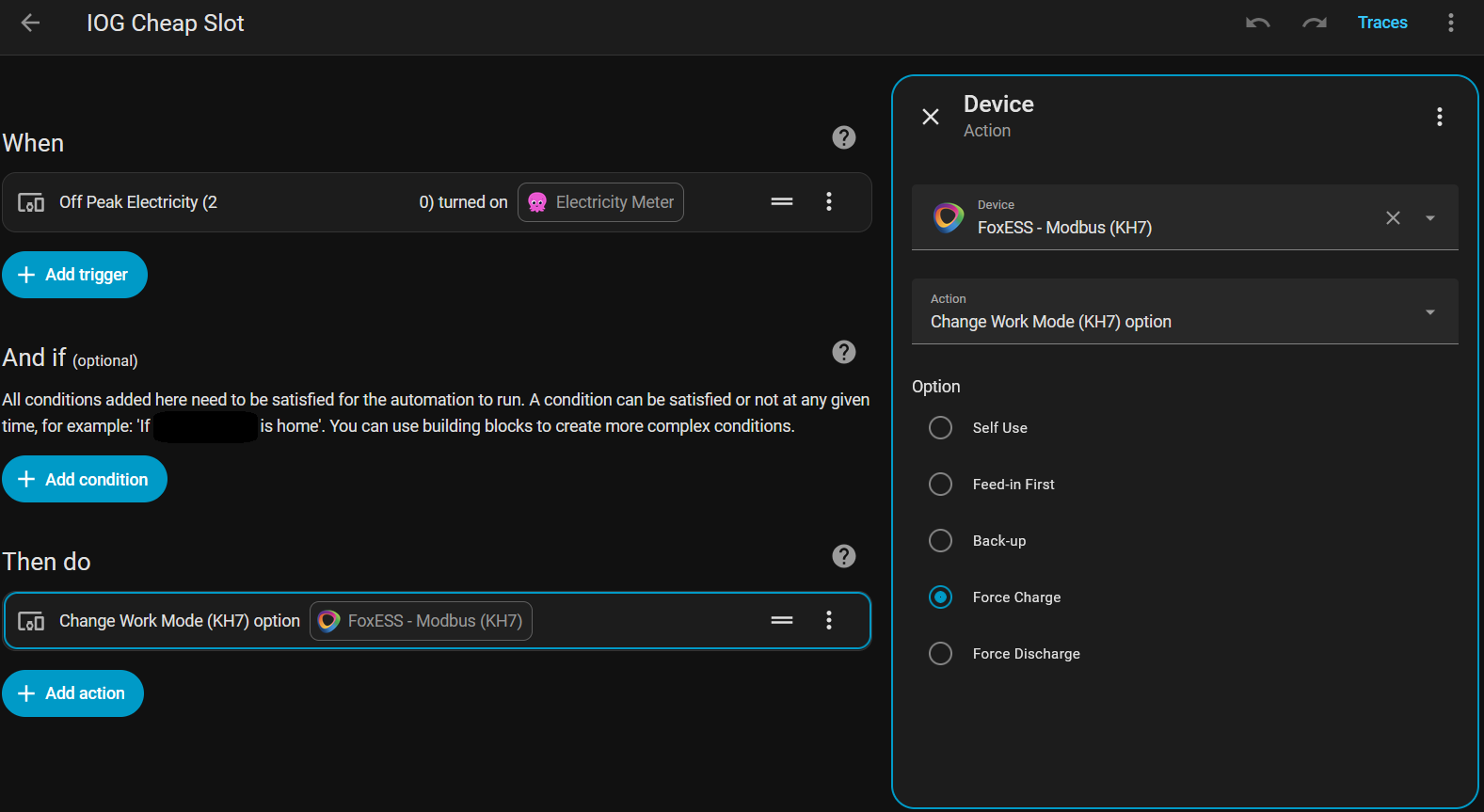

Thanks Will - excellent automation - solves a lot of problems!
I have an H1 inverter - so if you set the Minimum SoC it doesn't charge the battery at all (but does stop discharge) - so below is the code / automation I use to change the working mode.
Notes:
Enjoy... it may take some time to get the code working... but using ChatGPT can help a lot!
Notes:
- When setting up, I created a blank automation, then used the 'id' for that and replaced the generated code with that below.
- Also the notification is just so I could check it works reliably, will probably remove those after a few weeks
- Replace the XXX with your entity / meter number
- Is based on 7p / 25p import rates, at the point of creating this - can adjust according to need
- This code goes into automations.yaml file - but be careful with any edits!

- id: '1738061409369'
alias: Set Inverter Mode based on electricity prices
description: ''
triggers:
- entity_id: sensor.octopus_energy_electricity_XXX_current_rate
trigger: state #this trigger happens whenever the electricity price is updated
conditions: []
actions:
- if:
- condition: template
value_template: '{{ states("sensor.octopus_energy_electricity_XXX_current_rate")
| float > 0.20 }}' #checks if the current price is >£0.20 - adjust as needed
then:
- data:
message: Trigger above 15p. Price is £{{ states("sensor.octopus_energy_electricity_XXX_current_rate")
title: Rate change
action: notify.mobile_app_pixel_6 #sends notification to my phone when change has been made
- target:
entity_id: select.work_mode
data:
option: Self Use
action: select.select_option
else:
- data:
message: Trigger below 15p. Price is £{{ states("sensor.octopus_energy_electricity_XXX_current_rate")
title: Rate change
- target:
data:
option: Force Charge
mode: single

With Will's solution, that I have implemented on my HA Green, it simply listens for the 'off-peak electricity' flag to be turned on, which should happen during the overnight period OR if you get a random slot assigned outside of the fixed off-peak times. It works fine with my Zappi, I do not control it at all. I am not sure what integration there is with the Ohme within the HAOS, but there could be some 'flags' there to capture when it is commanded to start.
The low power slots have always been independant of the fixed overnight slots, only real change is you are only allowed 6hrs of charging time per 24hrs (an Octopus day starts at 12pm) typically overnight is cheap power, so majority of the slots allocated are set to overnight. If the grid has surplus in the evening, and it benefits Octopus in your area, they could charge your car for 30mins or more to balance the grid.
If the car is charging via Octopus IOG, then your home (cooker/battery/whatever) will be at the cheap rate. The only exception is if you choose to 'bump' charge and then it is at peak rate.

Sorry for the slow response.
I followed your link and read it but am really none the wiser. I think I have reached the end of the road on this one. Perhaps if I had an Octopus charger and an Octopus battery (if such exists), Octopus could have sorted it out for me. Otherwise, there must be thousands of householders like me who have this problem and find it all too complicated to fix without paying hundreds of pounds for a re-wire. Perhaps they should have wired it up to avoid this problem in the first place.
So for now, when I plug in the EV, I am experimenting with switching a 'Force Charge' mode schedule to 'on' when the charger says that it is charging the EV at low tariff and setting an alarm clock to the finish time of the slot so I can switch it off again. May need to do this several times in an evening! So easier to go back to setting the alarm clock to 23:30 to release the Ohme authorisation hold.
So I have put the HAG back in its box. Perhaps I could make use of it to control smart lightbulbs and curtains when we are on holiday?
Anyway I just wanted to thank you for all your help even though it was fruitless. I'll let you know if I ever get it fixed.
