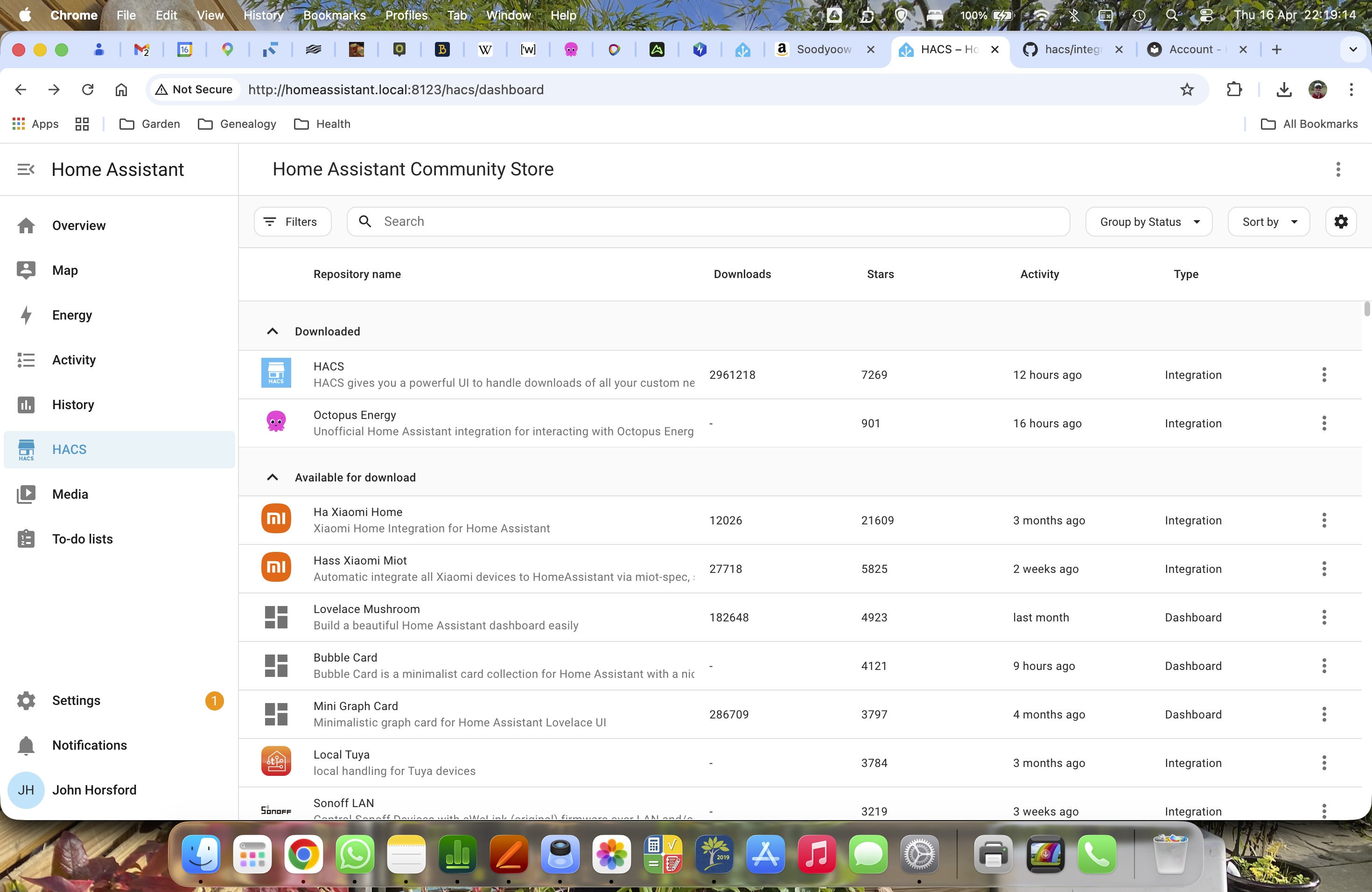

Re: Using Home Assistant to control house battery and EV battery charging with octopus intelligent go
I never thought this was going to be so difficult!
I added HACS after a lot of head-scratching (the 'my link' wasn't there to click on).
I have got this far with adding Octopus - with an update outstanding .
Am I right so far? What happens now?
John
If you have not yet setup your Octopus integration, then you need to click this, you will probably need your Octopus Api key and account number (been a whiile)
https://my.home-assistant.io/redirect/c ... pus_energy
Let me know if you have already done this setup already.
