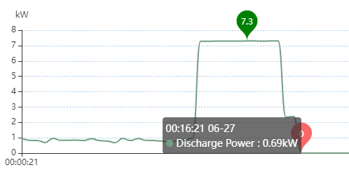

I then switched it off, and tested the mode scheduler to force discharge to the grid between 4 and 6pm, which also worked great, although I had to do this through the website, because the app mode scheduler appears totally broken. It pushed out 12 kwH at 6 per hour for 2 hours, so again, great result.

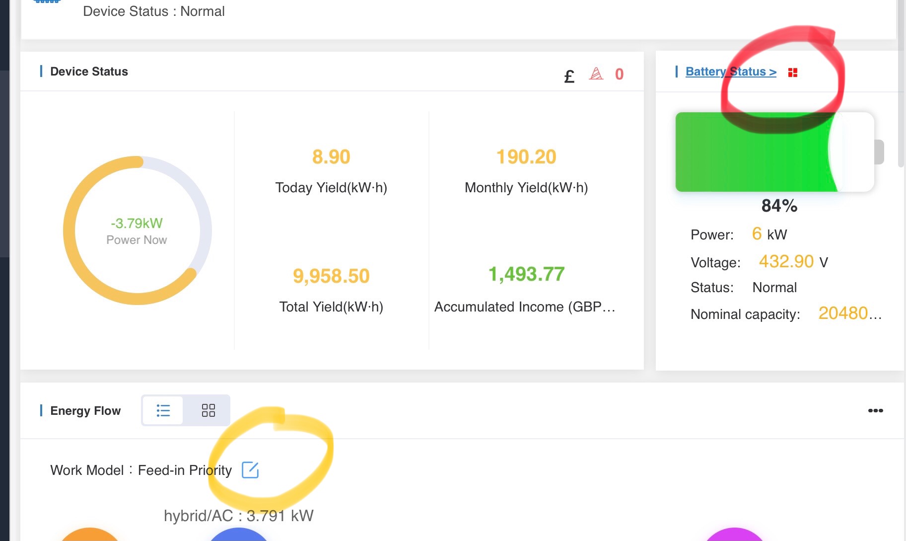

On the website go to the Inverter details page (the one that shows ‘Energy Flow’), then click on the red box in the red circle if you want normal battery charge periods, or the blue icon in the yellow circle if you want scheduler

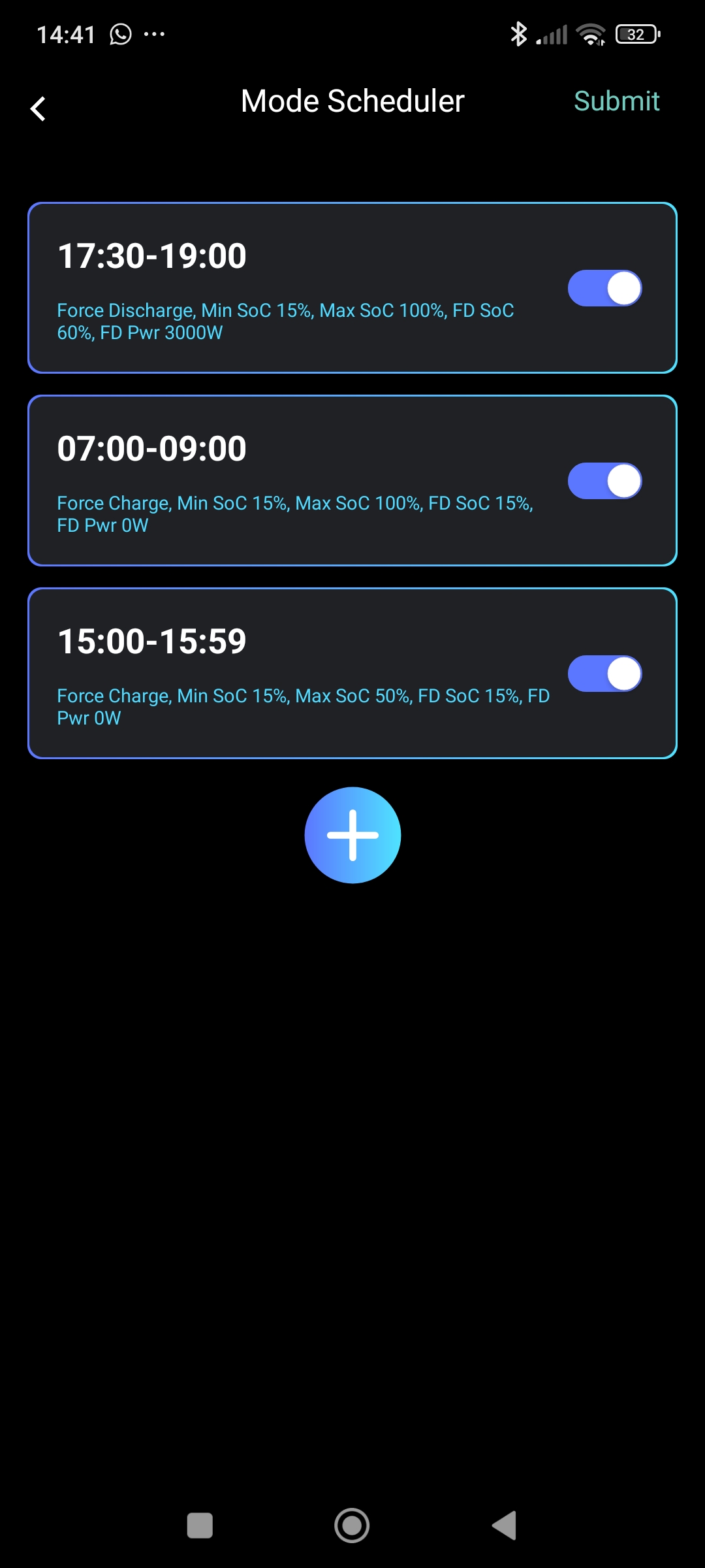

To force discharge we use mode scheduler. We set the force discharge to 60% at the moment so the battery doesn't go below that as we need that much to get us to 2 am when it's cheaper rate. I'll try add a photo. Best time to export is between 4 and 7pm You need to set fd as well. Ours is set at 3000 but we have a 6kw inverter so could be 6000its the rate it exports at. Not sure if that answers your question..you do have to click save and submit and it overrides any other settings for charging or discharging. There is a good video on it if you search...think I found on here somewhere but you do have to be careful as some of the newer products have updated features.
