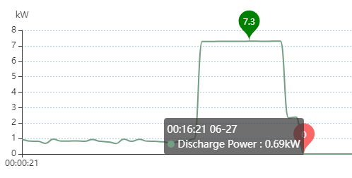

I set forced charge in the mode scheduler on the website last night, and instead of charging, it discharged (see attachment)
I've been playing around with different settings this morning, and while I've managed to get the battery to charge a bit from the grid, I can't seem to get it to charge at max like it does from the basic "force time charge"
What settings do I need to enable the mode scheduler to force charge at max capacity please?

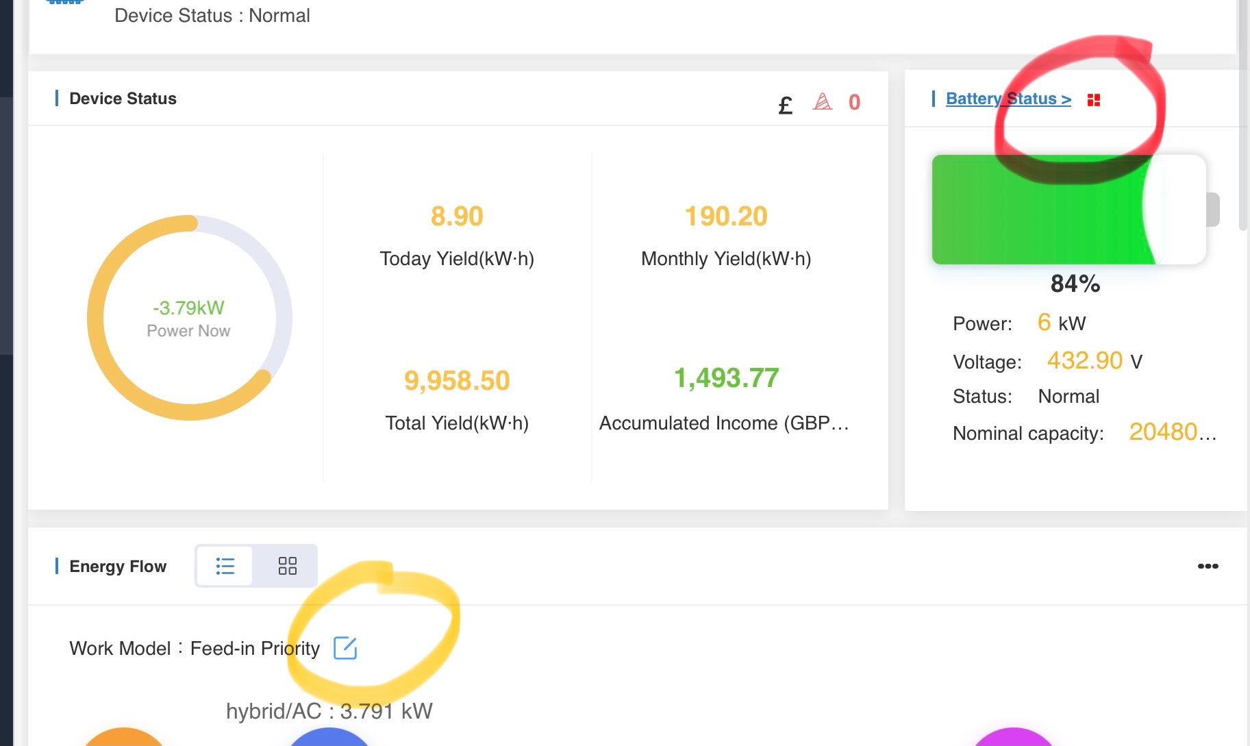

Some of you have made reference to updating the settings on the website, I have looked on the foxesscloud but can’t see anywhere to update settings, could you point me in the right direction please?
BMS: HV2600 v2 version 1.013
Inverter: H1-3.7-E. Version (where do I find that?)
Battery: 3x HV2600 v2 version 1.13
Posts: 1786
Mark-Averill wrote: Tue Sep 10, 2024 12:26 pm Some of you have made reference to updating the settings on the website, I have looked on the foxesscloud but can’t see anywhere to update settings, could you point me in the right direction please?
On the website go to the Inverter details page (the one that shows ‘Energy Flow’), then click on the red box in the red circle if you want normal battery charge periods, or the blue icon in the yellow circle if you want scheduler
