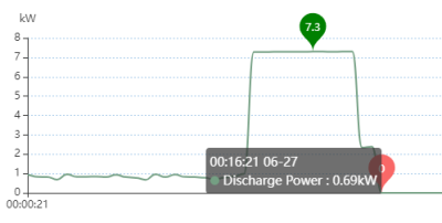

I set forced charge in the mode scheduler on the website last night, and instead of charging, it discharged (see attachment)
I've been playing around with different settings this morning, and while I've managed to get the battery to charge a bit from the grid, I can't seem to get it to charge at max like it does from the basic "force time charge"
What settings do I need to enable the mode scheduler to force charge at max capacity please?

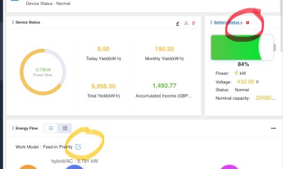

On the website go to the Inverter details page (the one that shows ‘Energy Flow’), then click on the red box in the red circle if you want normal battery charge periods, or the blue icon in the yellow circle if you want schedulerMark-Averill wrote: ↑Tue Sep 10, 2024 12:26 pm Some of you have made reference to updating the settings on the website, I have looked on the foxesscloud but can’t see anywhere to update settings, could you point me in the right direction please?

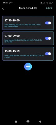

Octopus flux best import rate 0200-0500 hrs. Managed to set this on fox cloud2 app. But no idea/ cannot find how and when batteries can export.
Can someone explain in easy terms
To force discharge we use mode scheduler. We set the force discharge to 60% at the moment so the battery doesn't go below that as we need that much to get us to 2 am when it's cheaper rate. I'll try add a photo. Best time to export is between 4 and 7pm You need to set fd as well. Ours is set at 3000 but we have a 6kw inverter so could be 6000its the rate it exports at. Not sure if that answers your question..you do have to click save and submit and it overrides any other settings for charging or discharging. There is a good video on it if you search...think I found on here somewhere but you do have to be careful as some of the newer products have updated features.
