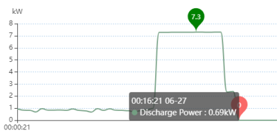

I set forced charge in the mode scheduler on the website last night, and instead of charging, it discharged (see attachment)
I've been playing around with different settings this morning, and while I've managed to get the battery to charge a bit from the grid, I can't seem to get it to charge at max like it does from the basic "force time charge"
What settings do I need to enable the mode scheduler to force charge at max capacity please?

I’m assuming you have a KH9 ?, the first thing to say is to get your firmware updated to the latest version if you haven’t already as there have been a number of changes and bug fixes with this being such a new inverter.
The app scheduler is having problems at the moment as Fox have added the ability to schedule a force charge to a specific MaxSoC - the problem being that only the very latest firmware for the H1 works with this, which means you have to set it on either the V1 app, the website or using Energy Stats. There have been a number of releases which profess to fix the app, but i’m still hearing some people report it doesn’t work for them.
You are correct in that you cannot use the older charge periods at the same time as the scheduler - it is one or the other. If you try and set a charge period when a schedule is set you’ll get an error in the app.
The scheduler force charge and the old charge period ‘should’ be the same but they measure the load and charge differently so there are small differences of charge rate between them - earlier firmware versions didn’t allow scheduled force charge to use solar power in combination with grid either but that has been corrected on latest firmware.
The scheduler for force charge only needs the time set and minSoC, FDSoC and FDpwr are ignored but they must be set to the defaults of 10,10 and 0 - if it gives you the maxSoC option set it to 100.
Personally I don’t use the scheduler for anything, I use the old charge periods as they ‘just work’ - plus if there is a cloud outage (not unknown for Fox), you can set or unset charge periods through the inverter menus, you cannot do that with the scheduler once running it is locked in unless you have cloud access to disable.
So I think to summarise make sure you have the latest version of firmware, and where at all possible use the older ‘charge periods’ with charge from grid enabled.

Thank you so much for this!
I do have a KH9. I've emailed support to see if I'm on the latest firmware (currently: Master : 1.29, Slave : 1.01, Manager : 1.21, but no idea how to check if that's latest myself)
I don't see a MaxSOC option anywhere on the website, and energy stats tends to time out a lot (and also doesn't have a maxsoc setting that I can see).
I think the issue is that when I leave MinSOC, FDSoC and FDPwr at 10/10/0 with "Force Charge", the battery just force discharges. I've played around with setting those values to 100 and the FDPwr to 7000, and it starts charging, but only at very low levels (like 1500).
I would love to just use the old charge periods but the main reason I have a big battery is to dump back to the grid at peak, thereby earning money (charge a little offpeak, fill the rest from panels during the day, dump most at peak, repeat).
If I'm not discharging at peak, then I have enough charge to see me through the night (and I'm not taking advantage of flux, which helps offset the cost of the install).

The latest is -
Master 1.34
Manager 1.28
I’m pretty sure that getting this updated will resolve your force charge power problems

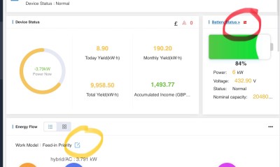

On the website go to the Inverter details page (the one that shows ‘Energy Flow’), then click on the red box in the red circle if you want normal battery charge periods, or the blue icon in the yellow circle if you want schedulerMark-Averill wrote: ↑Tue Sep 10, 2024 12:26 pm Some of you have made reference to updating the settings on the website, I have looked on the foxesscloud but can’t see anywhere to update settings, could you point me in the right direction please?

Fabulous, found that! I am prompted for a password when trying to access the scheduler… is there a standard password or will it be buried somewhere in the inverter settings menu?
Posts: 1889
In all honesty i've never known it to ask for a password when you click that but I do have an agent account so maybe it's different for users - it's got to be either your password to enter 'settings' normally '0000' or the password you log in with.Mark-Averill wrote: ↑Tue Sep 10, 2024 2:40 pm Fabulous, found that! I am prompted for a password when trying to access the scheduler… is there a standard password or will it be buried somewhere in the inverter settings menu?
That's odd. It has never asked me for a password either and I don't have an agent account!
Posts: 5
Joined: Sun May 12, 2024 8:46 am
For completeness, it was the same password as the log in password. Worked a treat, thank you

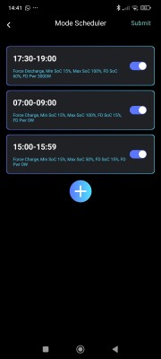

To force discharge we use mode scheduler. We set the force discharge to 60% at the moment so the battery doesn't go below that as we need that much to get us to 2 am when it's cheaper rate. I'll try add a photo. Best time to export is between 4 and 7pm You need to set fd as well. Ours is set at 3000 but we have a 6kw inverter so could be 6000its the rate it exports at. Not sure if that answers your question..you do have to click save and submit and it overrides any other settings for charging or discharging. There is a good video on it if you search...think I found on here somewhere but you do have to be careful as some of the newer products have updated features.
Posts: 3
Joined: Sat Nov 23, 2024 2:39 pm
Btw we are setup ready to charge batteries tomorrow morning as it's free between 7 and 9 am also trying out topping battery up before 4 as we are a bit low today.
