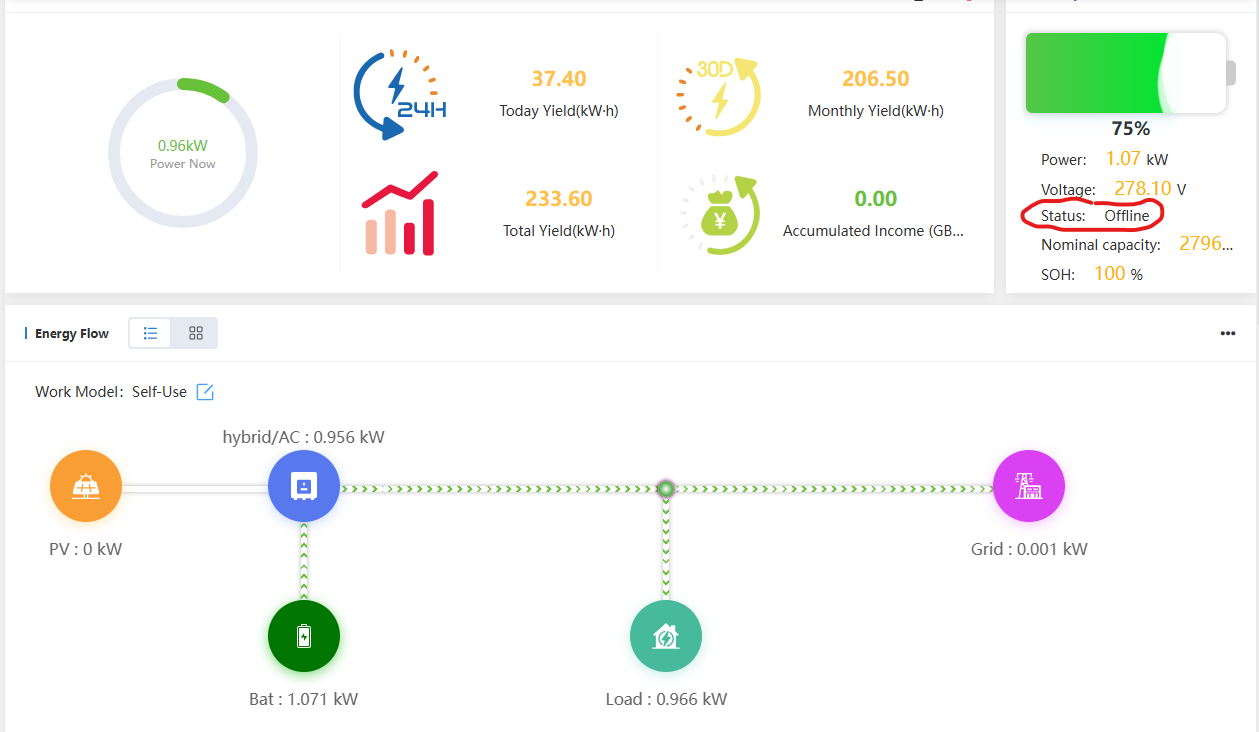

Hi All,
Bit of an odd one. System installed not too long ago.
I've noticed the battery being marked as 'offline' occasionally in the app / cloud portal, but it has typically come back to online status quickly.
Today, it has dropped to 'offline' status and is not coming back to 'online'. However, the battery is working in terms of taking charge from the inverter and discharging back to the inverter. The main issue is that I believe this 'offline' status is preventing the unit from taking mode scheduler or force charge instructions from the master inverter.
Both inverters remain in 'online' status.
Current status page from the cloud portal attached.
Any ideas?
Many thanks!

There were a number of cloud problems reported yesterday similar to this - Friday appears to be the 'doing maintenance day' on their cloud servers so hopefully all should be good again now.
