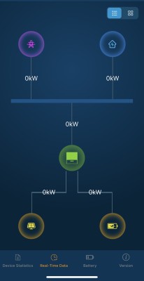

Hi ,
weve got connection and the app is showing our site
green ticks on datalogger line with 3 bars
inverter green tick also , but all values on app are zero.
have been for over 24hrs
kits working fine and inverter screen showing expected values
any ideas

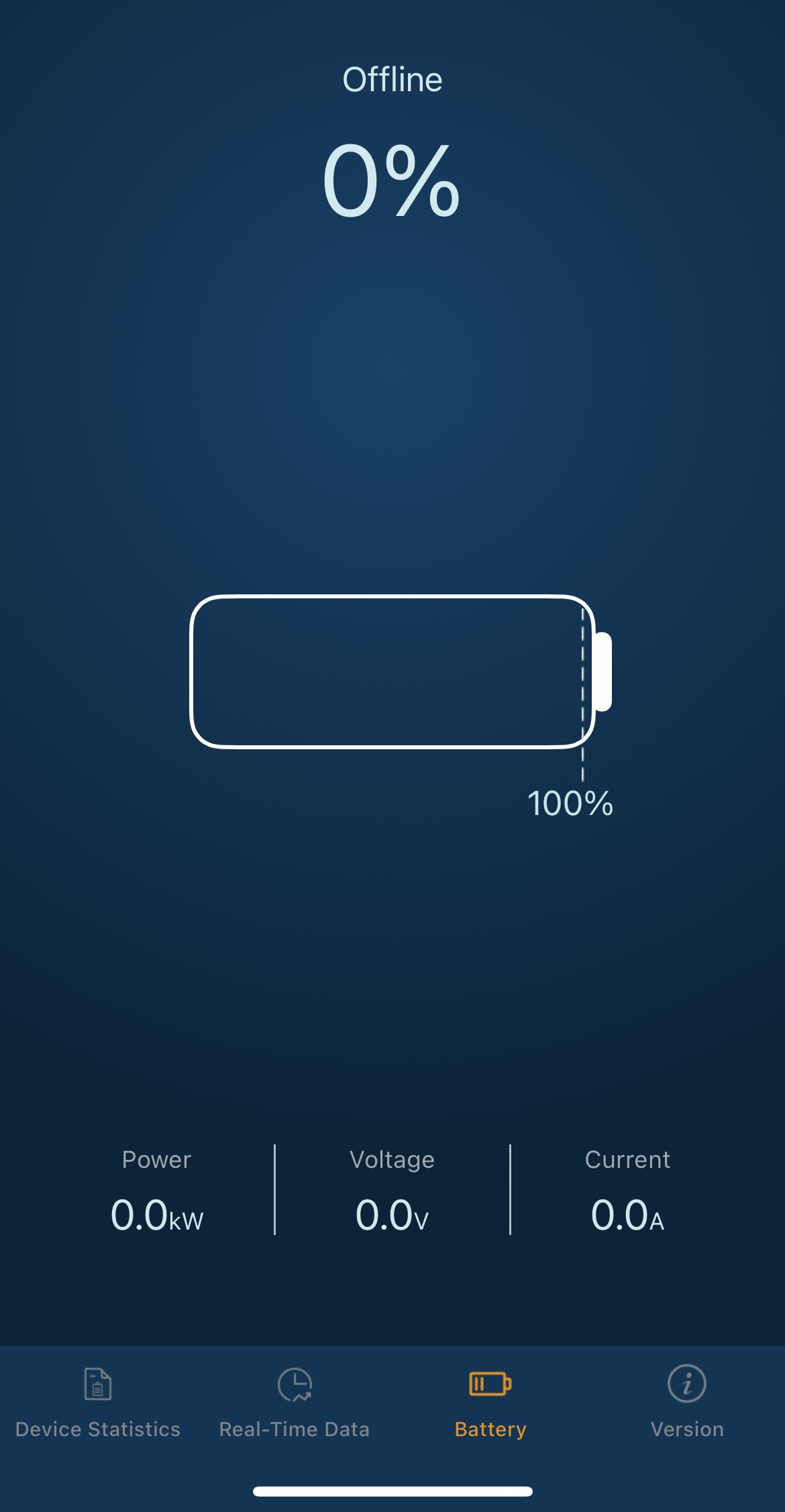

edit , was also saying battery offline on app.

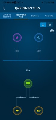

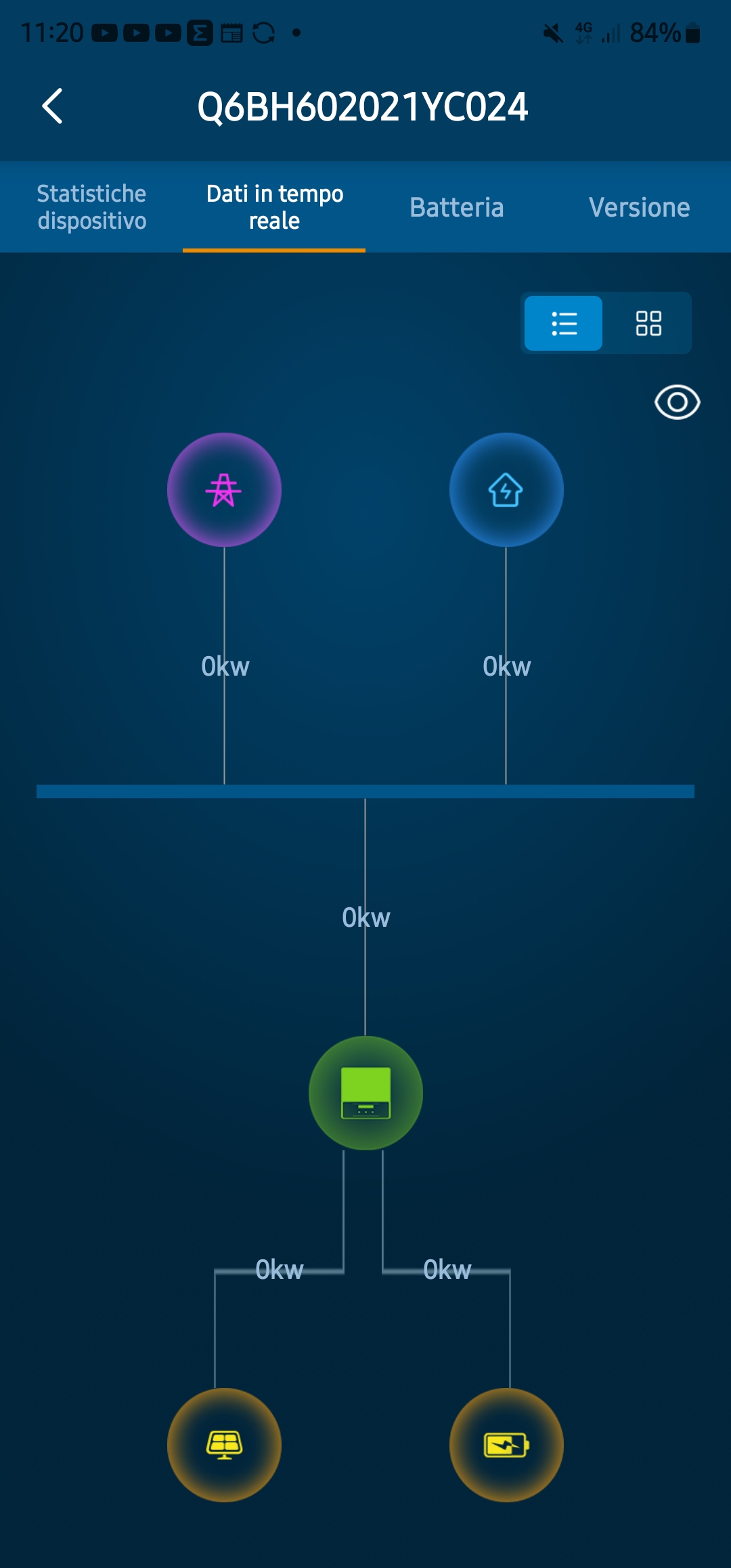

hello i just installed a fox ess inverter but i have the same problem as you wifi module correctly connected to the network, from the app all the values are 0. how should i solve it?sjc2000 wrote: ↑Tue Nov 01, 2022 12:05 pm Hi ,

I've noticed that you need to be on the latest firmware for the batteries to report correctly. make sure your firmware is up to date.

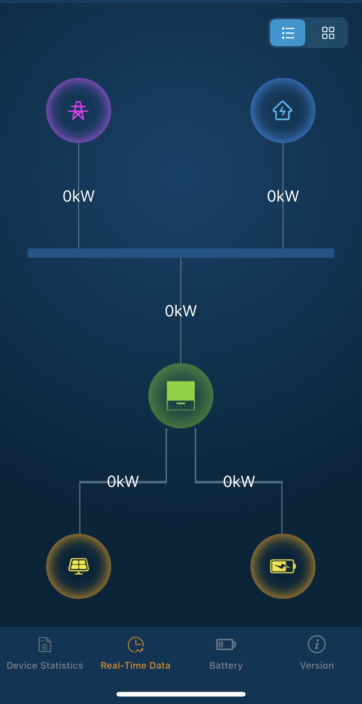

Same issue for me just started this morning. Showing 0kw across the board, and showing ‘offline’ on Real-time data and batteries. Main screen shows that I’m generating though
I’ve rebooted the entire system, checked that the wifi dongle is flashing slowly, reconnected to home wifi and resaved passwords.
Any advice would be appreciated.

I have the same issue across 3 devices with the app loaded to monitor my system. I can only assume that the app has failed at the server end. Hopefully it'll get noticed and sorted!
Looking at the online portal there is a message stating that foxess cloud is down for maintenance from 4am thismorning until 4am tomorrow, I have the same issue with app not working but everything displaying correctly on the inverter so think it will come back tomorrow.
Shame fox don't push notifications to the app advising you of things like this, that said the app is pretty terrible! A widget would be so useful so you don't have to go through the 7 odd steps just to see your data and battery!
You see the message re the server flash up briefly when you try to log in. I did note that the server down time period times were from 2022!!! I hope that was just a cut-n-paste issue.

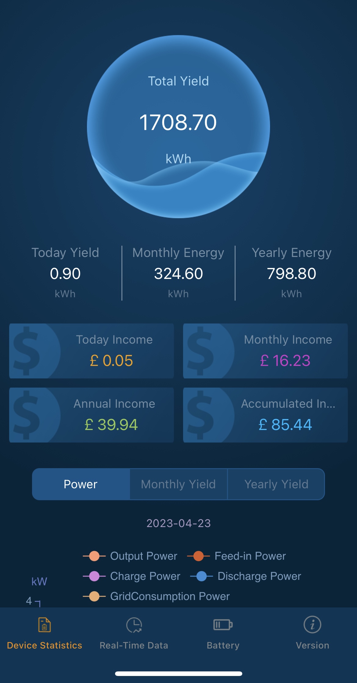

I had the same system update message yesterday. App seems to be working fine now but all historic data is missing. Any advice please?
From https://www.foxesscloud.com/login the message reads
I read this as saying the historical data will be available again after 6th May.
For data before April 23, 2023, access is temporarily closed for power generation data backup, and it will return to normal after the backup ends at 00:00:00 (UTC +0) on May 6, 2023
