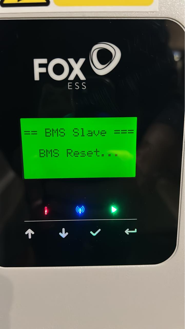

My system has was installed a little over a month ago. My Firmware was updated on Tuesday 19th Nov to the same at JimH's above. I have the same Inverter but a different battery model and datalogger FW version.
H1-5.0-E-G2 - Master : 1.29 Slave : 1.02 Manager : 1.44
Batteries - EP5 - BMS : 1.003
Datalogger - W4 - 4.12
I have had problems ever since the firmware update. Has anyone else has problems or similar problems to the below?
During the past 3 nights (the start time is not consistent) since the update the battery has started charging from the grid to 60% and stopping at 60% each night. During that time the power in the battery has not been used to supply my house, until up to 12 hours after the battery initially started charging from the grid. For example, on 19th Nov the battery started charging from the grid at 21:00 and it wasn't until 09:03 on 20th that power from the battery was powering my house again. During that time the battery level was maintained at 60% and the load was being supplied from the grid.
There are no force grid charging settings and no active mode scheduler operations set to account for this charging from the grid. To me it appears to be a problem with the firmware as it was not doing this when I was on inverter firmware Master : 1.18 Slave : 1.02 Manager : 1.28 prior to the 19th Nov.
Fox are investigating this currently but I was wondering if anyone had encountered this before and had any recommendations on what might be causing this, remedies?

I've found that a full system shutdown and restart (including batteries) can help/sometimes be necessary after a G2 inverter firmware update - have you tried that?Jordan wrote: ↑Fri Nov 22, 2024 11:06 am Hi
Jim
Hi Jim
Thanks for the reply, I've not tried that, I'm fairly new owner of one of these systems. Is that just a simple... find the power isolator for the system and turn it to the off position and then back to the on position?
Jordan

I have a H1-5.0-E-G2 and 5x ECS2900 V1 battery cubes.
It has happily been running reliably on the following versions for many months:
Manager : 1.44
Master : 1.27
Slave : 1.02
But I want to take advantage of the new meter compensation feature, so asked Fox support to upgrade the firmware. To their credit they did with 24 hours, and now I have:
Manager: 1.49
Master: 1.33
Slave: 1.02
In the same request I asked for the ECS V1 firmware versions to be upgraded, as they are not all the same, but this hasn't been done. So I my ECS V1 stack currently looks like:
Master: 1.017
4x ECS: 1.12
1x ECS: 1.09
This didn't cause any issues under the older firmware (1.44).
However I now have a problem: after a few hours, the inverter restarts itself, and then the display locks up - displaying the following message, and the front panel buttons are unresponsive.
I can find no reference to this error anywhere online.
However.. the inverter continues to operate, the battery works fine, Modbus works, and there are is no error states logged either in HA or in the cloud. If I hadn't looked at the inverter screen I'd not have known anything was wrong. A full shutdown/restart sequence gets the screen up and working again, but a few hours later I find the issue recurs.
I'm not sure whether the battery firmware inconsistency is now an issue, or some other incompatibility has arisen. I've emailed Fox support, but currently no response from them. So I'm posting this as a warning to anyone else considering an upgrade to Manager 1.49, and to see if there's any advice.
Manager : 1.44
Master : 1.27
Slave : 1.02
Manager: 1.49
Master: 1.33
Slave: 1.02
Master: 1.017
4x ECS: 1.12
1x ECS: 1.09
Code: Select all
== BMS Slave ===
BMS Reset...However.. the inverter continues to operate, the battery works fine, Modbus works, and there are is no error states logged either in HA or in the cloud. If I hadn't looked at the inverter screen I'd not have known anything was wrong. A full shutdown/restart sequence gets the screen up and working again, but a few hours later I find the issue recurs.

The later versions of BMS / Slave firmware have made quite a few changes and it doesn’t surprise me that you are getting errors with inconsistent slave firmware - the battery firmware upgrade must have failed to push out to the final battery so whilst waiting for Fox to get back to you check that any rotary dip switches are set to the correct number of batteries i.e. it should be ‘4’ for 6 batts (=numbatts-2), if it is incorrect reset it and restart the battery (power off and power back on again). Once all batteries are updated by Fox the error should disappear.
Thanks Dave. DIP switch is correct for the stack (5 modules = 3). Fox responded to my further request to harmonise the battery firmwares with “This has to be updated from the site as the remote update is not going through”. So I’m not sure what to do now, other than try the installer who installed the extra slave (the one on 1.09) for me.
The good news is that after a further reboot and starting system in the correct order (inverter, then batteries) the error has not recurred for over 24 hours. Now, in the world of real-time control systems I know this counts for little but is better than before.
