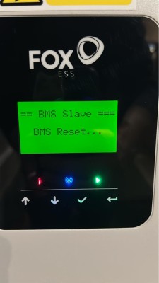

Thanks Jim, I've followed that video and have shutdown and restarted my system. Hopefully my issue won't occur tonight. Jordan
A quick update on my issue...
The full system shutdown and restart resolved the grid charging to 60% issue.
The power in the battery not being used to supply my house part of the issue was due to a software problem with the battery. By the inverters being on the most up to date firmware and the batteries being on this incorrect firmware, it was causing the batteries to appear to be in an idle state and neither charging or discharging. Fox say the issue is now resolved.
Over the past 48 hours everything seems to be working normally.
Just the “PV input clipped to 0 when battery reaches 100% SoC during a mode scheduler force charge period” bug to be sorted then - still waiting for newer firmware for that……

I have a H1-5.0-E-G2 and 5x ECS2900 V1 battery cubes.
It has happily been running reliably on the following versions for many months:
Manager : 1.44
Master : 1.27
Slave : 1.02
But I want to take advantage of the new meter compensation feature, so asked Fox support to upgrade the firmware. To their credit they did with 24 hours, and now I have:
Manager: 1.49
Master: 1.33
Slave: 1.02
In the same request I asked for the ECS V1 firmware versions to be upgraded, as they are not all the same, but this hasn't been done. So I my ECS V1 stack currently looks like:
Master: 1.017
4x ECS: 1.12
1x ECS: 1.09
This didn't cause any issues under the older firmware (1.44).
However I now have a problem: after a few hours, the inverter restarts itself, and then the display locks up - displaying the following message, and the front panel buttons are unresponsive.
I can find no reference to this error anywhere online.
However.. the inverter continues to operate, the battery works fine, Modbus works, and there are is no error states logged either in HA or in the cloud. If I hadn't looked at the inverter screen I'd not have known anything was wrong. A full shutdown/restart sequence gets the screen up and working again, but a few hours later I find the issue recurs.
I'm not sure whether the battery firmware inconsistency is now an issue, or some other incompatibility has arisen. I've emailed Fox support, but currently no response from them. So I'm posting this as a warning to anyone else considering an upgrade to Manager 1.49, and to see if there's any advice.
Manager : 1.44
Master : 1.27
Slave : 1.02
Manager: 1.49
Master: 1.33
Slave: 1.02
Master: 1.017
4x ECS: 1.12
1x ECS: 1.09
Code: Select all
== BMS Slave ===
BMS Reset...However.. the inverter continues to operate, the battery works fine, Modbus works, and there are is no error states logged either in HA or in the cloud. If I hadn't looked at the inverter screen I'd not have known anything was wrong. A full shutdown/restart sequence gets the screen up and working again, but a few hours later I find the issue recurs.

The later versions of BMS / Slave firmware have made quite a few changes and it doesn’t surprise me that you are getting errors with inconsistent slave firmware - the battery firmware upgrade must have failed to push out to the final battery so whilst waiting for Fox to get back to you check that any rotary dip switches are set to the correct number of batteries i.e. it should be ‘4’ for 6 batts (=numbatts-2), if it is incorrect reset it and restart the battery (power off and power back on again). Once all batteries are updated by Fox the error should disappear.
Thanks Dave. DIP switch is correct for the stack (5 modules = 3). Fox responded to my further request to harmonise the battery firmwares with “This has to be updated from the site as the remote update is not going through”. So I’m not sure what to do now, other than try the installer who installed the extra slave (the one on 1.09) for me.
The good news is that after a further reboot and starting system in the correct order (inverter, then batteries) the error has not recurred for over 24 hours. Now, in the world of real-time control systems I know this counts for little but is better than before.
