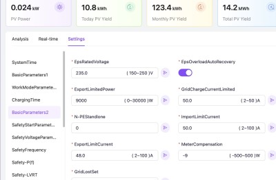

Upgrade to v1.43 of manager and latest on slave and master and you'll be fine. Once updated you will need your installer or fox to set a negative number in the meter compensation box. I'd recommend -25 as a starting point
Fab. Thanks Will for the quick reply.
James S.
James S.

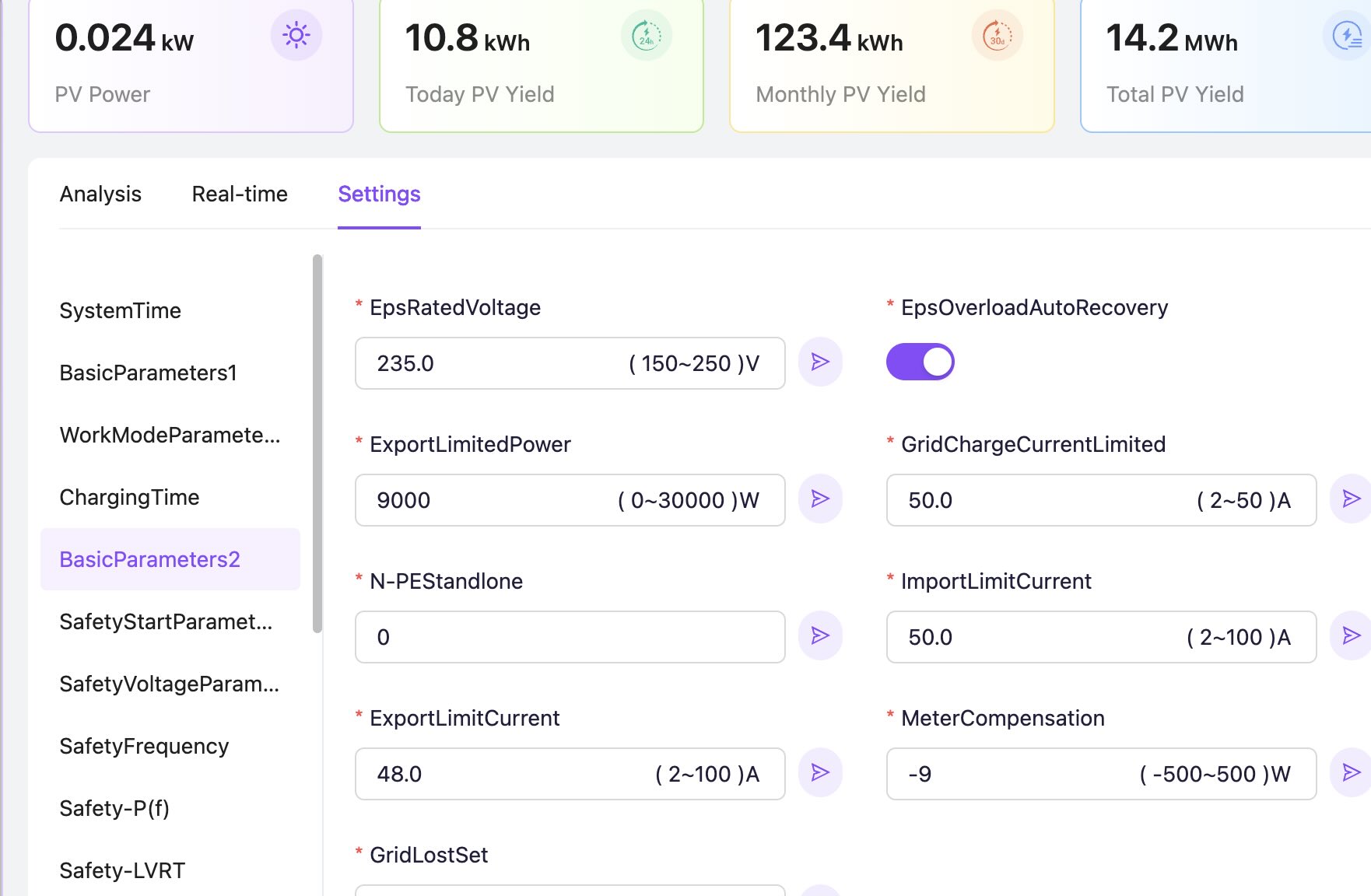

Actually, with Fox Cloud v2 you can set this yourself. Hmm, let's see if I can find it now...
On the web go to: https://www.foxesscloud.com/v2/login
Login with your usual Fox Cloud / App username and password.
Click on DEVICES, then on your Inverter.
Click on SETTINGS
BasicParameters2
MeterCompensation
Set what you want then click the right arrow button to the right of it
