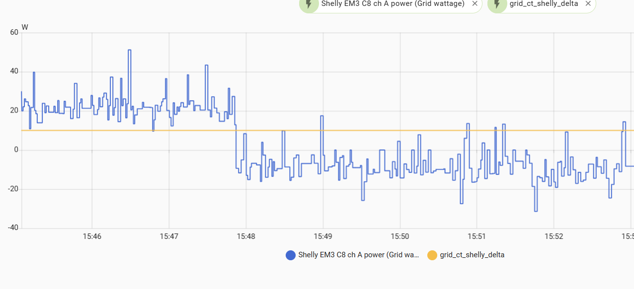

Here's what the meter compensation setting will look like - inverter's sensor.grid_ct figure compared to a Shelly CT. -30 set at 15:47:50. The inverter CT still registers +10W import, but the system is actually now exporting a small amount rather than importing a small amount. Of course it is the smart meter itself which is the most important measurement, and it is now hovering between 0 and 10W export, rather than importing about 20W.

Note that the app will not show a change in import/export - it is the calibration of the CT clamp which is being deliberately biased, so when the inverter thinks you are importing 10W, it will actually be exporting 20W. So you need to see what the smart meter is registering (first check before asking, so that you know the 'before' figure). Once the change takes place, the smart meter should now be seeing the export, but the app will be seeing import.
