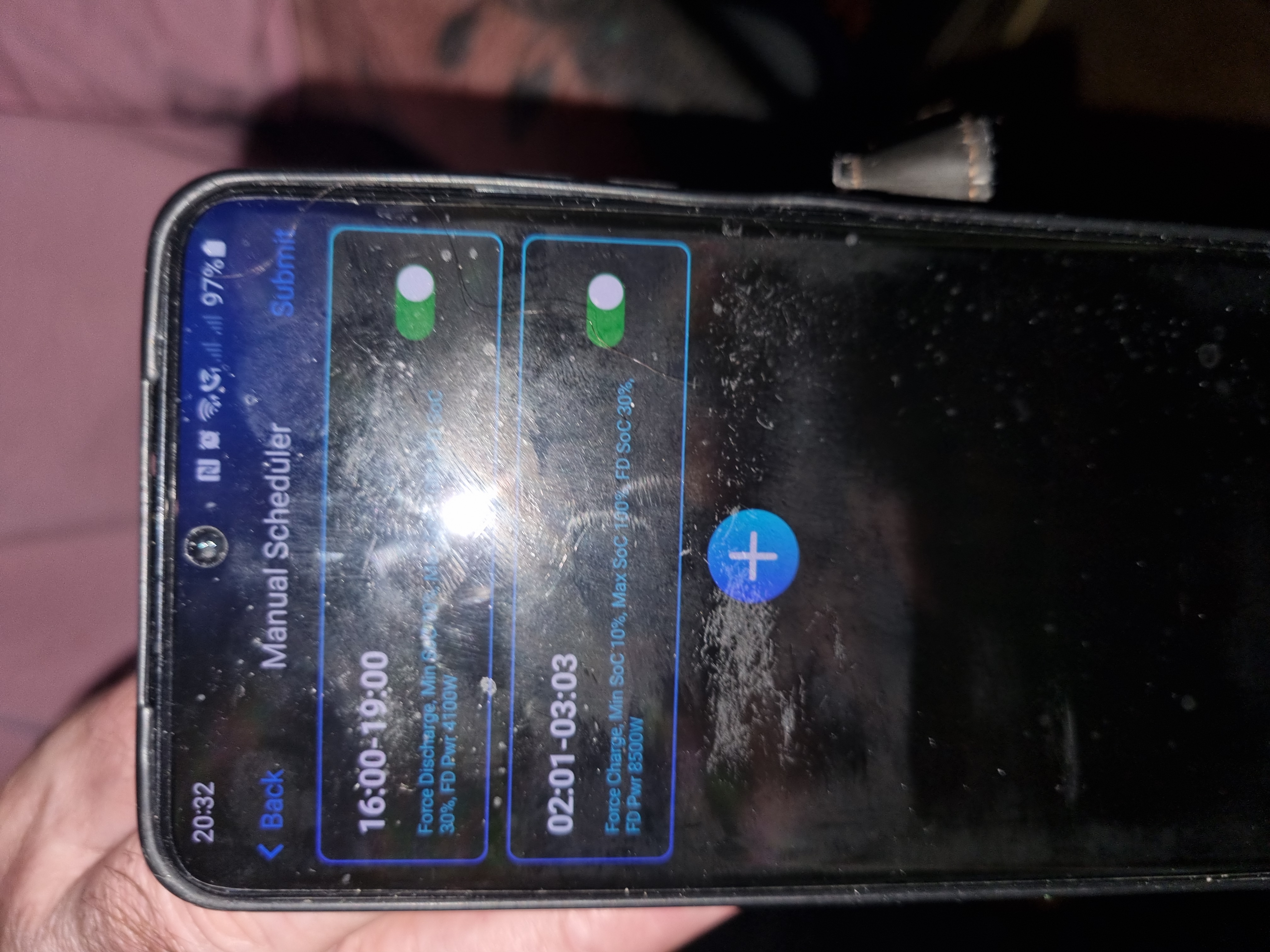

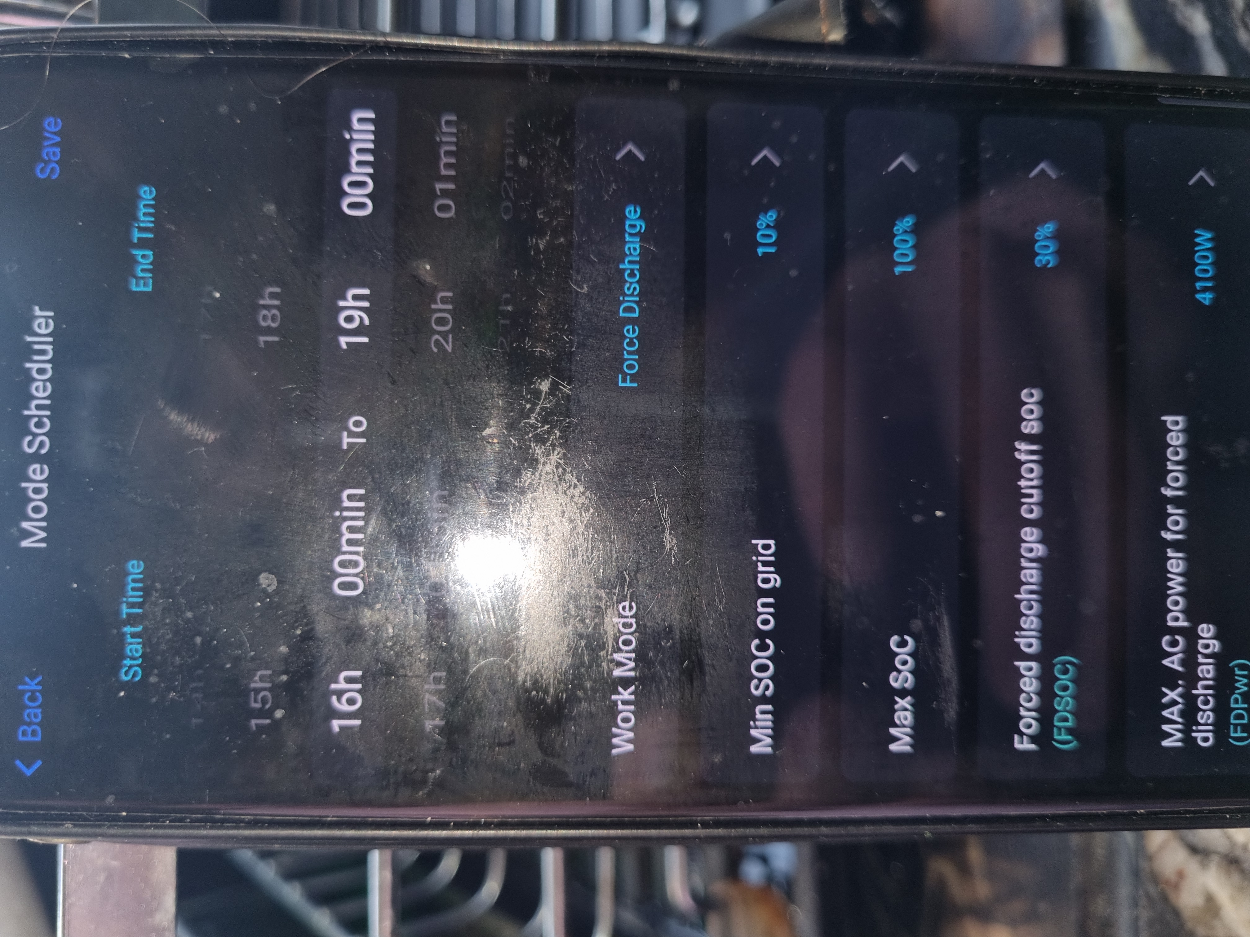

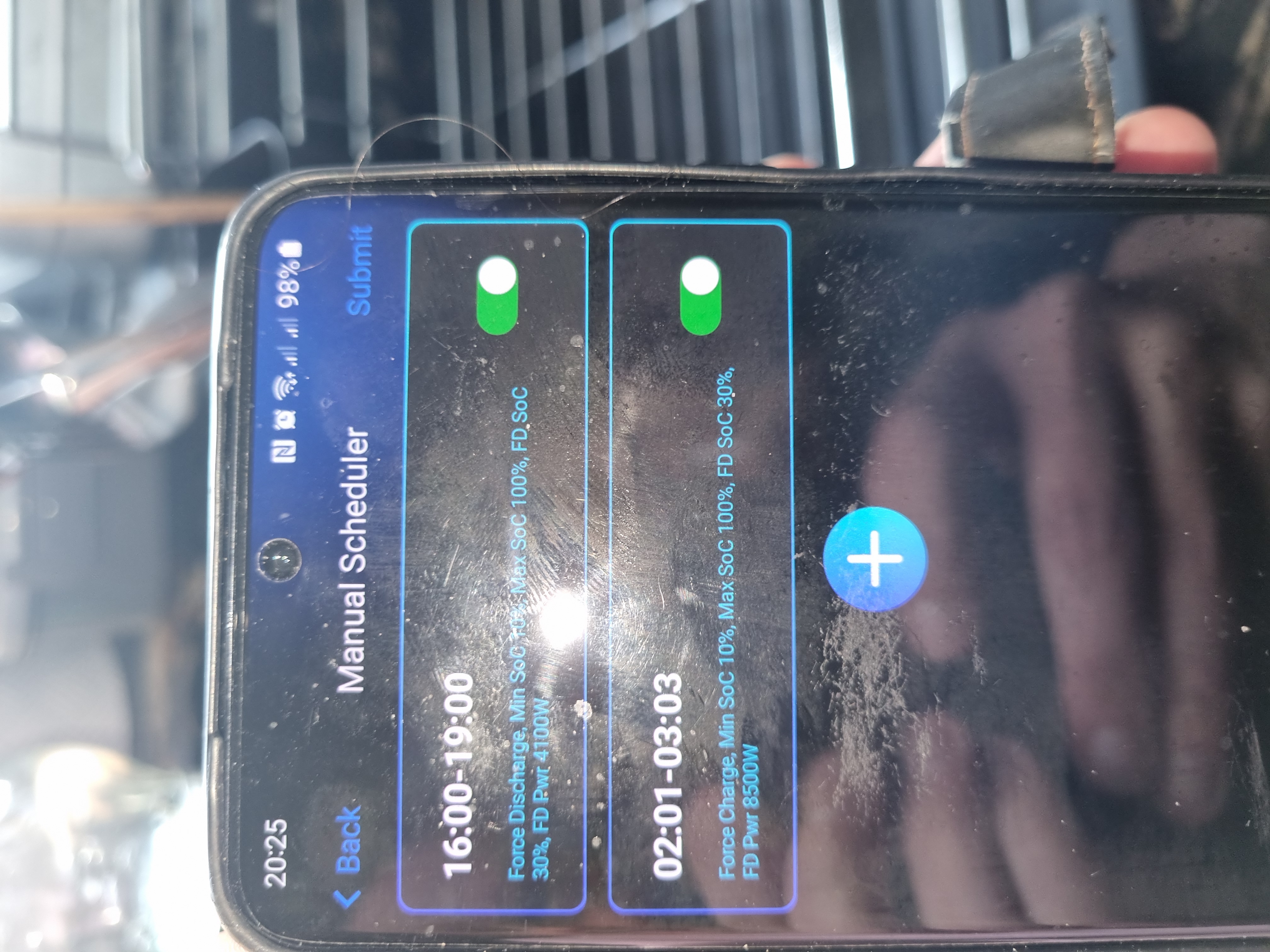

Here are the settings on my fox app for export.
I save then submit then return on each one.
I will film the inverters tommorow when there exporting
I noticed today the slave batteries are charging from the Master/Slave inverter when the exporting stops?

So you're instructing your inverter to output 4.1kW, remember that this includes house loads so if you house used 2kW you would only be exporting 2kW in this 4kW example.
Can you share any details of where you think the problem is and why you believe there to be a problem?
Re: Help octopus Flux export
Hi Wil
The inverters are only set at 4.1kwI had them on 4kw for export
8.5kw for import
