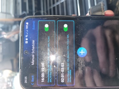

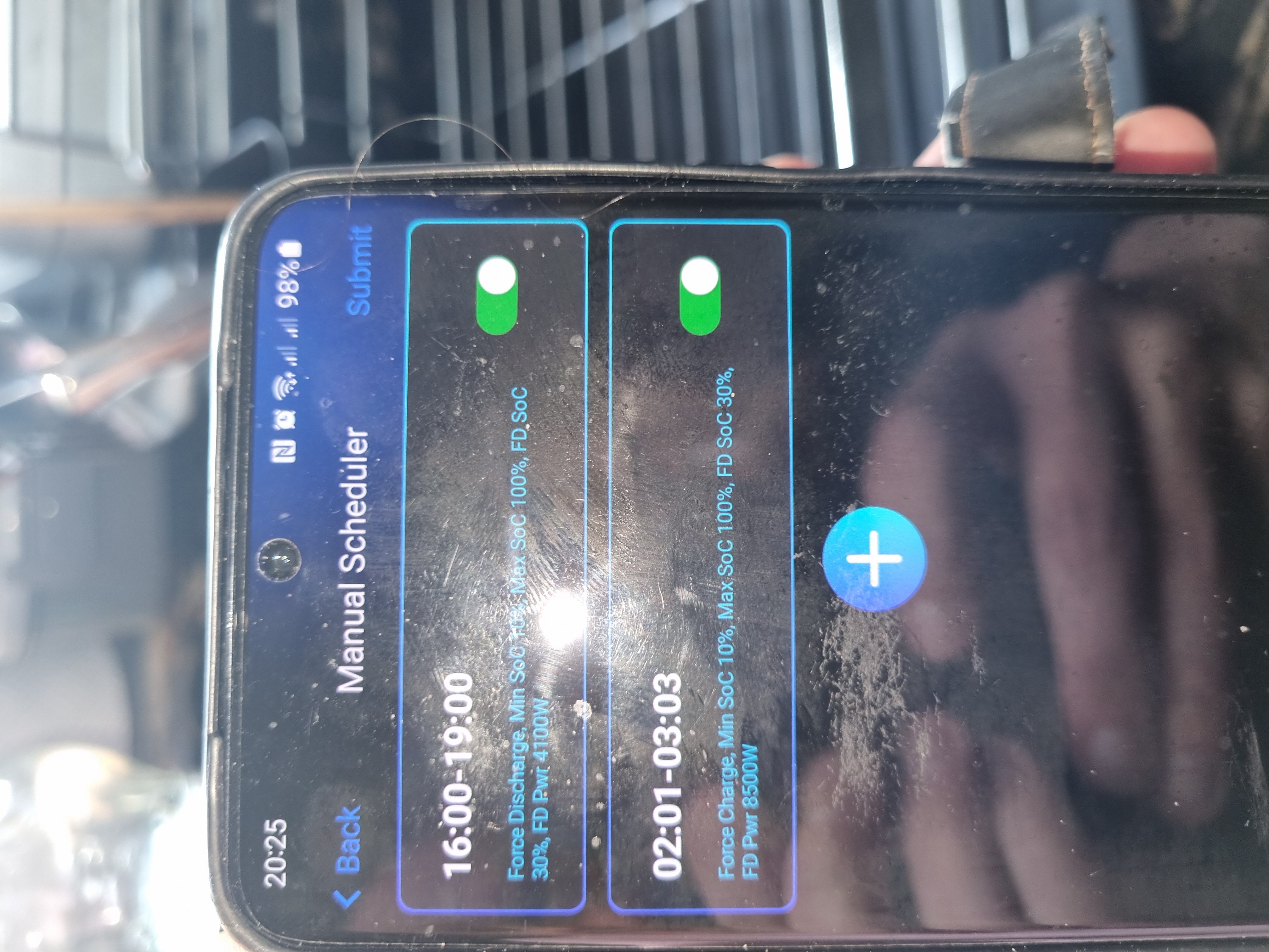

Can you post a video or photos of what the inverter screen is doing during the export and a screenshot of your export setting configured in the mode scheduler.
Hi Will

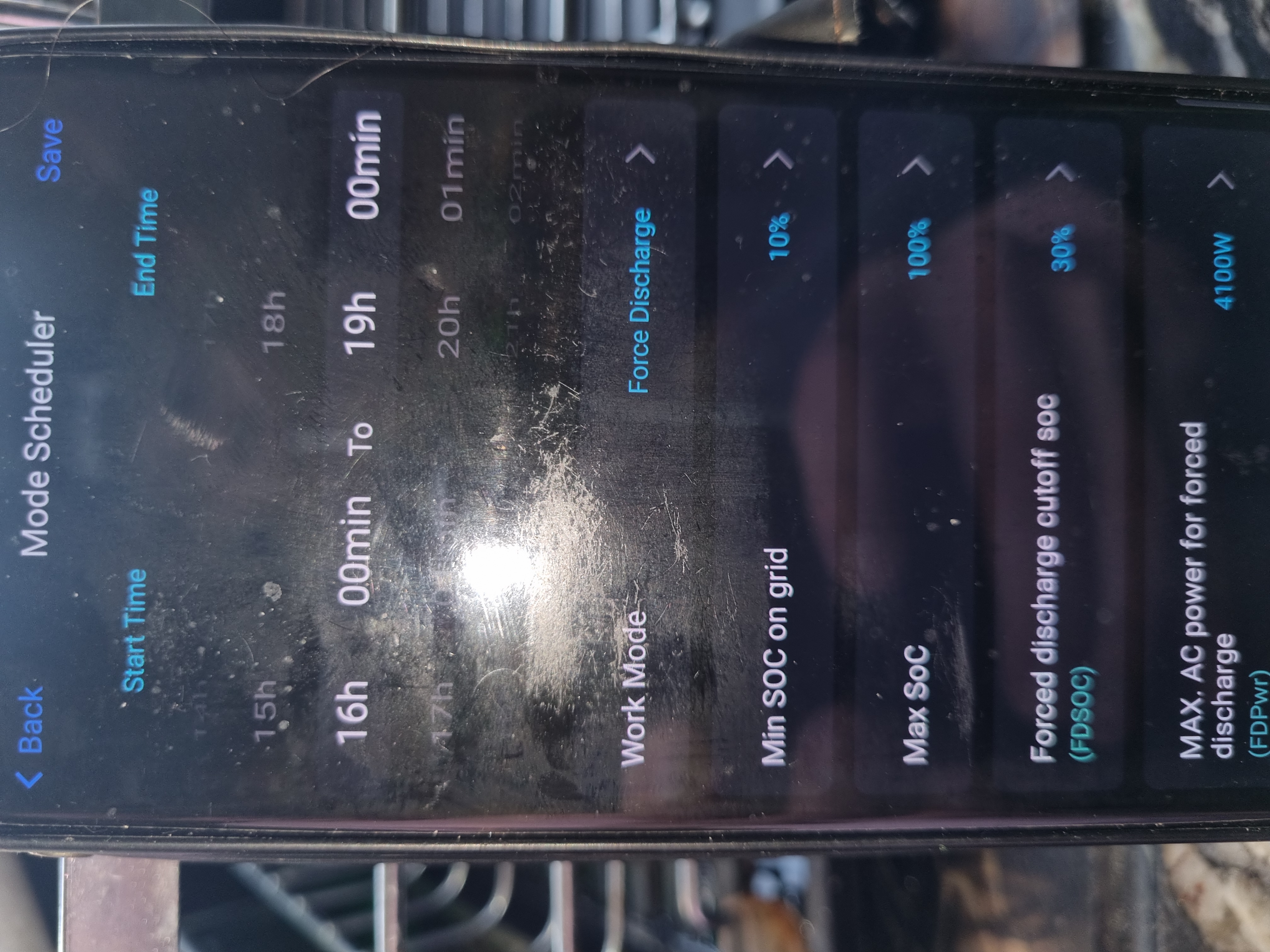

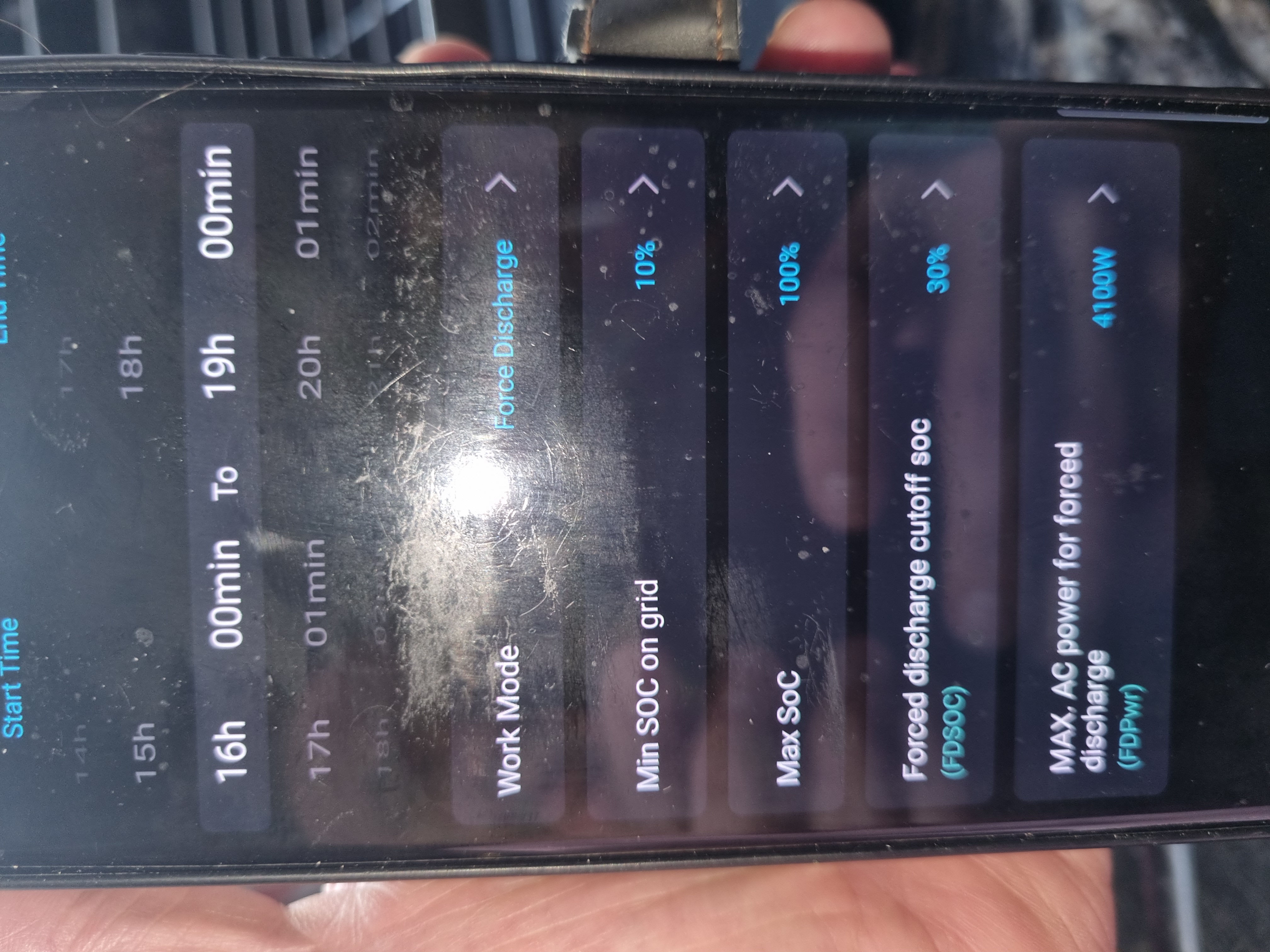

Here are the settings on my fox app for export.
I save then submit then return on each one.
I will film the inverters tommorow when there exporting

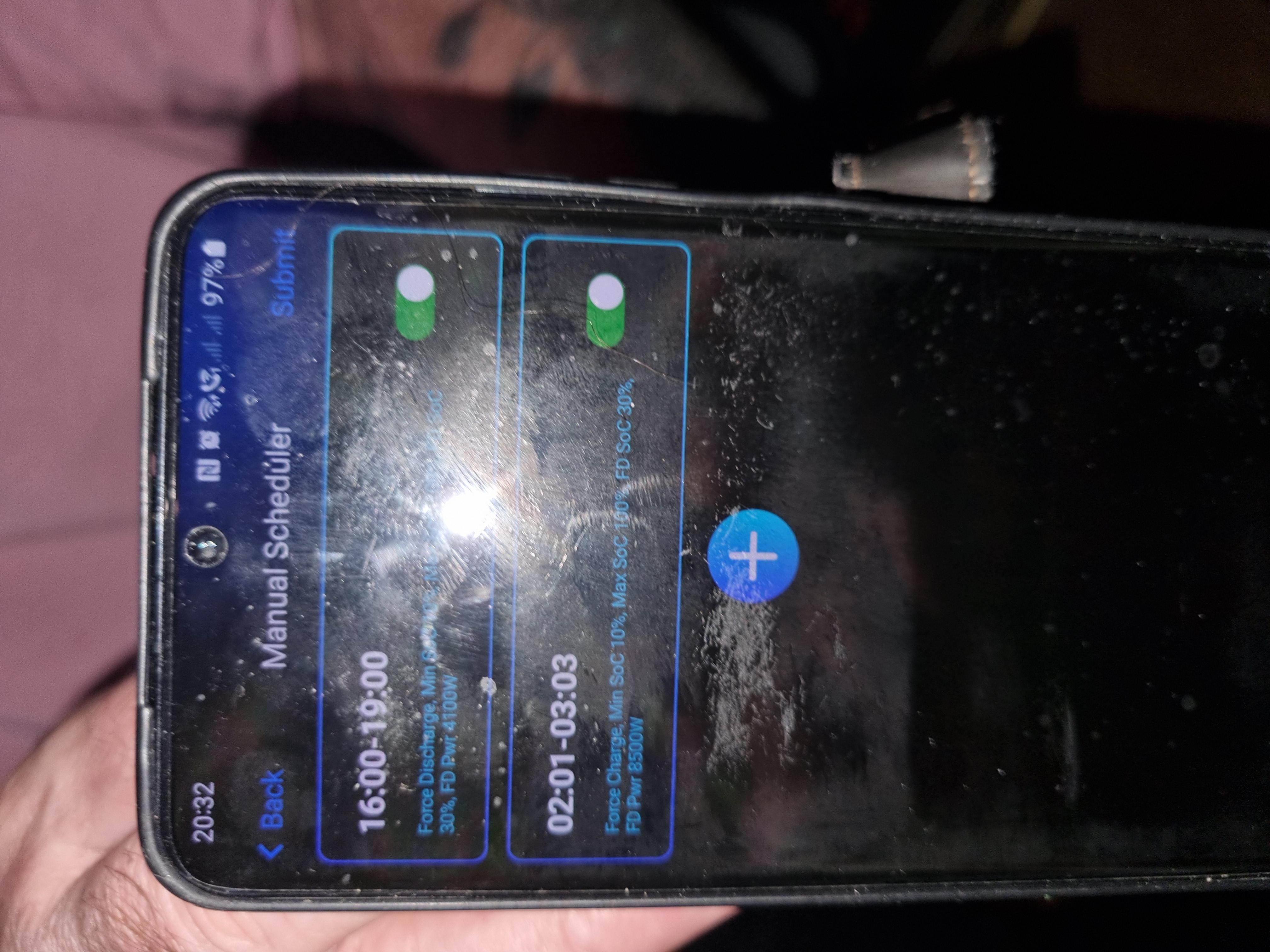

I noticed today the slave batteries are charging from the Master/Slave inverter when the exporting stops?
So you're instructing your inverter to output 4.1kW, remember that this includes house loads so if you house used 2kW you would only be exporting 2kW in this 4kW example.
