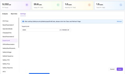

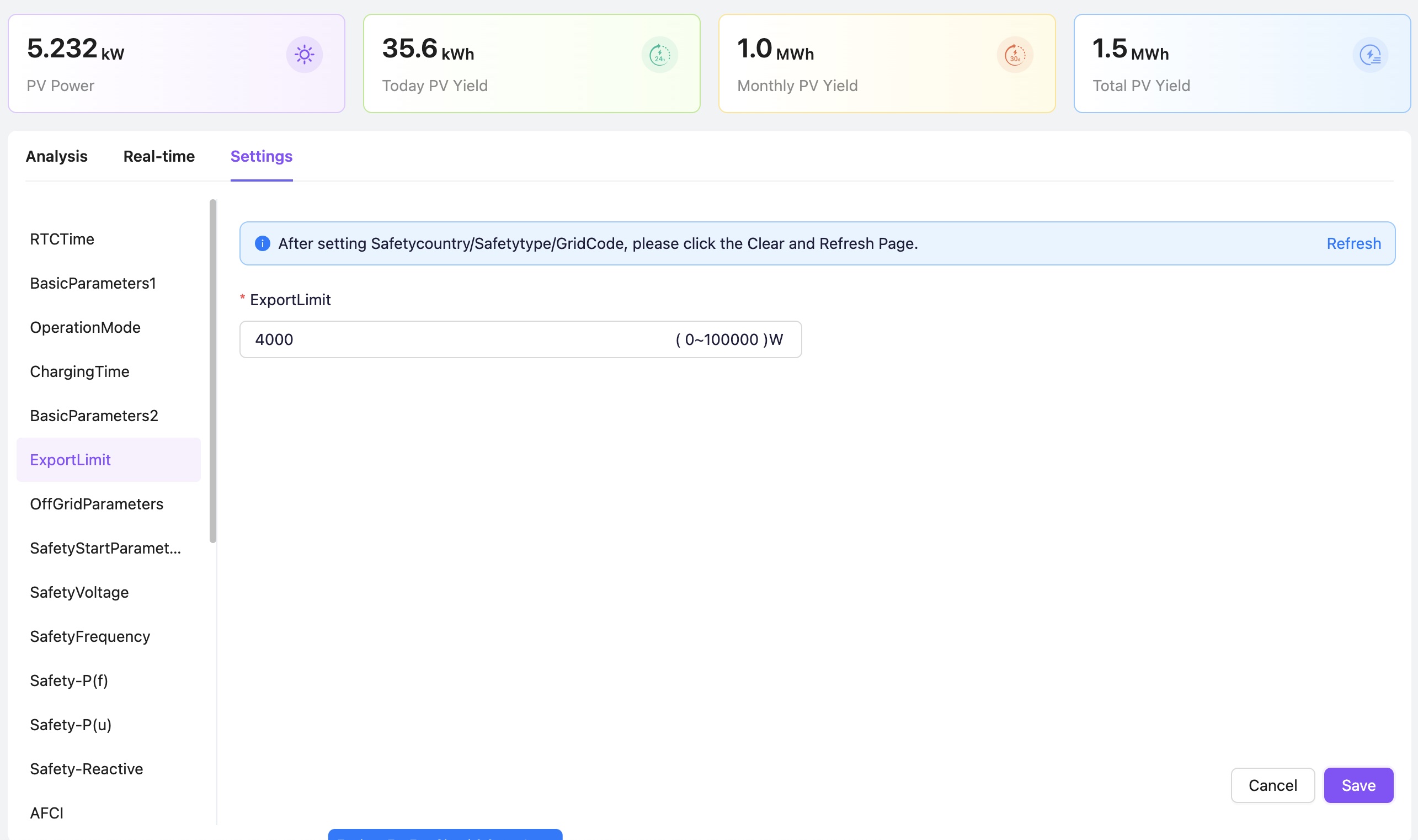

Via https://www.foxesscloud.com/v2/plants/plant you can configure settings on the inverter:
Oh the beta platform, they've not yet locked it down then
good find
I do hope that in the beta-platform users can do basic settings. As I said, my installer took now 5 days to respond to provide a setting change. This makes it impossible as an enduser to operate the device. I do not want full control, but i should be able to set export/import limits. (FWIW: My installer decided in the Peakshaving config to setup a 40000W import limit without notifying me - something I just found in the beta settings, otherwise I would have happily imported electricity).
