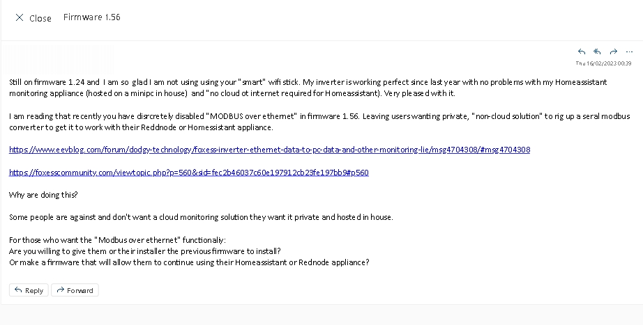

A few days ago in that thread, user posted about his widget he was making for his Foxess inverter and that he got locked out after an update. I was trying to help but it turns out he had the "smart wifi stick" installed and it updated to firmware 1.56 which I found the news about it here.
This is why I am skeptical of any update and especially without knowing what it is going to do.
My H1/AC1 inverter firmware is 1.28 connected to directly to minipc via a usb network card running a Homeassistant appliance since last year. I disabled the update on there too so it is left alone and despite a few issues at first it continues to datalog and with UPS power supply and so far so good. Very pleased with.

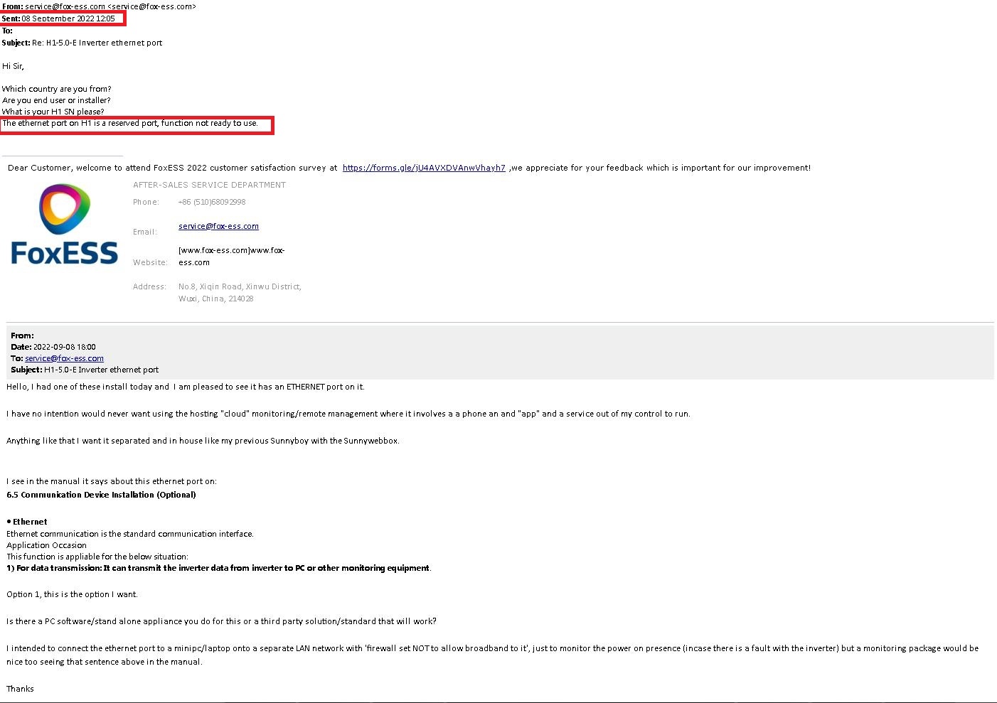

2) For monitoring: It can transmit the inverter data from inverter to Foxess monitoring website/APP :bullshit: though home router connected.
See the lie?From: service@fox-ess.com <service@fox-ess.com>
Sent: 08 September 2022 12:05
To: Subject: Re: H1-5.0-E Inverter ethernet port
Hi Sir,
Which country are you from?
Are you end user or installer?
What is your H1 SN please?
The ethernet port on H1 is a reserved port :, function not ready to use.

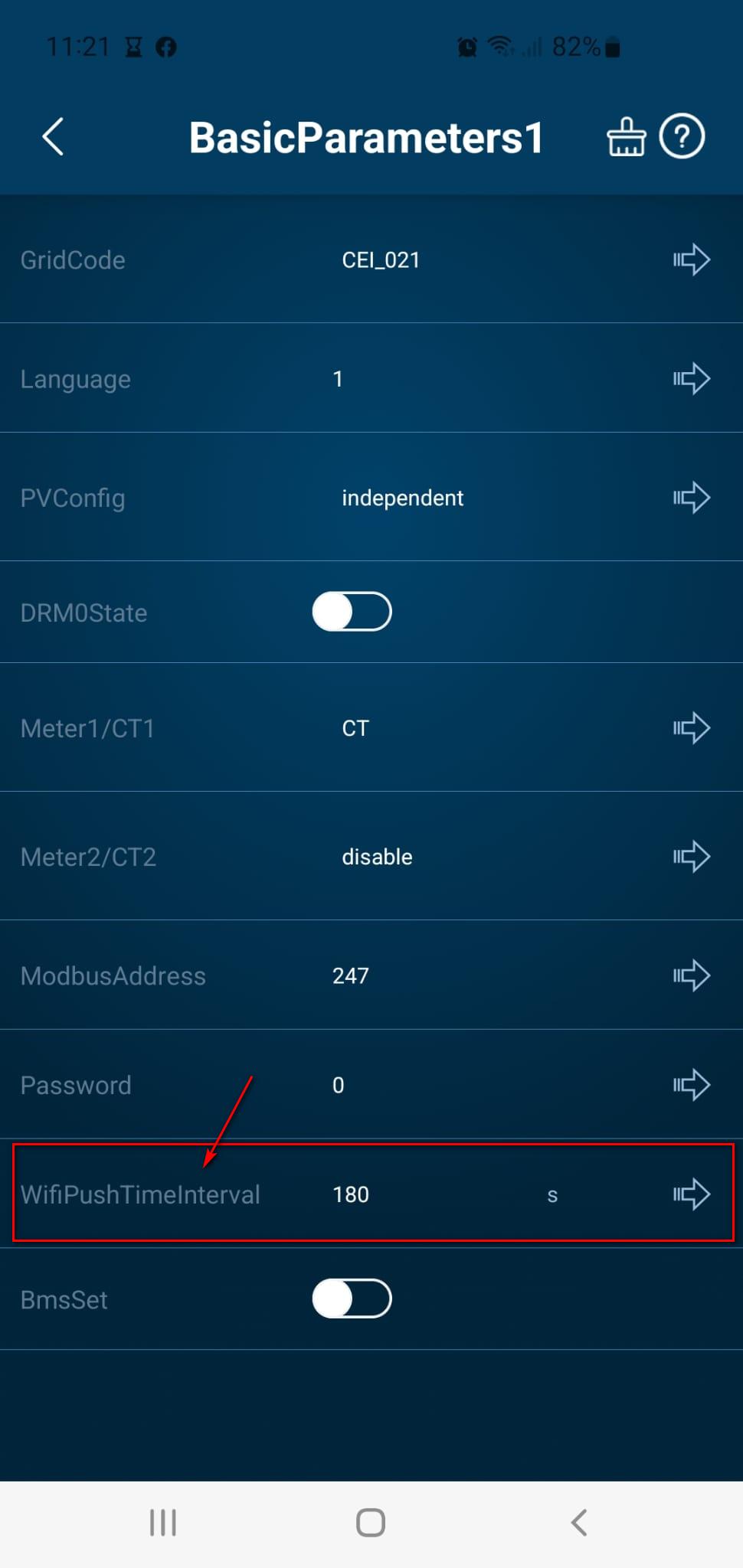

On the installation day of my H1 inverter this was the menu from the app:
You see the WifiPushTimeInterval menu item (default 180 sec.).

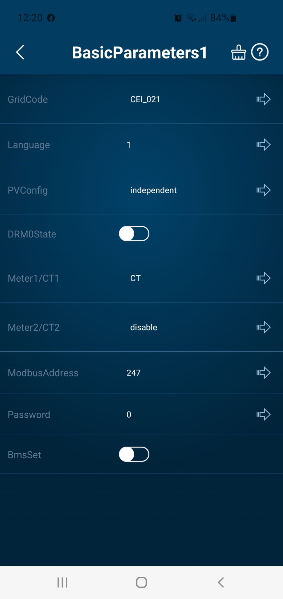

The next day, the menu looked like this:
The menu item has disappeared.
I don't know the firmware version on day one.
But the modbus tcp worked!
This stopped working 3 weeks later.
Now I have Manager ver.1.56

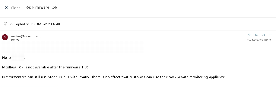

I have got a reply from Fox-ess regarding the above:
Good, they recommend it.
Thank you Fox-ess.
Great answer. That one sounds much more sensible to me compared to the first one last year.
I am pleased that they are now giving us a choice with a means to do it recommended by themselves.
I would have brought the part had I been advised instead of "smart wifi stick" being the only means.
Just need to buy that converter, wire it up to plug, test and prepare my installation for quick switch over if the inverter is replaced in future.
I forgot to mention that before the contract and before the inverters were changed to just one, in regards to the serial port where the dongle goes, the contactor said something about, that if I connect up stuff not approved by the manufacturer and it goes wrong and they find it, it could void the warranty.
Now I have got their backing and no longer in the dark.
"Modbus RTU with RS485"service@fox-ess.com
You
Hello *****,
Modbus TCP is not available after the firmware 1.50.
But customers can still use Modbus RTU with RS485 :-+ . *There is no effect that customer can use their own private monitoring appliance.
