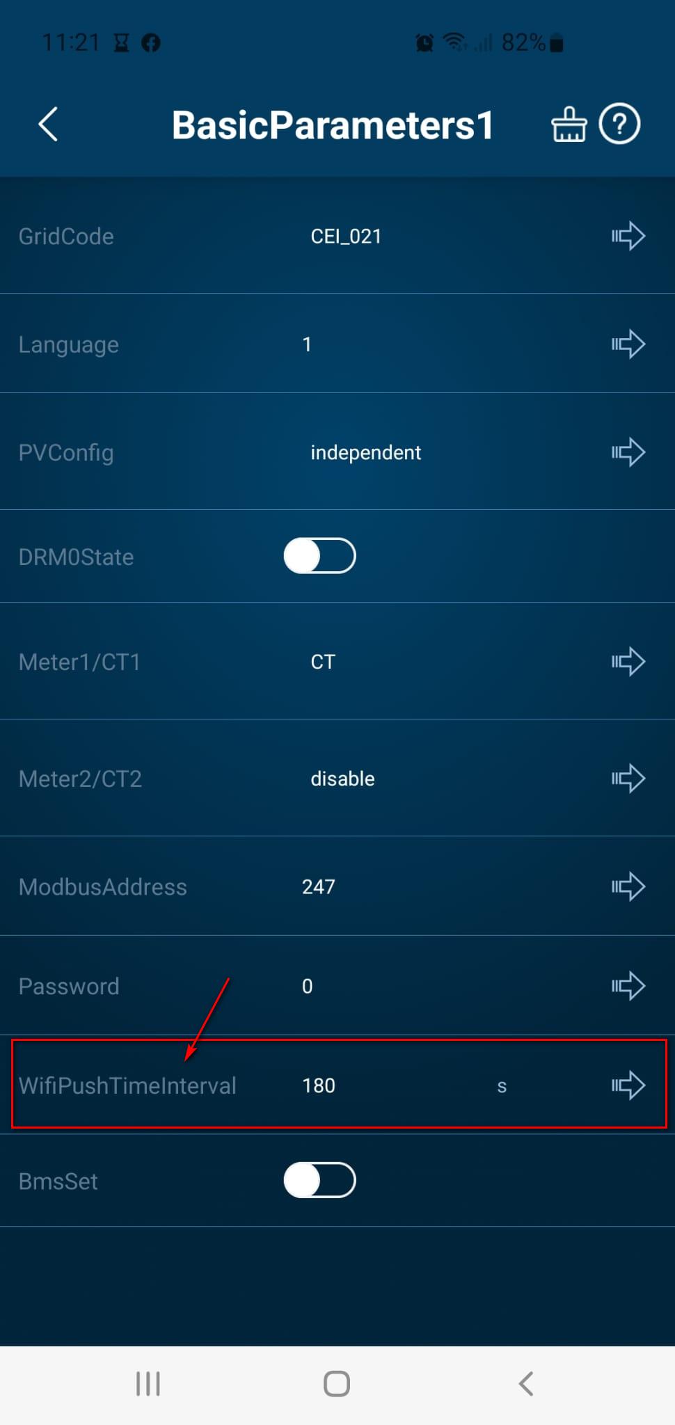

On the installation day of my H1 inverter this was the menu from the app:
You see the WifiPushTimeInterval menu item (default 180 sec.).
The next day, the menu looked like this:
The menu item has disappeared.
I don't know the firmware version on day one.
But the modbus tcp worked!
This stopped working 3 weeks later.
Now I have Manager ver.1.56
