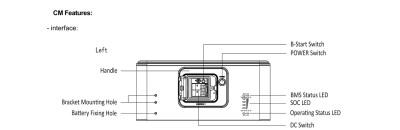

Thanks - it's the "turn the batteries off" bit thats got me stumped - I've watched a YouTube video about switching off DC then switching off AC and then switching off battery.... but mine look nothing like the video, can't seem to identify where the off button is ! It's not the sodding great silver thing on the front is it ?
- Posts: 1786
You've probably watched the power off and reset the inverter which is a much longer process, you need to be looking at your battery master (the top one), there is a power button and a breaker like DC switch which is the isolator like this image (click on it to zoom)IanHx wrote: Tue Sep 03, 2024 10:33 pm Thanks - it's the "turn the batteries off" bit thats got me stumped - I've watched a YouTube video about switching off DC then switching off AC and then switching off battery.... but mine look nothing like the video, can't seem to identify where the off button is ! It's not the sodding great silver thing on the front is it ?
