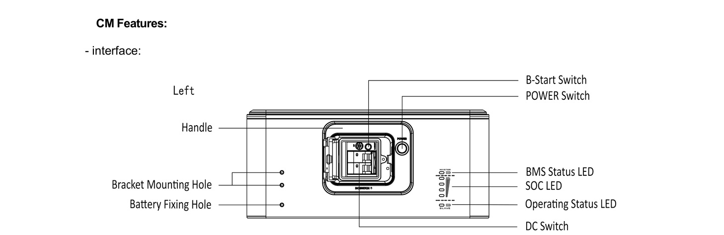

You've probably watched the power off and reset the inverter which is a much longer process, you need to be looking at your battery master (the top one), there is a power button and a breaker like DC switch which is the isolator like this image (click on it to zoom)

Installer has been round. Now know about the isolator switch :)
