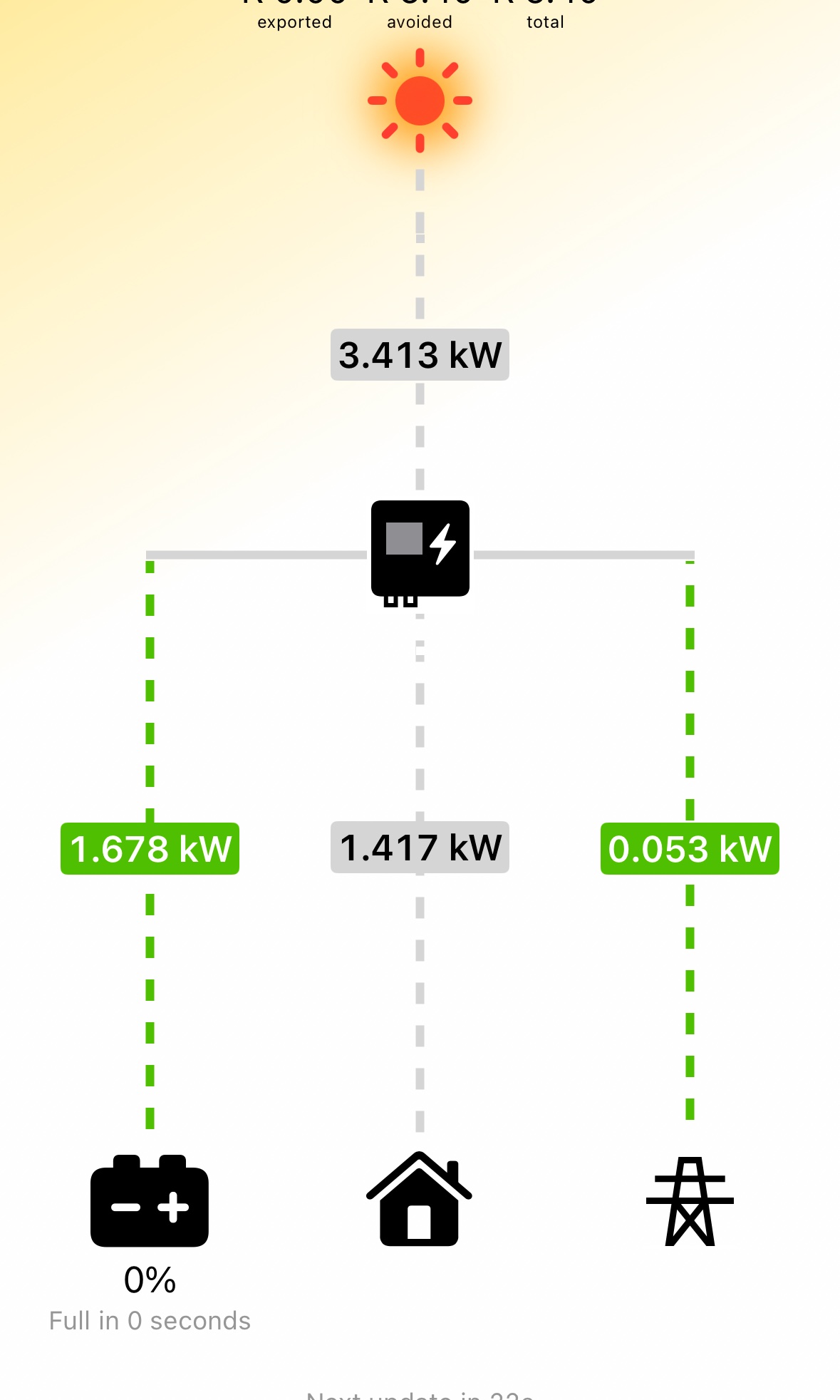

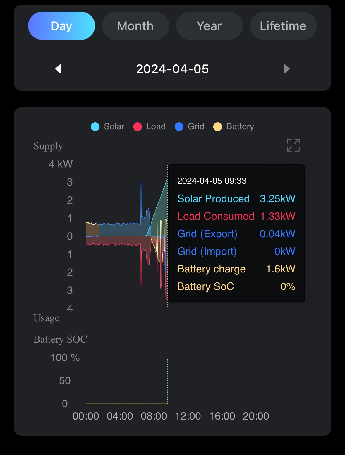

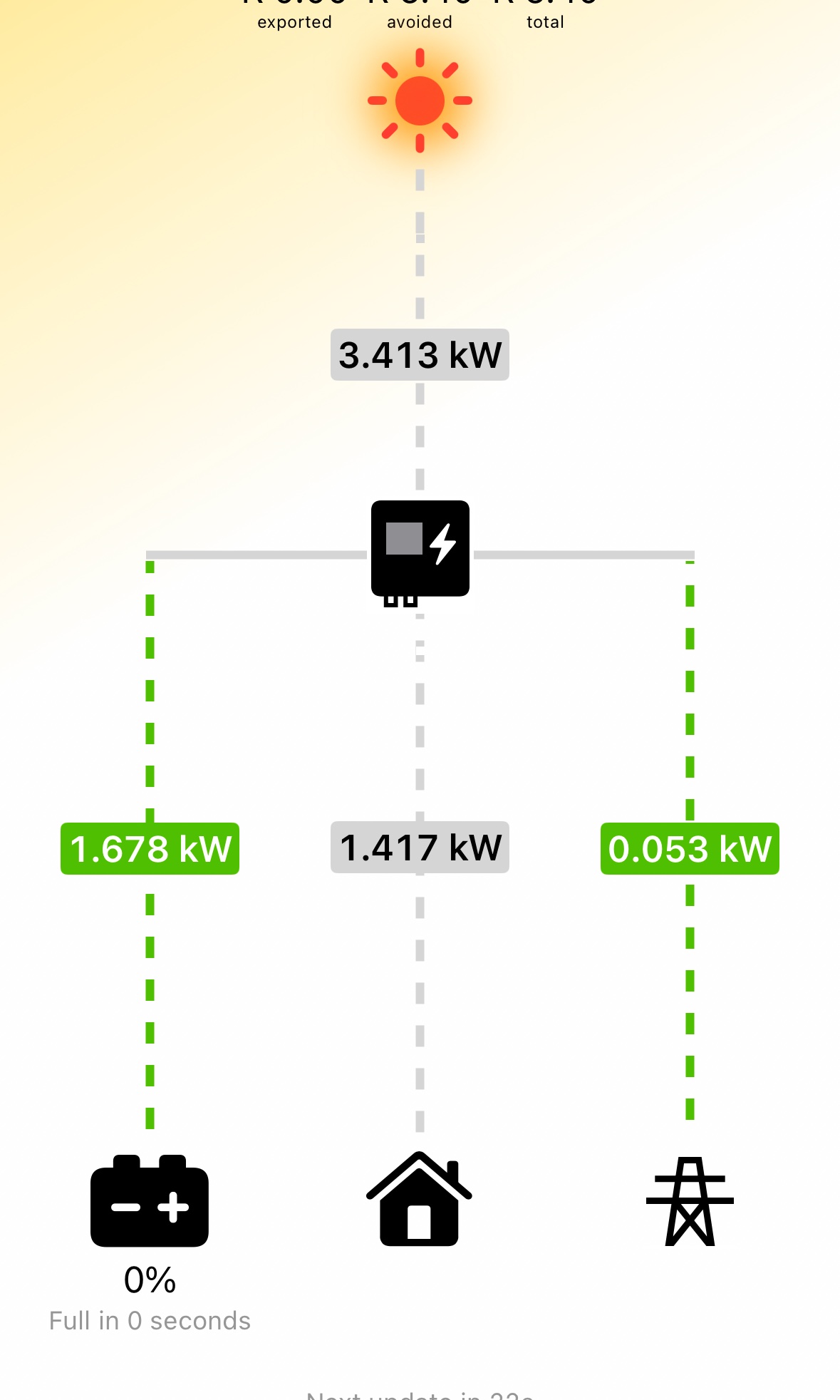

From day 1, the Battery SOC metric has been unavailable, and when using other apps that rely on the API (energy stats) the SOC is also blank there. Interestingly, the SOC history graph in the 2.0 app is not available and just shows a flatline. My installer has raised with support, I've also logged a ticket directly with FoxEss but relatively frustrating to not have the SOC in home assistant.

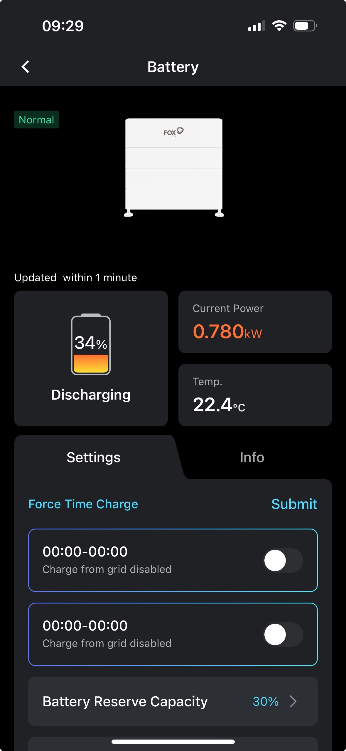

I think you're onto something with the fact that 2 batteries are supported and I only have 1. I can see SOC just fine on the 1st page of both the 1.0 and 2.0 apps. When I go into the 2.0 app, under devices and battery I see the SOC just fine: I know that if I have 2 batteries I could just swipe left or right between them, but don't have that option since I only have 1.
The issue is that the SOC history isn't available in the app or in the API (see SOC in energy stats): I have logged a ticket with foxess support so hopefully they'll be able to help. The longer this takes the more I'll be pushed to go the modbus route...
