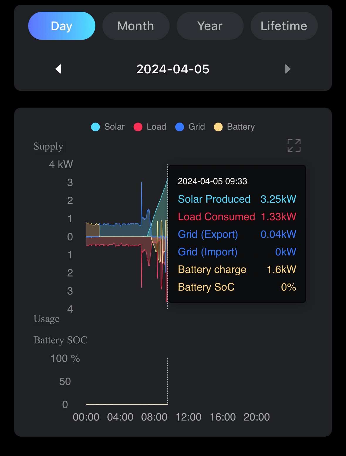

I think you're onto something with the fact that 2 batteries are supported and I only have 1. I can see SOC just fine on the 1st page of both the 1.0 and 2.0 apps. When I go into the 2.0 app, under devices and battery I see the SOC just fine:
I know that if I have 2 batteries I could just swipe left or right between them, but don't have that option since I only have 1.
The issue is that the SOC history isn't available in the app or in the API (see SOC in energy stats):
I have logged a ticket with foxess support so hopefully they'll be able to help. The longer this takes the more I'll be pushed to go the modbus route...
