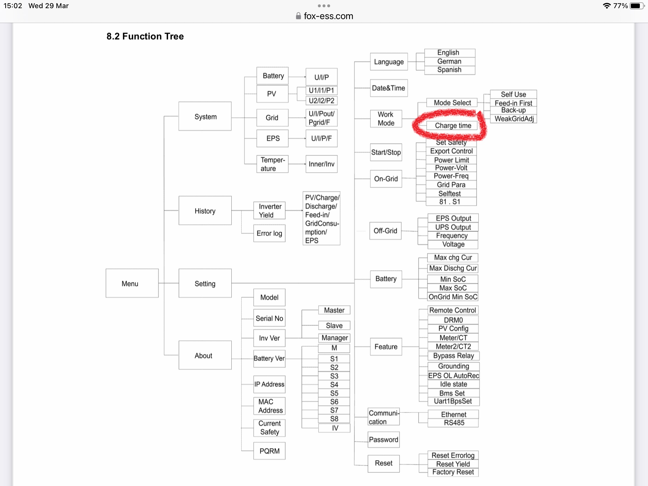

As an aside you can change the charge periods through the inverter panel but it is clunky - you will find the menu option here -
You have 2 charge periods P1 & P2, set the start and end time, and enable charge - it should say (En) not (Dis)
