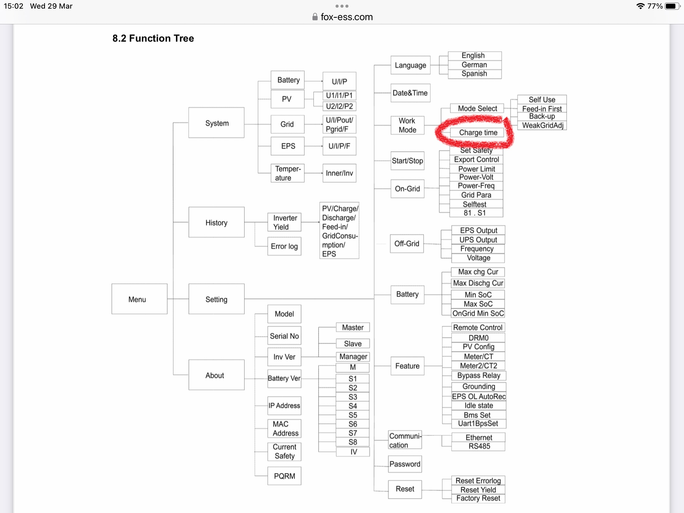

I have a new PV + battery installation (see signature), and want to eventually be on feed-in tarrif, be running from battery (self-generated or off-peak electricity as appropriate), manage my EV charging and be in control of it all (Home Assistant?).
Right now, I want to be able to start the day with a full battery charge, and gather some data before moving to Octopus Flux. This step will also help me to asses the battery size, and upgrade it if necessary.
I believe that at its most basic a charging from grid window can be set up via the control panel. I have the 'User Manual' for the inverter, which seems to show installation steps really clearly, but for Operations, merely gives a 'Function Tree' of the menus.
  • Is there any documentation to identify what each of the menu options means?
  • I have seen mention of web access to the inverter, How does one access this/is there any documentation?
  • Can this be done from the Foxcloud app (I have WiFi access to the inverter)?
I'm hoping somebody can help me take the first steps on this journey. Thanks!

As part of a new install I would expect you to have been setup with access to the Foxapp (or Foxcloud), using those you have easy access to set charge periods to do what you want to do.
If you haven't got access via web / app, try registering on the website https://www.foxesscloud.com/login and click the sign up link - you will need to datalogger serial number (that's your wifi dongle), but it must be connected to your wifi first - if it is flashing a red light slowly with an occasional green flash approx every 10 seconds then it is connected to your wifi.
If it isn't you need to connect it to your wifi first before you register it - see the guide below from step 3.
As an aside you can change the charge periods through the inverter panel but it is clunky - you will find the menu option here -
You have 2 charge periods P1 & P2, set the start and end time, and enable charge - it should say (En) not (Dis)

My installer pointed me in the direction of the Foxapp, which I have been able to use on my iPhone since the installation. My issue seems to stem from the very poor UI design of the app and the lack of any useful documentation.
Thanks for providing the link to the web interface, which worked first time with my existing credentials. Whilst the feature that I needed to set the charge periods wasn't exactly obvious there either, I did manage to stumble across it, and following the same logic I was also able to find it in the phone app. I also found a manual for the web interface on the Foxcloud website, but of course it doesn't make any mention of the features I needed.
Anyhow, the good news is that thanks to your information I have been able to schedule battery charging, and I have also learned that Fox have a habit of hiding the features you're after. :D I will know to look harder in the future.
