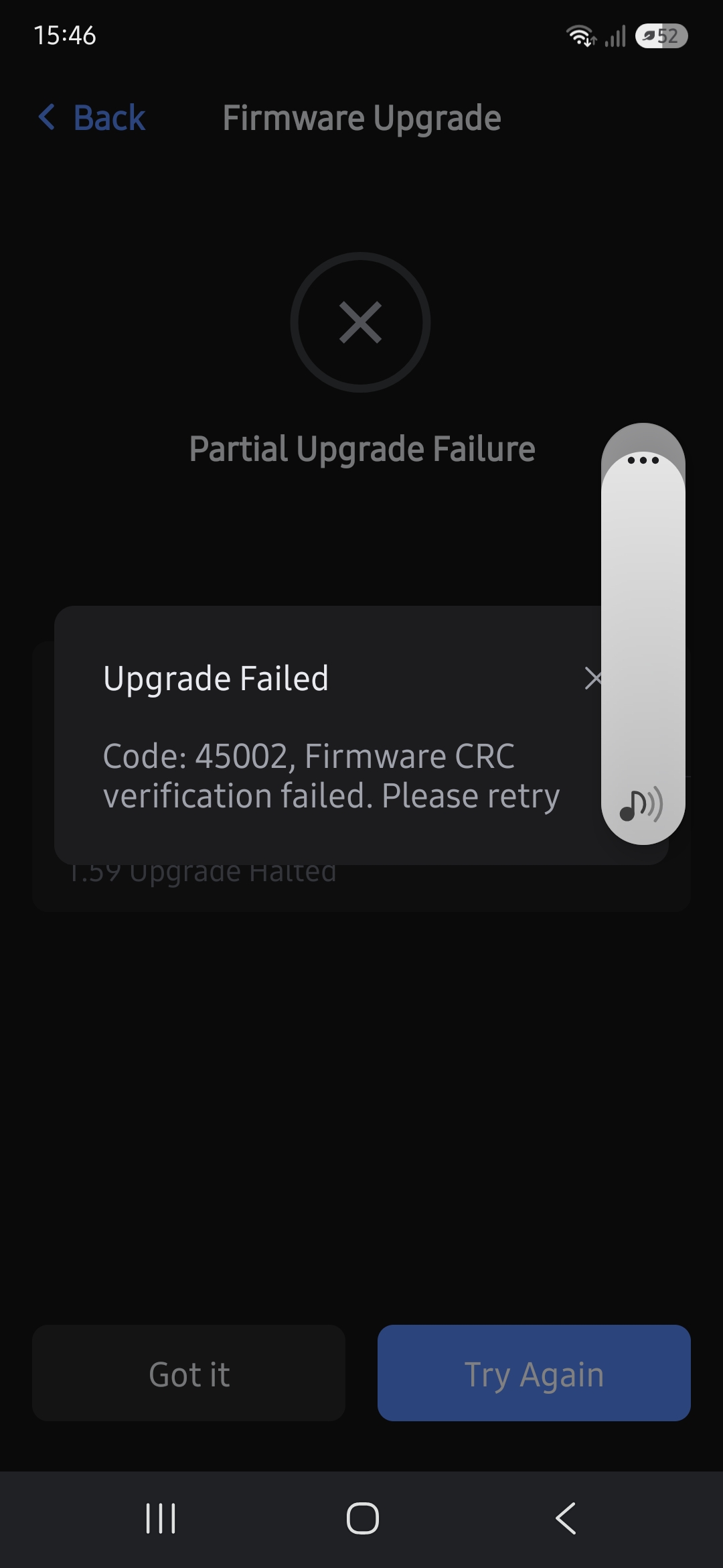

I have now managed to update the Firmware, but it took several attempts. I kept getting an error message, see screenshot. I don't know what that mean't, but it finally did it.

CRC = Cyclic Redundancy CheckNorthspoon wrote: ↑Fri Aug 07, 2026 10:58 am I have now managed to update the Firmware, but it took several attempts. I kept getting an error message, see screenshot. I don't know what that mean't, but it finally did it.
Basically a checksum for the download file failed = bad download
So upon trying again, you download a new copy of the firmware file, until the checksum matches.
