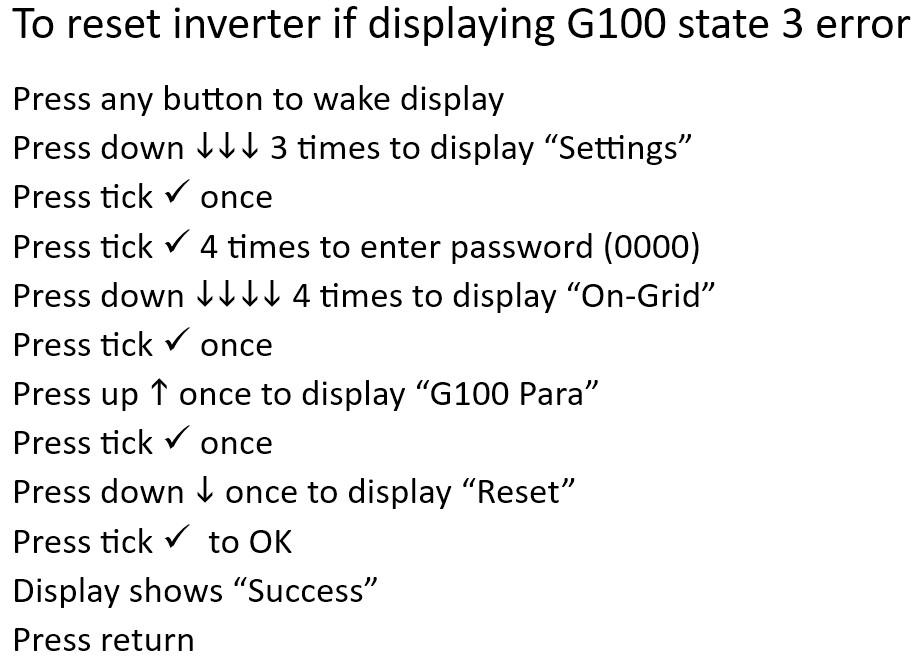

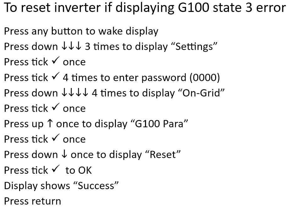

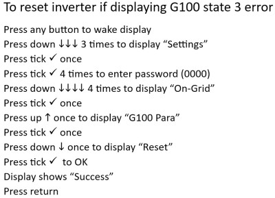

It's happening so often now I made this up to get to the reset setting quicker :cry:

At least now I can reset the G100 problem without clearing the error log.....

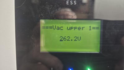

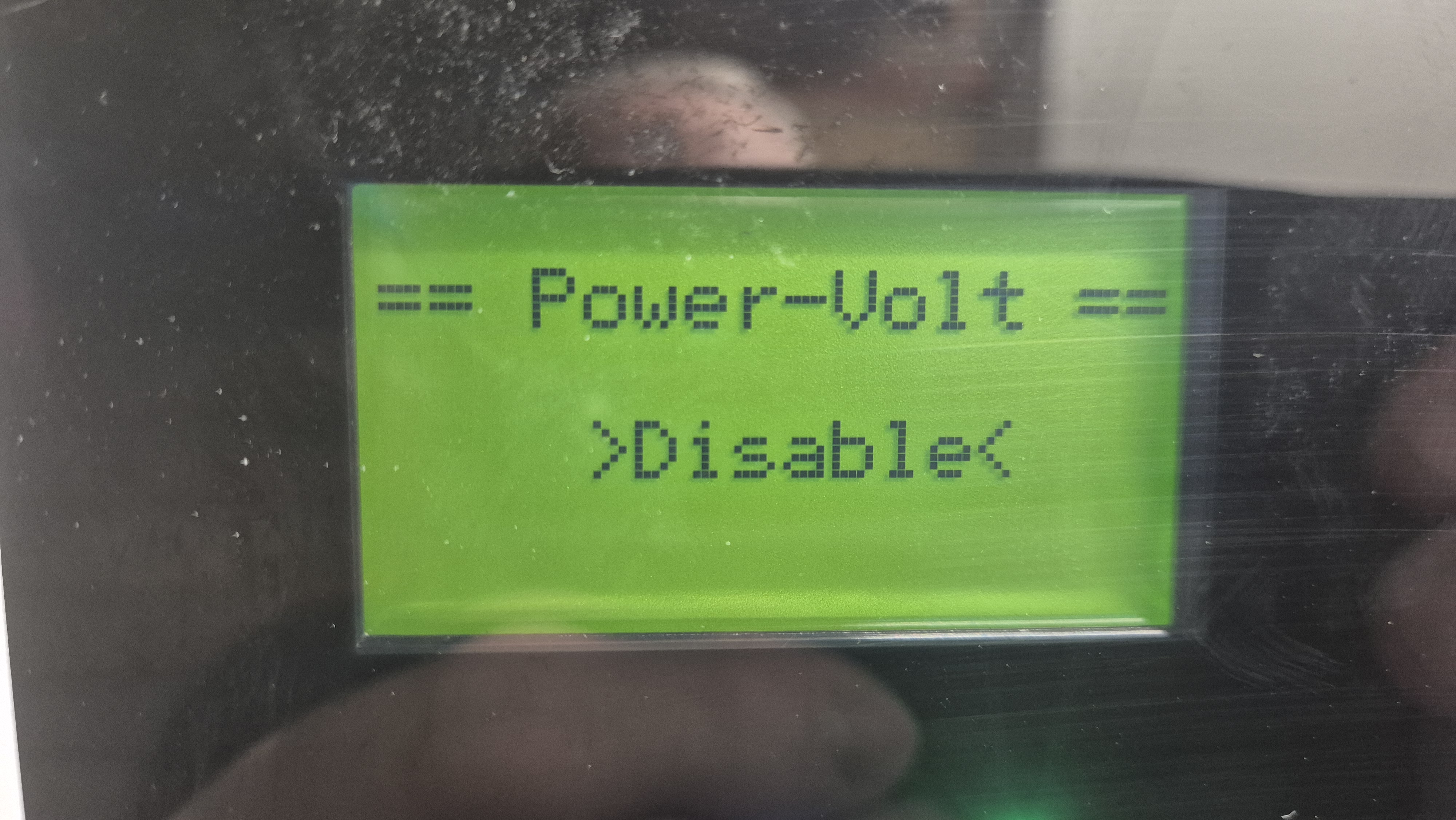

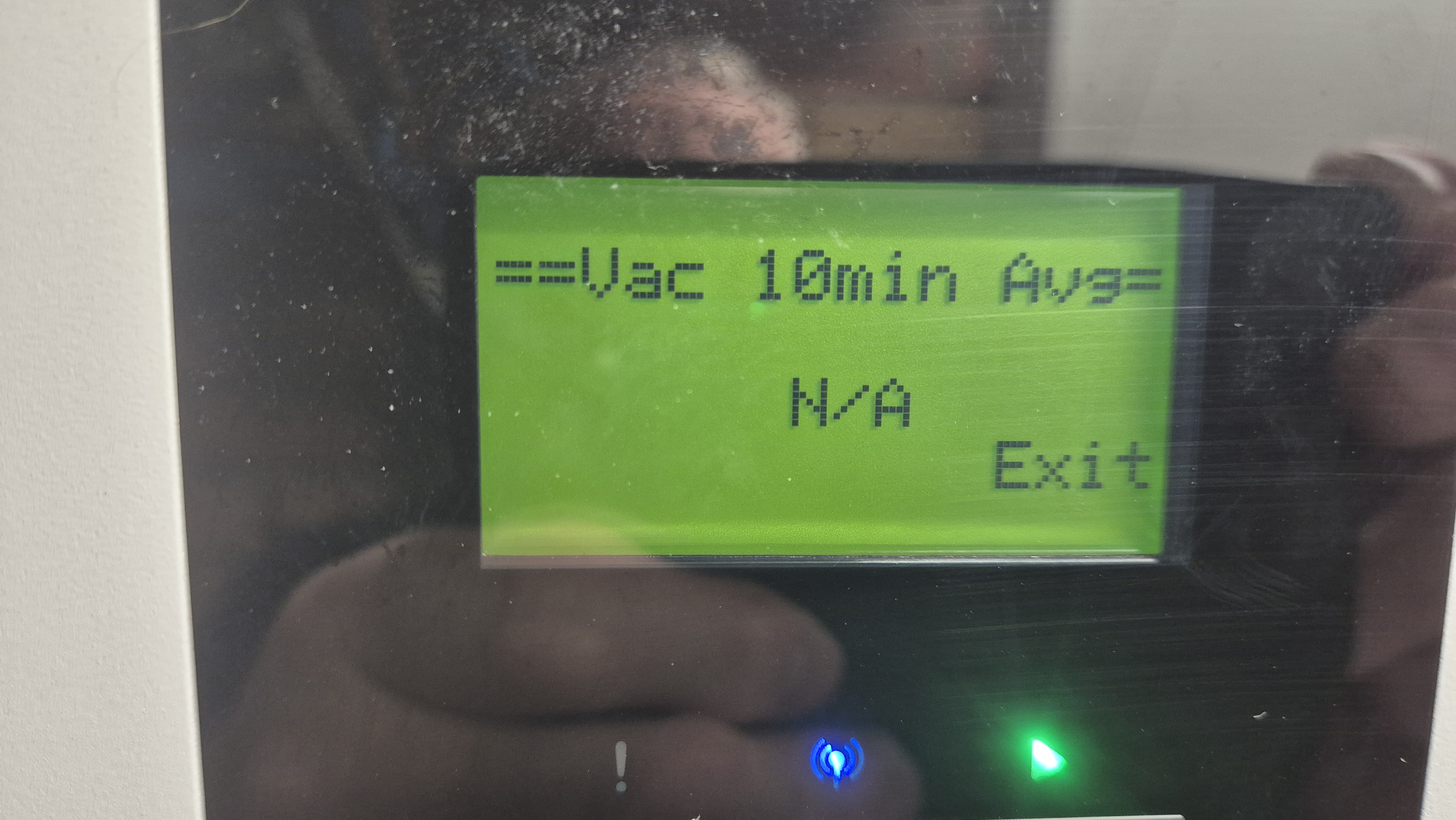

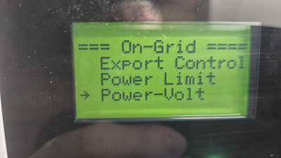

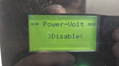

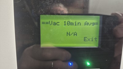

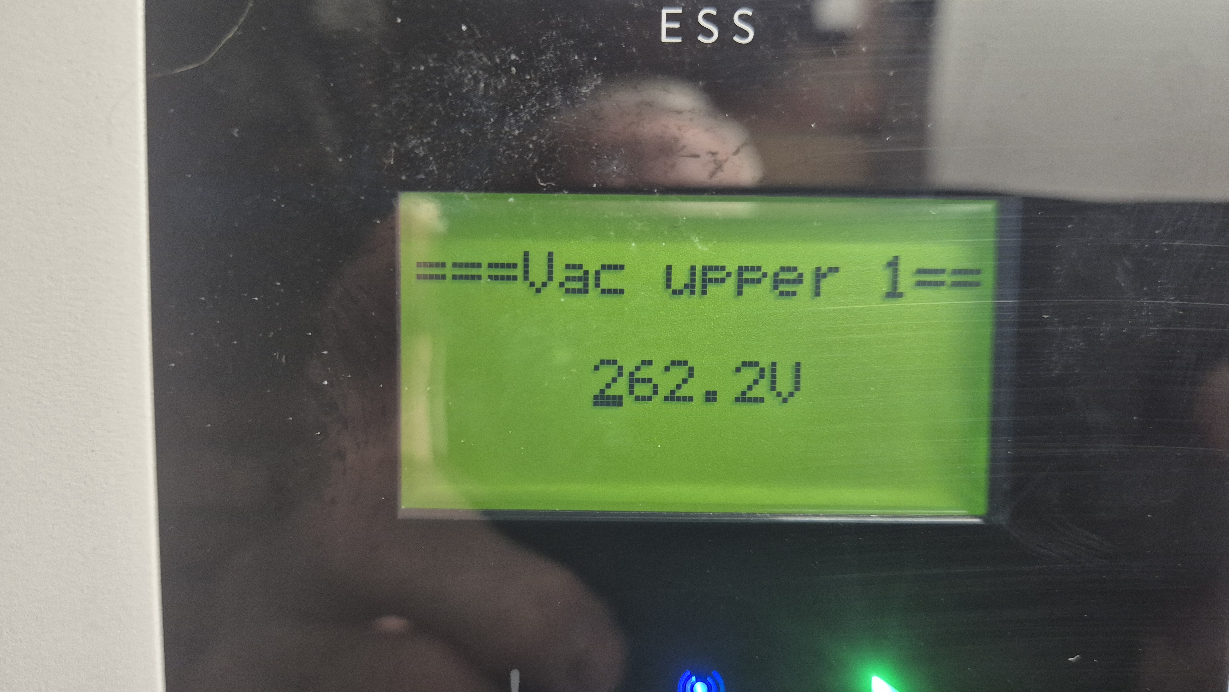

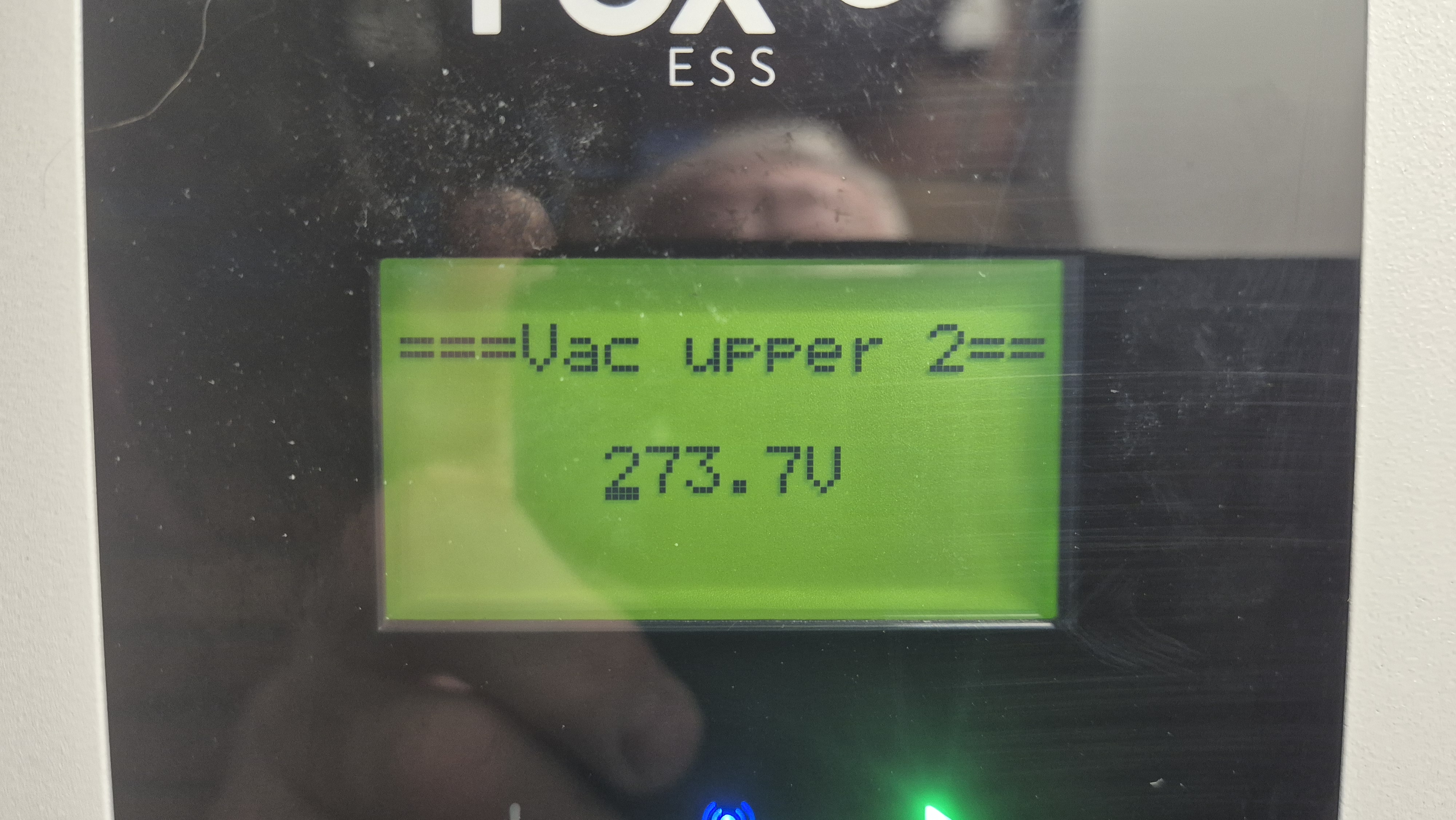

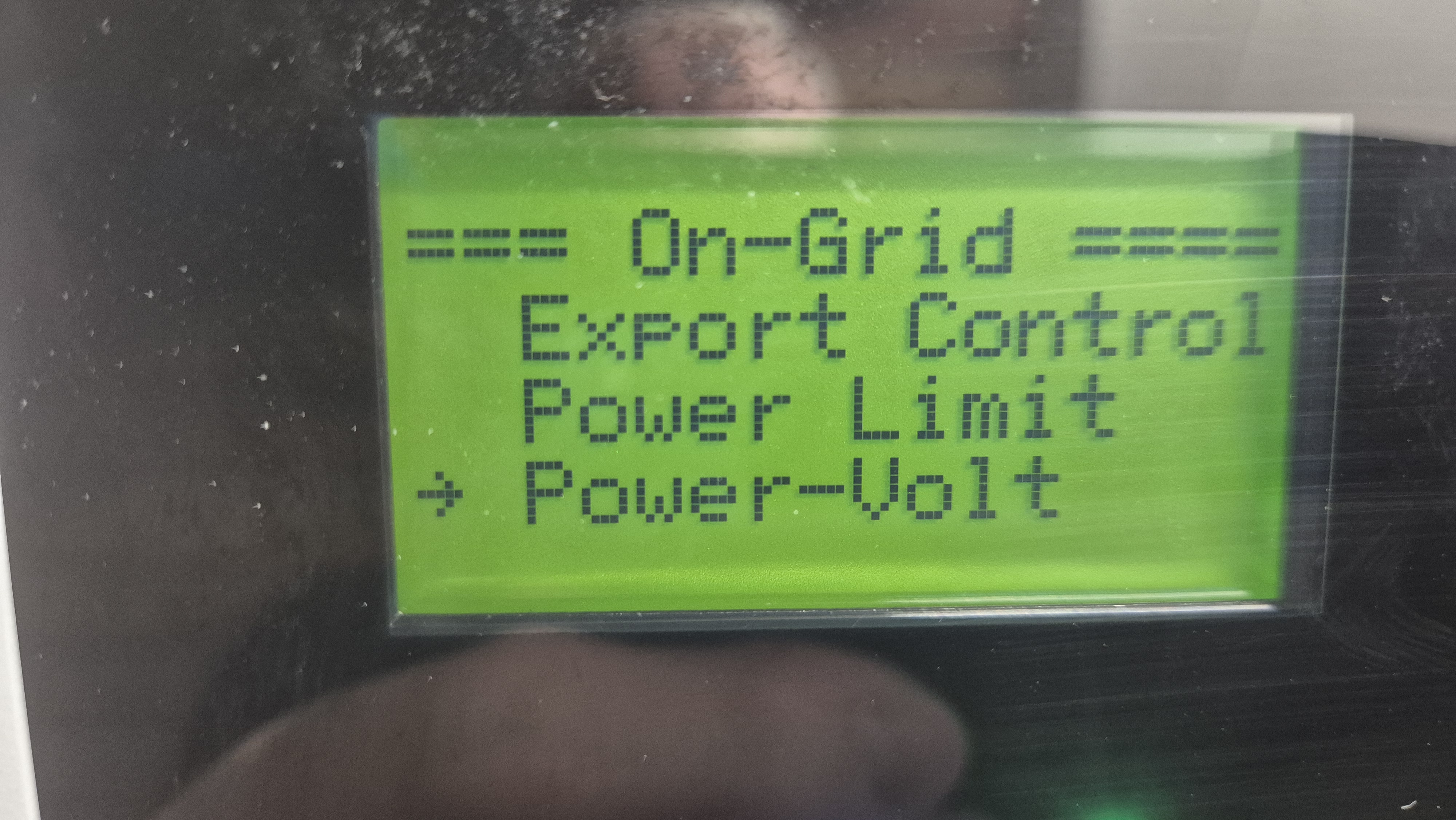

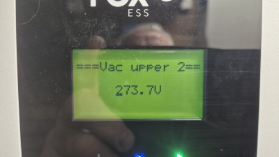

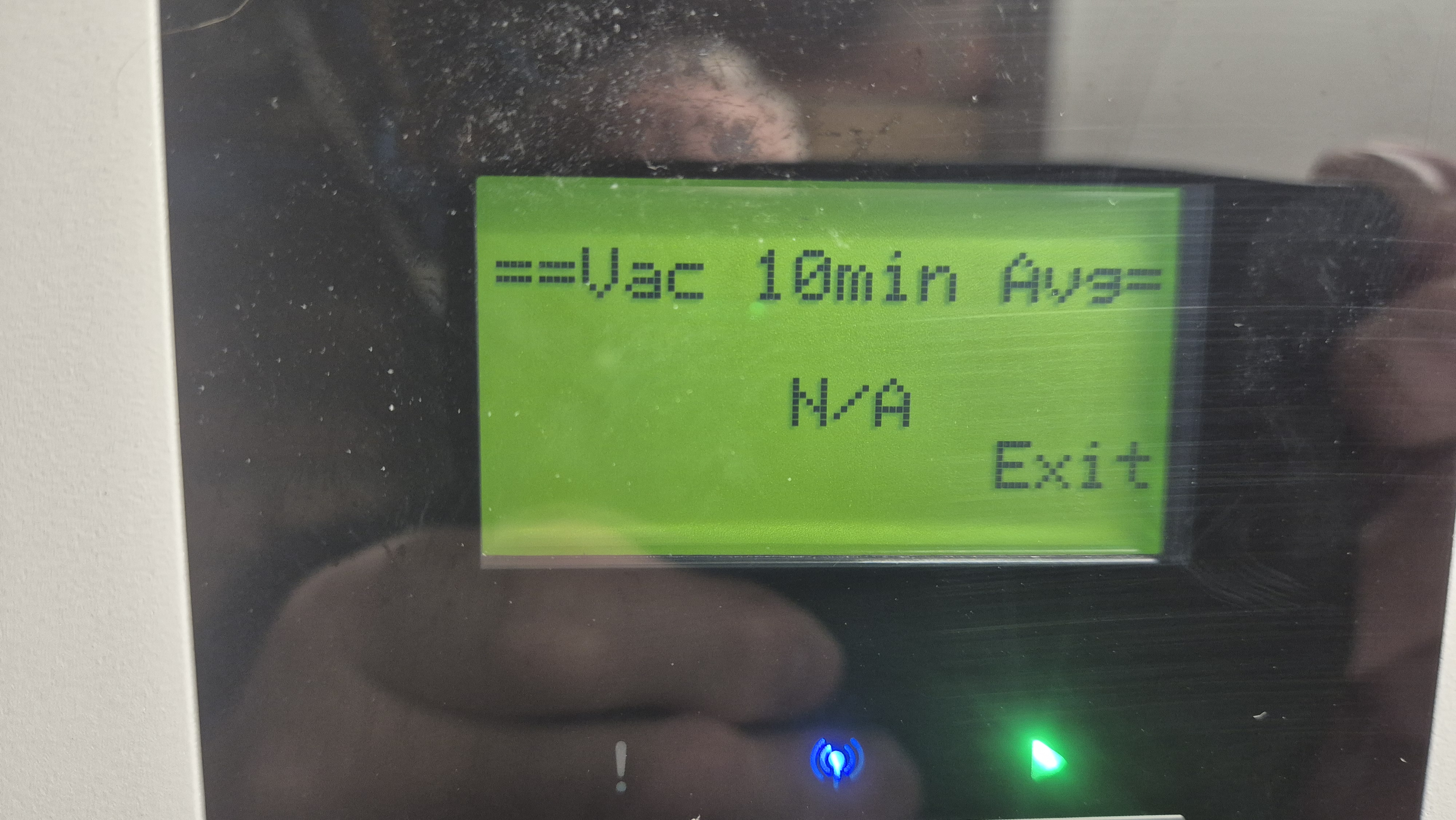

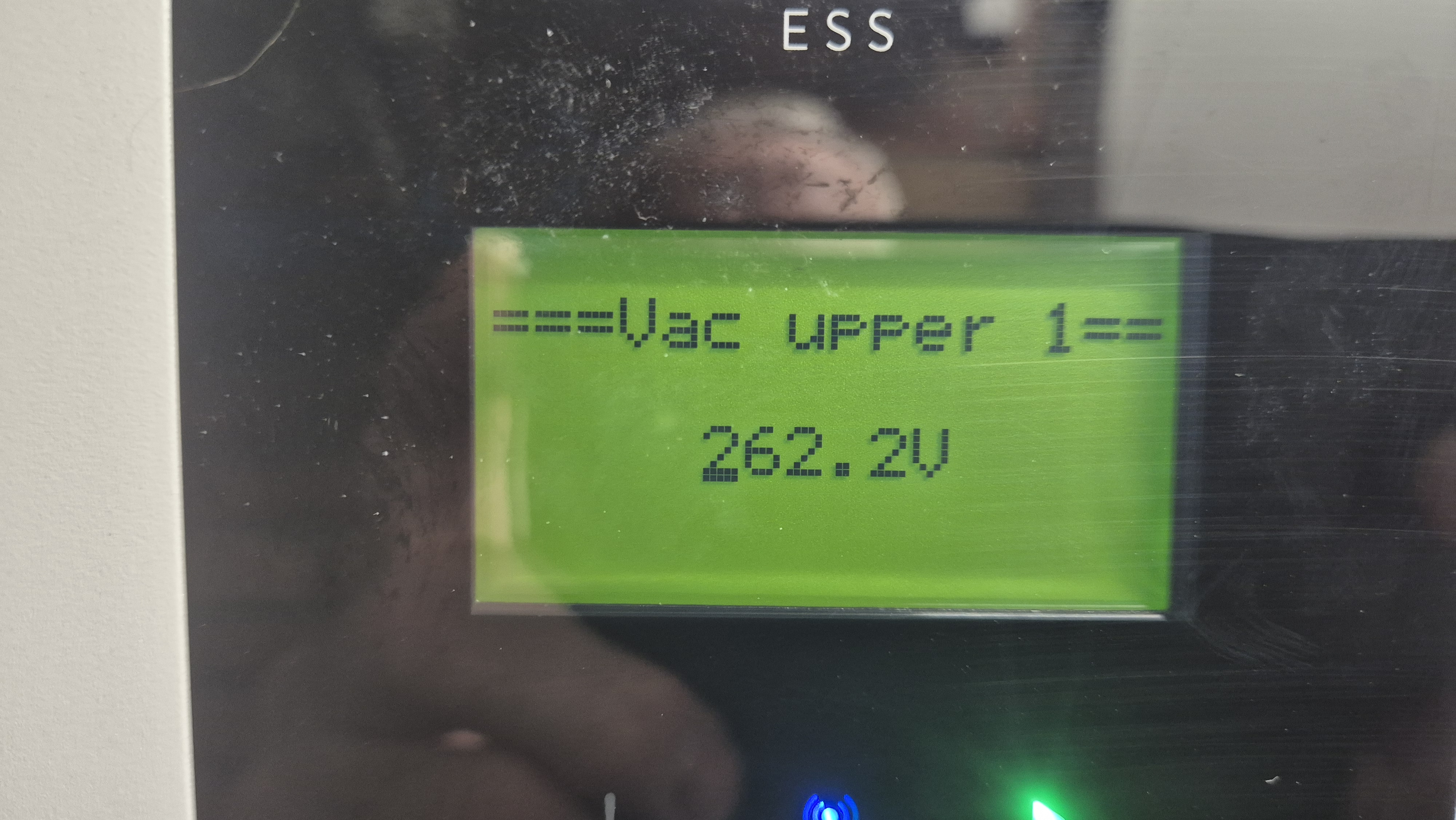

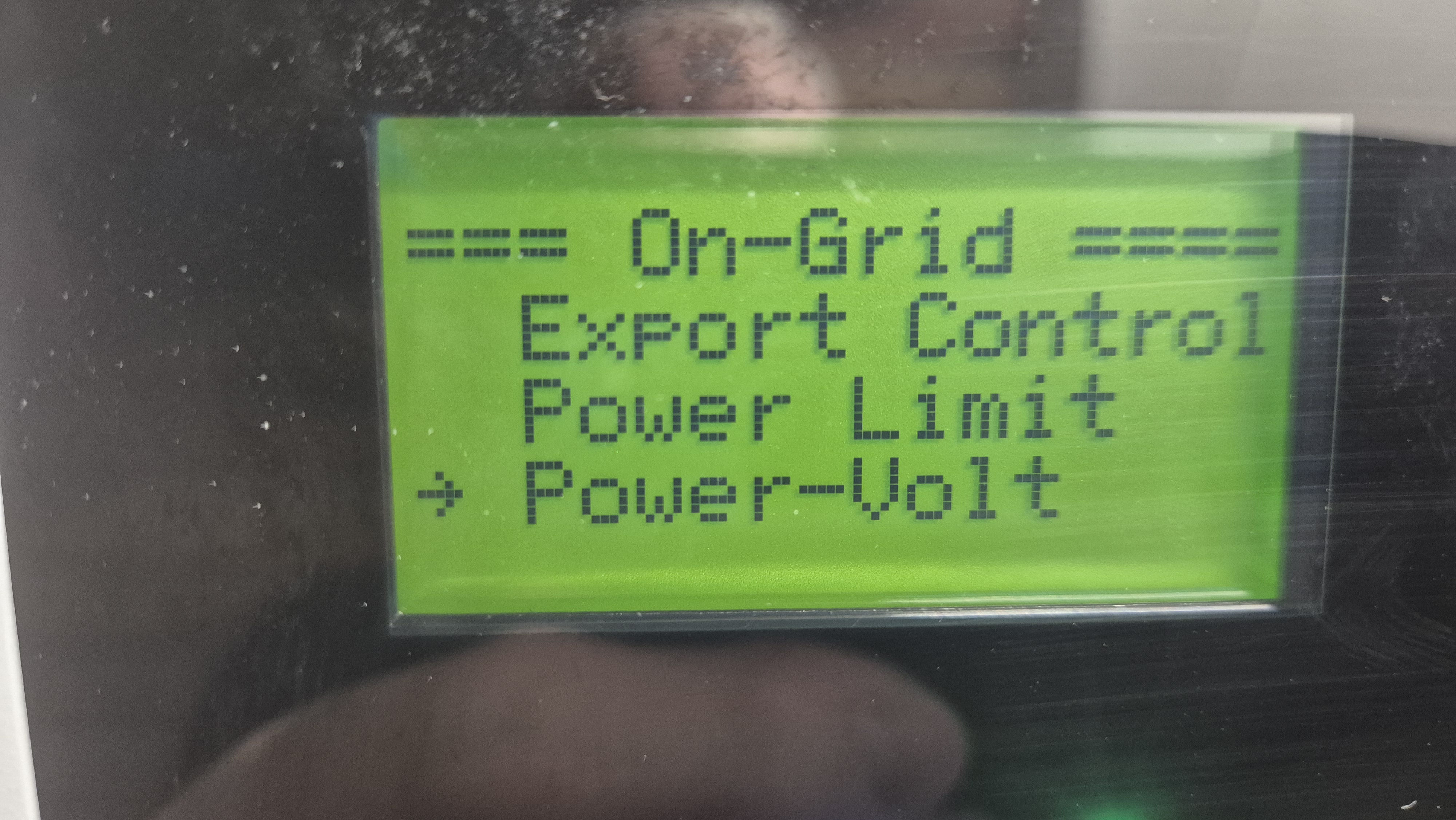

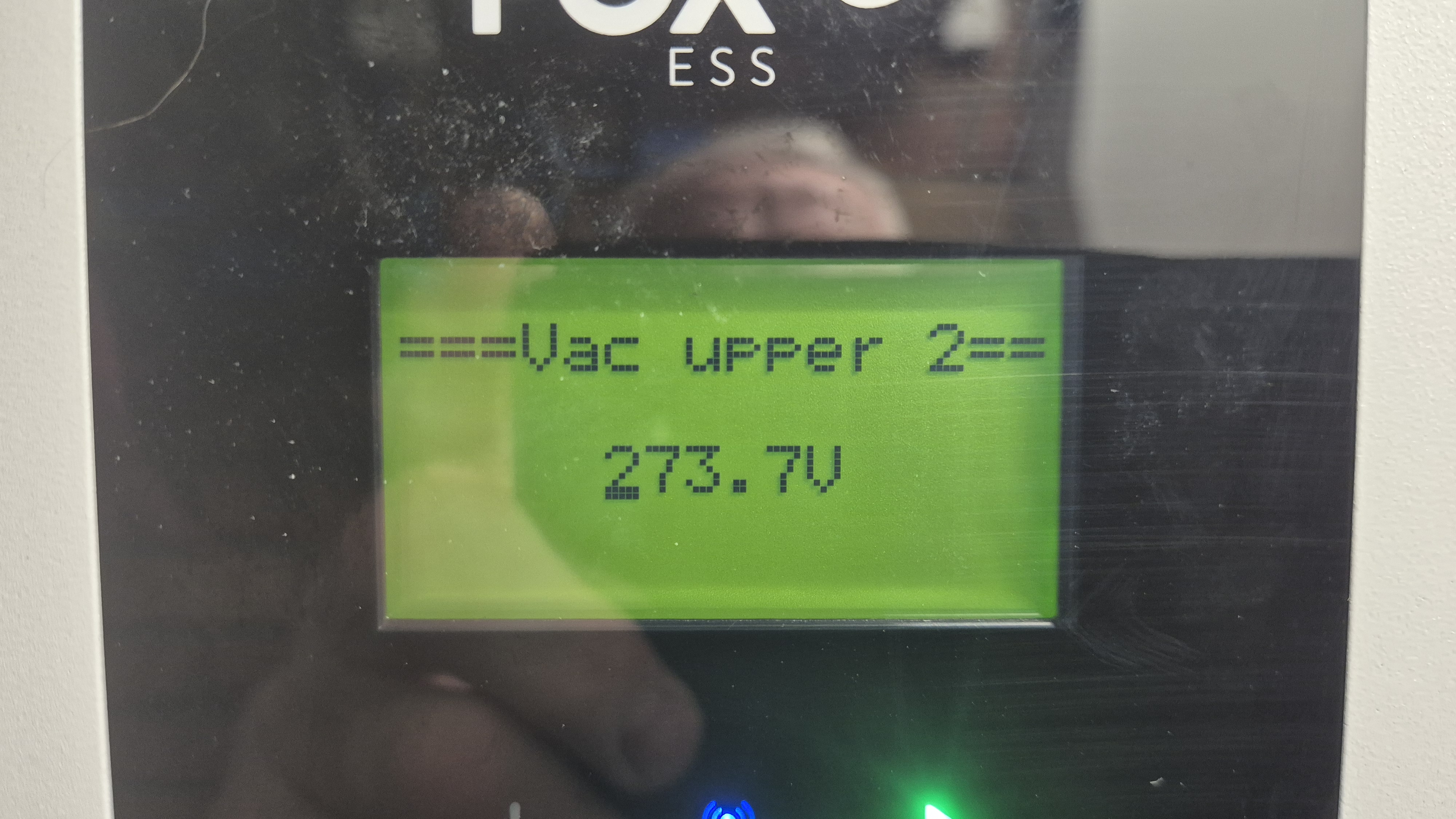

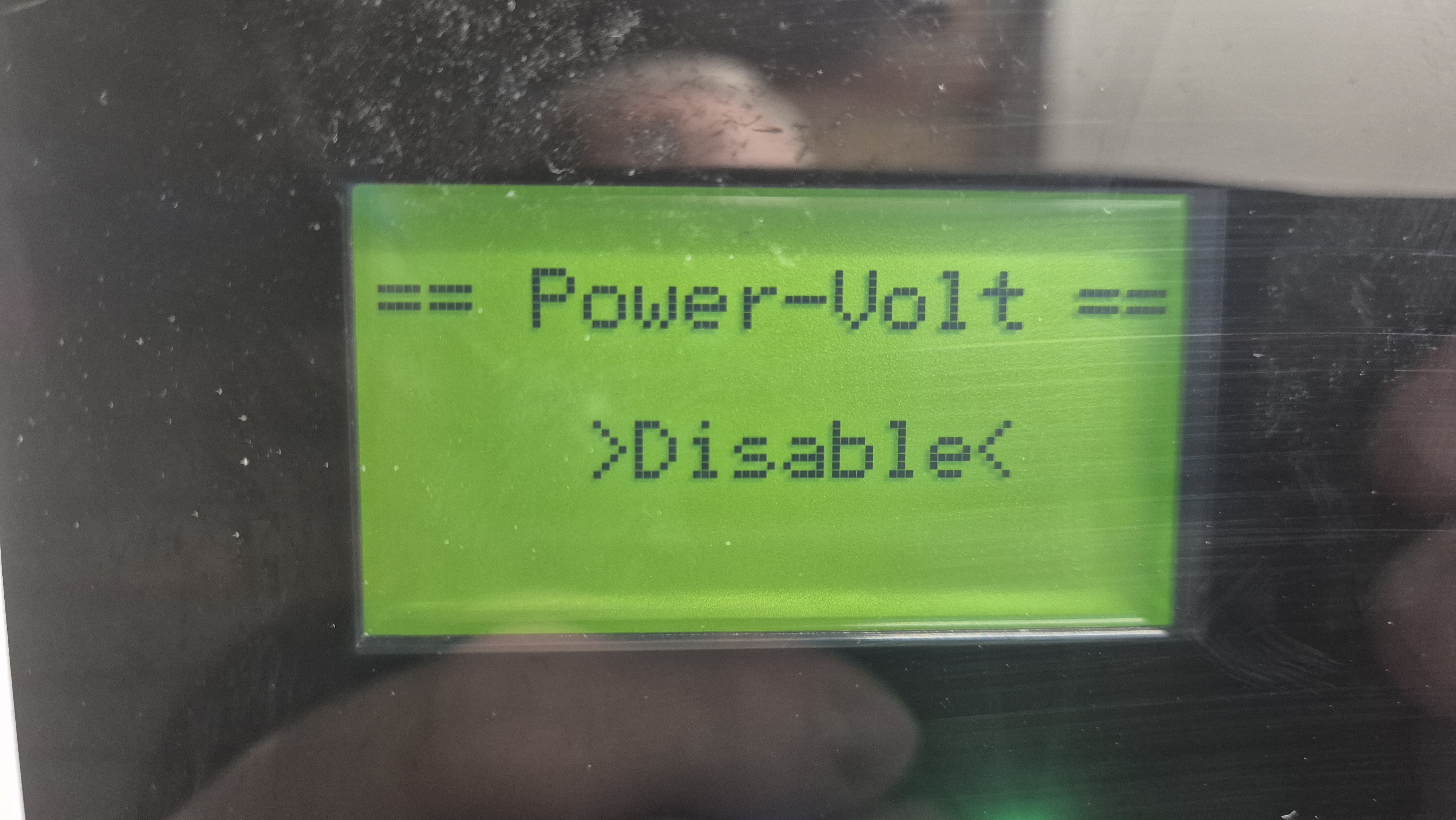

it does seem that the grid voltage is going above 253V for short periods... I found the Vac 10 min average setting but it is disabled and I cant seem to change it....also found these settings...are they correct ?
