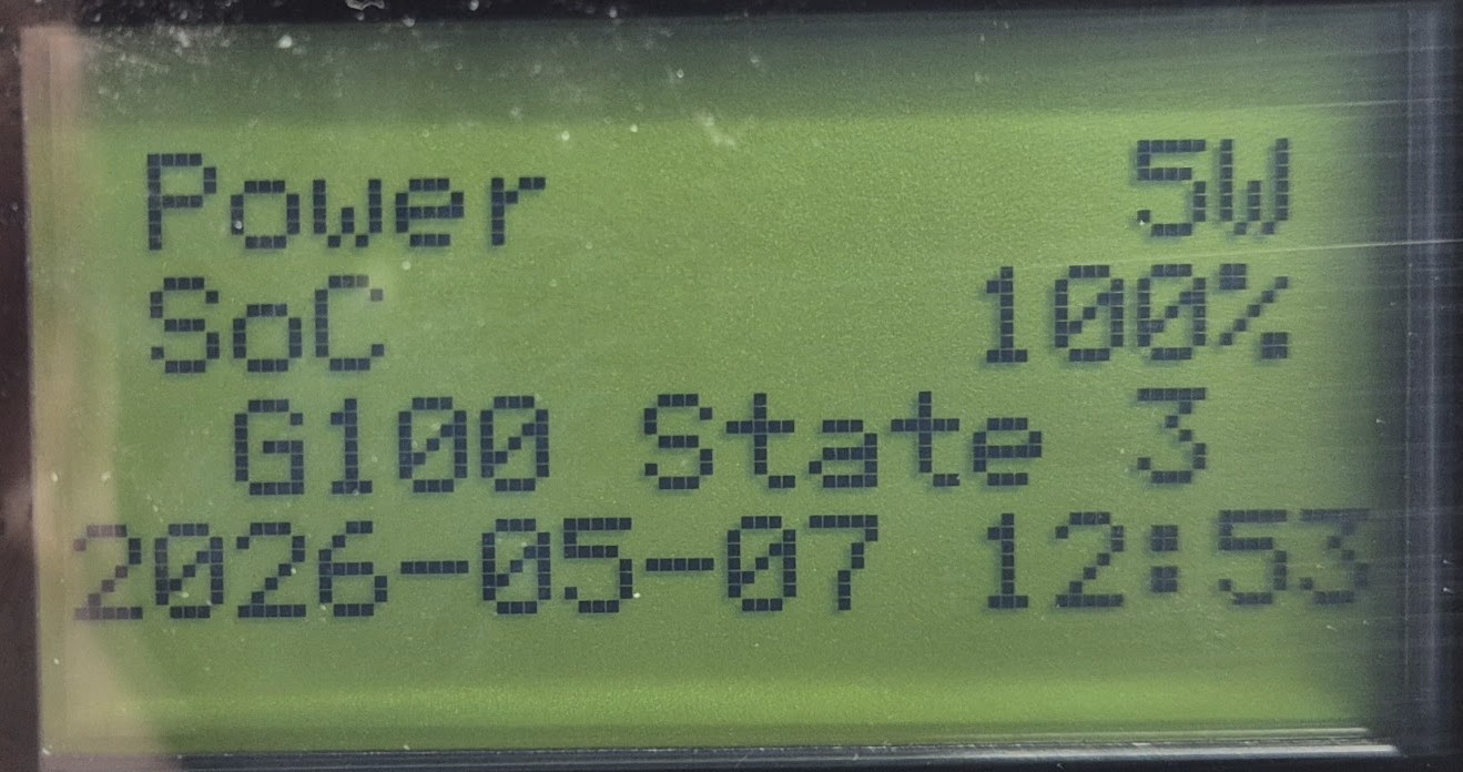

Our very new installation is playing up, and we have 'G100 State 3' on the inverter. I read something about locking out so now panicking - Any ideas?
Here's what we've got:
Inverter: H1-3.0-E-G2 (Master 1.27, Slave 1.02, ARM 1.44)
Battery: EP5 (version BMS 1.004)
If relevant, we have what might be a separate issue but I mention it in case it isn't - When the battery is on, it sucks house load from grid instead of solar. Solar only seems to work to charge the battery, after which it stops generating and house continues to take from the grid. Beautifully sunny day here so this is very odd! If we turn off the battery, solar feeds the house no problem. Work mode is set to 'self use' and no charge settings are on.
Thank you in advance oh knowledgeable people!

This message popped up for me today on my KH10.5.
The grid went down then back up again pretty quickly (within a few minutes) -- TWICE -- then I noticed the inverter was not taking in any solar power nor using the battery, it was just passing power from the grid to the loads (my loads are on EPS output).
Front panel of the inverter showed this G100 State 3 message. I checked and the inverter was still set (as always) in G99 mode, I have 10.5 kW DNO export approval.
I poked around a bit in the menus but the 'fix' was to power the inverter totally off and back on. A simple 'stop' / 'start' from the menu didn't do it.

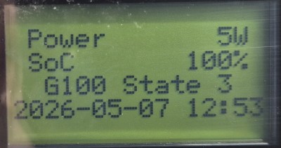

We now think that the g100 problems we are having is due to the wireless CT bridge.
It seems that after 3 "meter lost" errors in a day, the inverter goes to g100 s3. This can be reset by the user 3 times (I think), after which Fox have to clear it remotely.
We are unsure as to why we are getting these errors. I would be interested to hear if anyone else is using the Fox wireless CT bridge solution successfully.
I will update when we hopefully manage to finally fix it.

returned from shopping today to see my smart meter IHD telling me we were on grid draw
Sure enough the inverter was again showing G100 state 3 and after clearing the fault log it returned to operation
so, why is this happening and why didnt I get any notification about it.....it was only by chance that I happened to glance at the smart meter IHD

....and on it goes.....
i am getting seriously an annoyed with the repeated G100 state 3 errors in am getting on our KH7
Twice today I have had to reset the fault log in order to restore PV output and take our house load off the grid
This has been ongoing since installation a month ago
I have to reset the error log in order to get it working again.....is there an easier way ?.....has anyone figured out why it is happening ?
