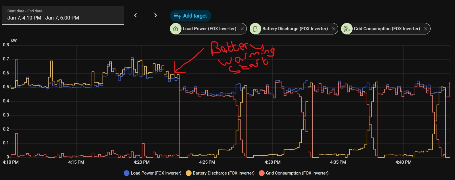

Having had the firmware updated to 1.11 today, I'm experiencing the same issue with the battery stopping discharging as soon as the heating kicks in. I've got the sliders at 7-11C and as soon as I hit 6.9C the heaters kicked in and all the power is being drawn from the grid despite their being over 60% left on my battery. I'll be interested to see what the response is from Fox-ESS with the tickets that people have opened.

Looking forward to your testing, but looking below it does look just as duff
It does look like the 1.011 FW is just as stupid as the 1.009 behaves.philt1808 wrote: ↑Wed Jan 07, 2026 3:54 pm Having had the firmware updated to 1.11 today, I'm experiencing the same issue with the battery stopping discharging as soon as the heating kicks in. I've got the sliders at 7-11C and as soon as I hit 6.9C the heaters kicked in and all the power is being drawn from the grid despite their being over 60% left on my battery. I'll be interested to see what the response is from Fox-ESS with the tickets that people have opened.

Like having a car where you turn on the heating and it stops driving, makes no sense as to why this happens.
For info .. looks like firmware v1.11 did nothing to fix the issue ...... once battery heater kicks in .... battery stops discharging. I have sent the attached back to Fox .. again

Any way you can do a screenshot that includes SOC and temperature alongside the charge/discharge rates?
Here we go - the second picture shows when I disabled battery warming, and everything started to work again
Sorry not sure I understand ...the first and second charts look the exact same. What I was curious was with heating enabled, to see the SOC and Battery temp in parallel with the charge/discharge rates.
I understand it that at 16:22 approx the battery registered 8.9C (heater starts as it drops below his 9C start point)maccoylton wrote: ↑Wed Jan 07, 2026 5:19 pm Sorry not sure I understand ...the first and second charts look the exact same. What I was curious was with heating enabled, to see the SOC and Battery temp in parallel with the charge/discharge rates.
The moment it begins, you see the grid take over the house load, the battery stops supplying the load.
Every 5 mins it seems the battery decides it can supply house load, and the grid drops down, and after a minute or maybe 30 seconds, the battery gives up and the grid takes over once more... repeats this every 5 mins.
At 16:48 approx, he disables heater function and the battery takes over house supply.
What's odd, is the cells temp continues to drop, normally you would see an upward trend in those 20mins of supposed heating.
Suggest it is not heating, since the temperature keeps dropping. My battery is outside, and currently it's around 0 degrees, looks like my charging kicked in around 16:08 today and it took 30 minutes to get BMS Cell Temp Low from 9 to 14 degrees
