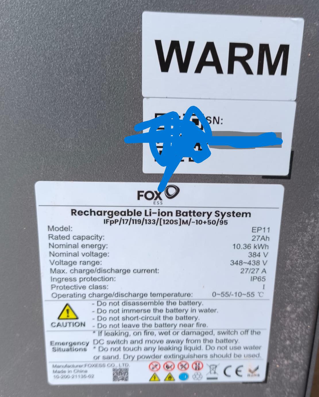

Might also be worth posting a picture of the model details sticker on the side of the battery so i/we can confirm you do have a heater model as there is a great deal of confusion about which have and don't have a heater currently.

I'll post a photo of the sticker when I get home tonight, I'm pretty sure it didn't have a -H on it though so I'm not totally convinced it's the heated one.

This is the sticker on the battery In the desktop version is shows version on battery master as "1.005" is that the firmware? Can't see where else the firmware version would be listed

That doesn't look like a H model so no heater. Current firmware for the EP is 1.006 so nearly up to date. Your inverter firmware will also need to be the latest but if on the latest and no battery controls then it's highly likely you don't have a heater model.

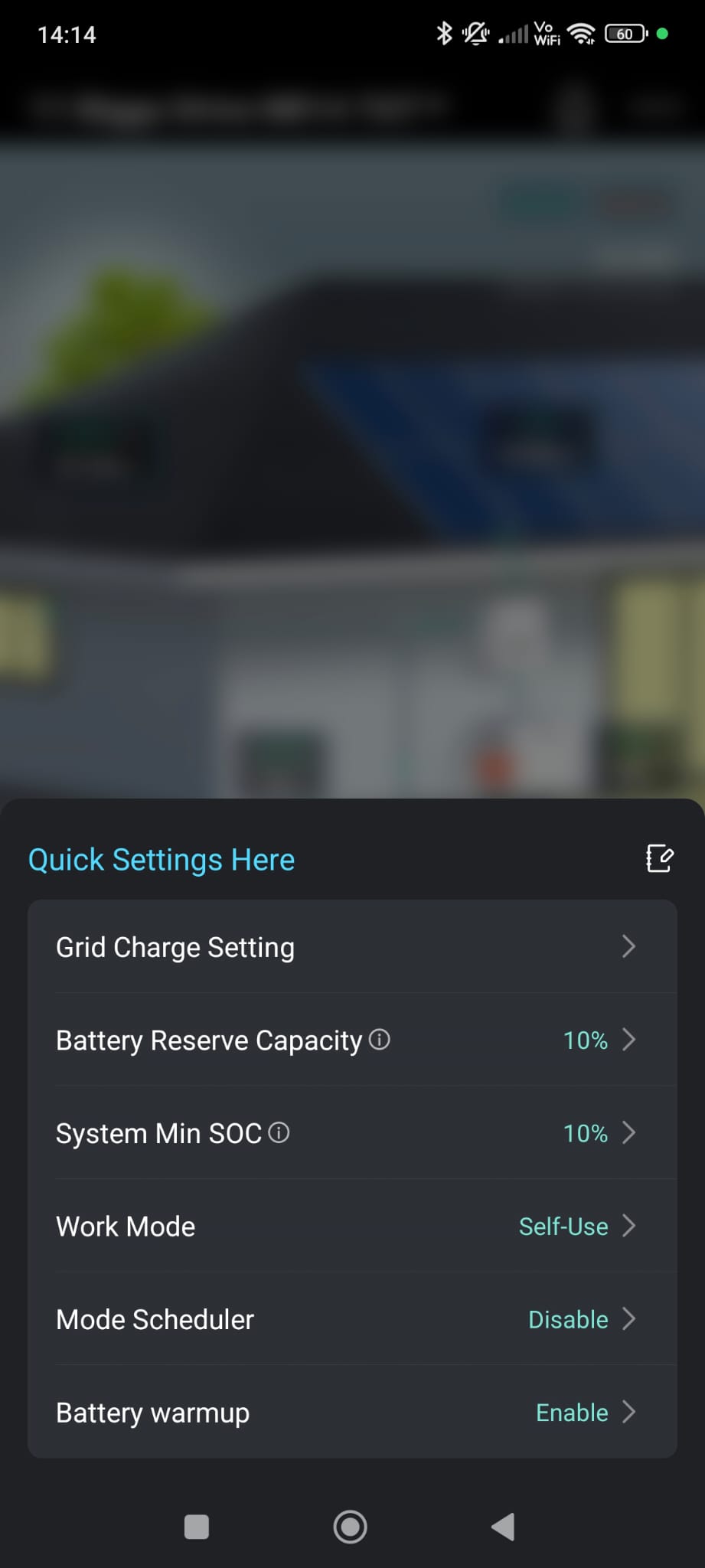

I've got the 'Battery warmup' options on the app, but as far as I can tell it doesn't seem to be functioning. I've set the schedule for 'warmup slot in low price' to coincide with my off-peak rates overnight, but it never seems to warm the battery. And in this cold weather that means it will only charge at about 850 W!

2. Secondly, the 'warmup slot in low price' time settings cannot span midnight, i.e. if you want 23:30-05:30 you'll need to use two slots: 23:30-23:59 and 00:00-05:30. This is the same behaviour as the Mode Scheduler, but unlike the Mode Scheduler it didn't throw an error and instead just silently failed.

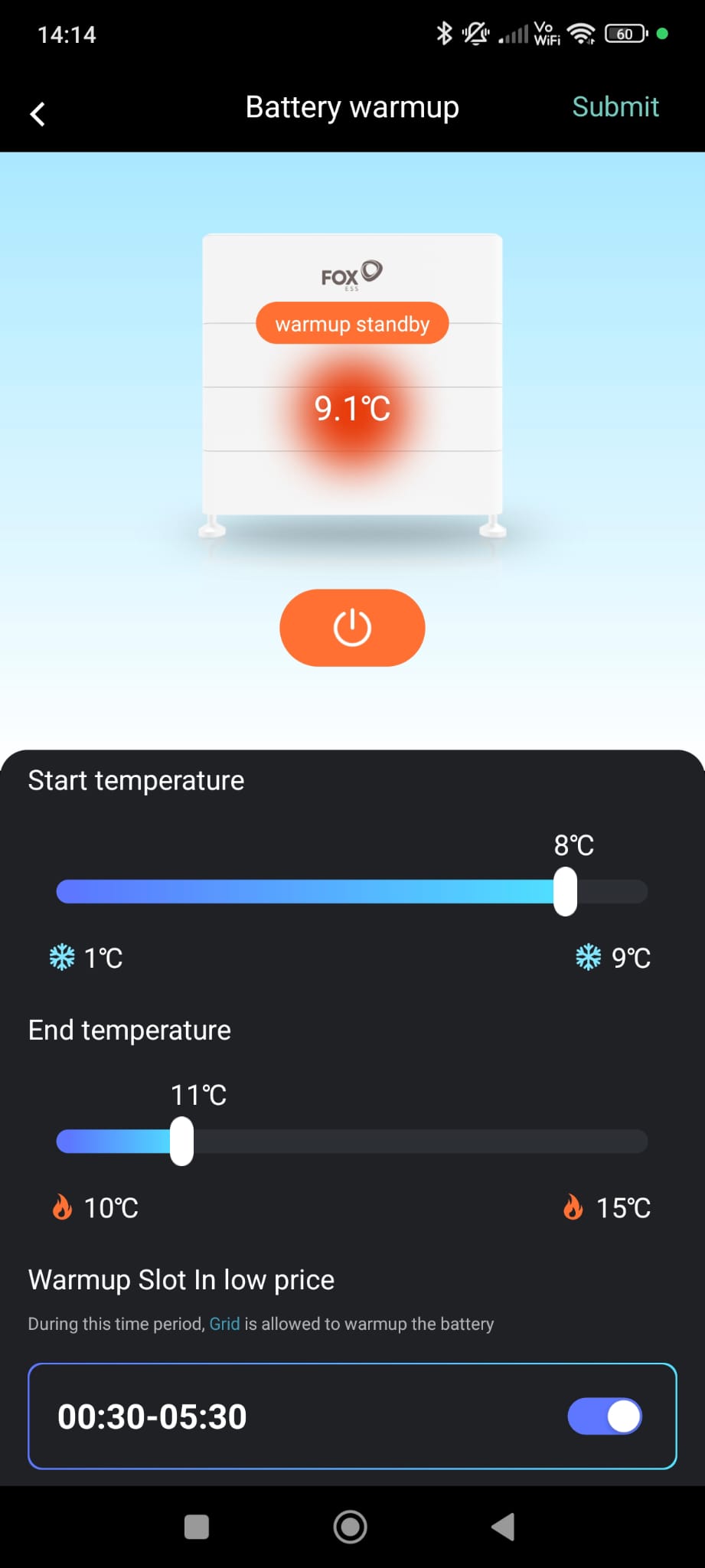

Does anyone know the recommended temperature settings - min and max please ?

I've just been through all this figuring out if the EP11 was the heated model or not (found the WARM sticker); and then becoming luckily enough to get the settings to appear in the app yesterday.

Make sure to use 2x slots, 23:30 - 23:59 and 00:00 - 05:30 if you have not already.
Mine has min temp set at 0 C and max 22 C (in real life it never gets to 22 C in the cold, but it's in garage)
