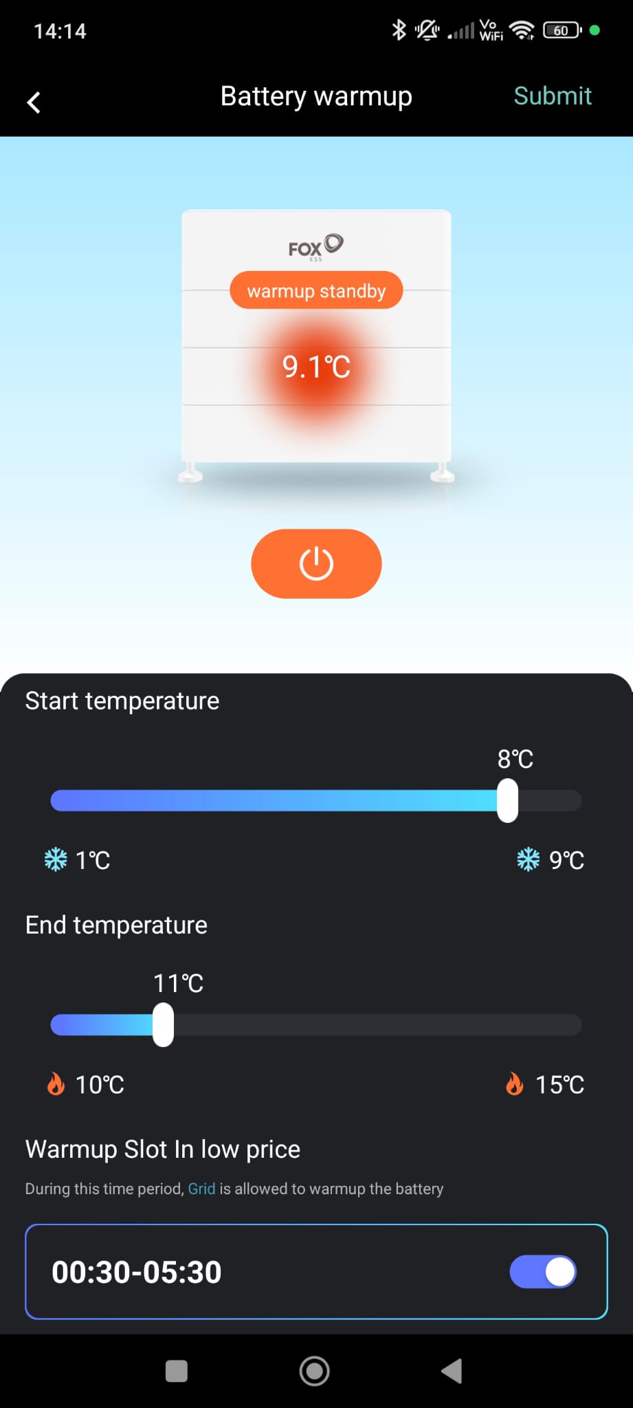

Hello, found this thread via Google and think I'm in the same boat as Scott.
Had my system installed a week ago - the fitter informed me that I've got the EP11 with heating element (wasn't what I was quoted for, but the quote was generated before the EP11-H was on the market). For what it's worth the label on it looks the same as Scott's.
I've got the 'Battery warmup' options on the app, but as far as I can tell it doesn't seem to be functioning. I've set the schedule for 'warmup slot in low price' to coincide with my off-peak rates overnight, but it never seems to warm the battery. And in this cold weather that means it will only charge at about 850 W!
I've had the inverter (H1-G2) firmware updated from 1.21 to 1.31, but that doesn't seem to have made any difference. The BMS firmware is 1.005.
@Scott - is your battery heating now functioning? What inverter do you have, and with what firmware version?
I guess I'm wondering if it's just a matter of waiting for the software/firmware to mature, or if I should be pro-actively asking anything of my installer to get it to kick into life.

Following up on this, in case it helps anyone else in future.
I raised it with my installer, who consulted with Fox. There were two main actions that now mean I have a functioning battery heating system (just in time for the weather to warm up
1. Most importantly, a BMS firmware update from 1.005 to 1.006. When the firmware update was applied my battery actually stopped working, and it took two rounds of power cycling the inverter and battery to get everything back (first power cycle brought the battery back, but no battery heating option at all, second power cycle restored the battery heating option).
2. Secondly, the 'warmup slot in low price' time settings cannot span midnight, i.e. if you want 23:30-05:30 you'll need to use two slots: 23:30-23:59 and 00:00-05:30. This is the same behaviour as the Mode Scheduler, but unlike the Mode Scheduler it didn't throw an error and instead just silently failed.
With these fixed the battery heating kicked in. Happy days.

Does anyone know the recommended temperature settings - min and max please ?
Many thanks
Russell

Make sure to use 2x slots, 23:30 - 23:59 and 00:00 - 05:30 if you have not already.
Mine has min temp set at 0 C and max 22 C (in real life it never gets to 22 C in the cold, but it's in garage)
I have not checked to see if it heats at 00:30 (my start time) but now it is in standby.danielk wrote: ↑Wed Nov 12, 2025 6:41 pm Today; not sure if the heater kicked in at all, but the battery did not charge at all.
