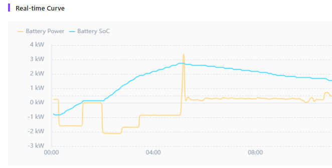

I'm looking for any settings to change but I just checked a few things. As of Now 12pm the battery is at 2.4oC
The Parameters say min Bat temp is 2.4oC
So it may be it heated its self as it was -1 overnight but stopped at 2.4oC
I include an image of the charging today
Tim
Tim
