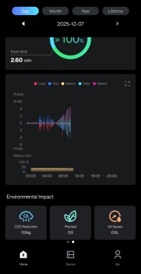

Some App screenshots
Have set Import current and power, they were set. But not as per what you provided
Note as I don't have PV Connected to Fox ess. Does that mean self use is not going to discharge battery if grid use is higher ?
I do wonder if a PV setting is conflicting
Here's a screenshot at 10:17 am
Which shows that the schedule has not worked
For forced charge
For forced charge
Can you post the graph at the bottom of the page when you swipe left on the home app page, it’s difficult to tell which way the power flows are going with the home page and it would be good to see if the battery is ever doing anything.
If you are just trying to charge the battery with excess solar you don’t need to force charge at all, just set Self Use and any spare should be used to charge the batteries.. but that battery seems stuck in idle ?.

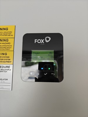

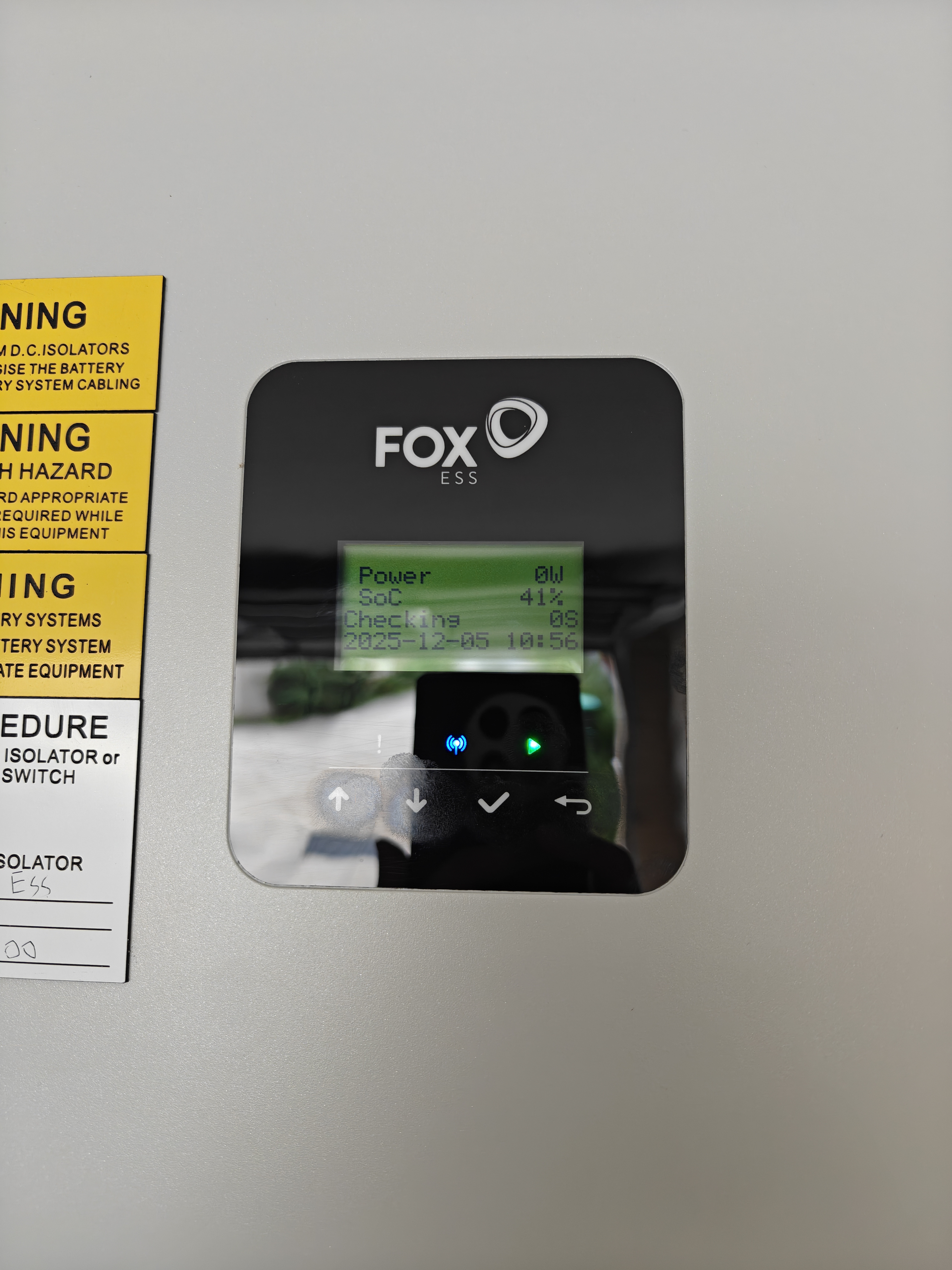

An update, as the issue is still not resolved
Inverter shows "checking 0s" and battery doesn't charge or discharge
In case someone has any other ideas
Installer came back last week. Did some troubleshooting as per Fox support . Disconnected and reconnected all cables. Had to leave as he had spent an hour already!
Firmware updates done on both inverter and battery
I was on call myself with Fox Engineer on Friday, did the restarts and reset as they instructed me to
They haven't confirmed if the inverter is faulty. And they will try to send someone on site ( no idea when )
Both CT are being read by the inverter properly
Gen load being my AC coupled solar
No solar connected to Fox kh9.9
More screenshots attached
