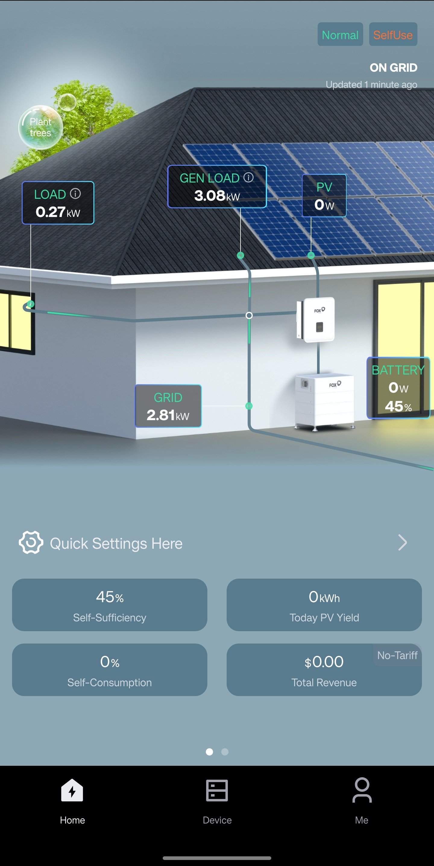

AC coupled, using CT to show gen load and grid load
Both loads seem to be correct from the App
Self use mode selected

Note as I don't have PV Connected to Fox ess. Does that mean self use is not going to discharge battery if grid use is higher ?
I do wonder if a PV setting is conflicting
Some App screenshots
Have set Import current and power, they were set. But not as per what you provided
Here's a screenshot at 10:17 am
Which shows that the schedule has not worked
