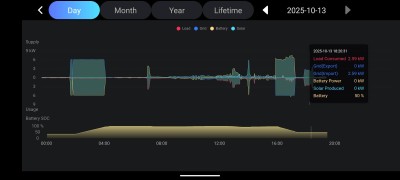

e.g. see the attached chart from this evening - FD SoC% was reached around 17:30, and we cooked dinner around 18:00 and all the house-load for cooking came from the grid, which has certainly reduced any profit from selling power during peak times!

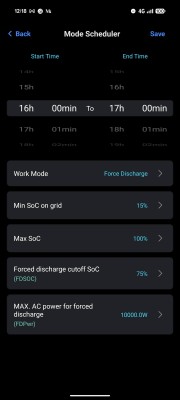

Apologies if you know this, but if you have FD SoC is 50% make sure your Min SoC for that slot is be set lower than this then it should use the battery?
    				    			Hey @chubber ,
It's always good to check assumptions!
Here's my FD schedule that ran yesterday evening: Min SoC is set to 15%, while FD SoC is 75%:

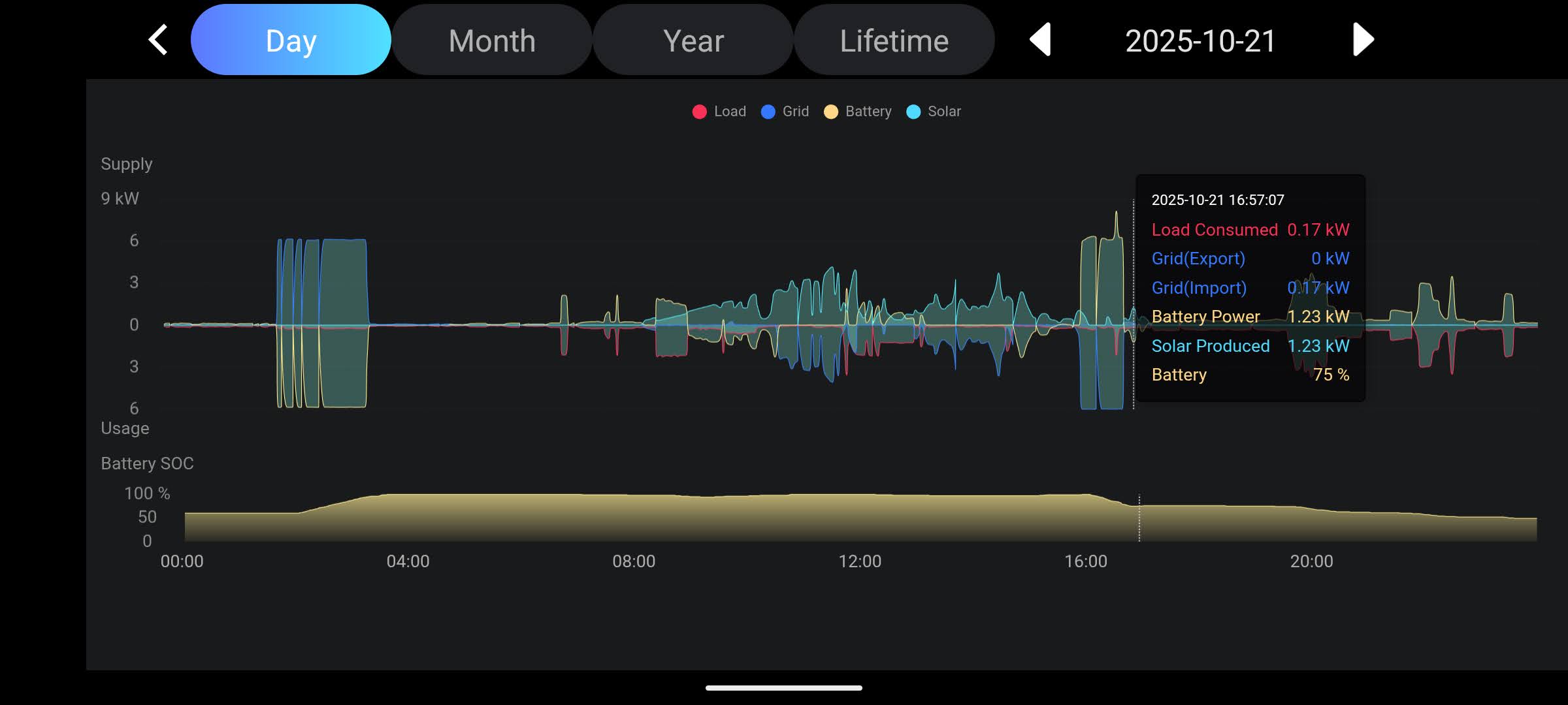

and here's the timeline:
where you can see shortly after the Force Discharge rule finished, when it hit its FDSoC, the house-load is being serviced from a Grid Import. Once the Force Discharge rule's time-period has elapsed, house-load goes back to being serviced from the battery

Yes I would have thought you have that set ok. Although you are producing solar at this point so I wouldn't have thought that it would use much battery. May just be a blip of grid usage. Sorry I can't help more than that.
    				    			It's better now I've started shortening the Force Discharge period to roughly match the expected time the discharge will take... before I was doing that it was quite bad - here's a week or so ago - it was a terrible day for solar, but without the import at peak times we would probably have been quite close to break-even
