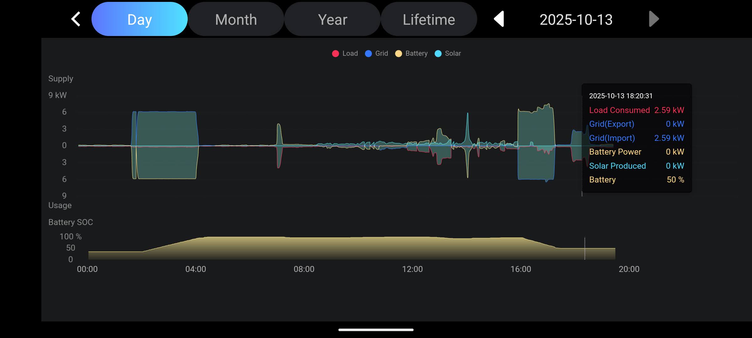

I've got a Force Discharge rule which is set to trigger during our afternoon peak period 16:00-19:00 ... it's currently discharging the battery down to an FD SoC of 50%, with an FD Pwr of 10kW, while the inverter has a Max Discharge Pwr set to 6kW, so there's a few kW overhead for the house load
This is fine while the Force Discharge is happening, but once the FD SoC% has been reached and until the end of the configured Force Discharge period, any house load seems to be drawn from the grid
e.g. see the attached chart from this evening - FD SoC% was reached around 17:30, and we cooked dinner around 18:00 and all the house-load for cooking came from the grid, which has certainly reduced any profit from selling power during peak times!
I don't want it to work this way - once the FD SoC% has been reached, I would like the house load to be drawn from the battery, otherwise we are paying for power at the most expensive time of day
Is there any way to make this happen, given current inverter config options ?
