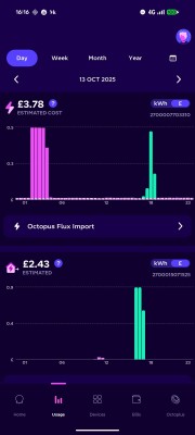

e.g. see the attached chart from this evening - FD SoC% was reached around 17:30, and we cooked dinner around 18:00 and all the house-load for cooking came from the grid, which has certainly reduced any profit from selling power during peak times!

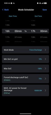

Apologies if you know this, but if you have FD SoC is 50% make sure your Min SoC for that slot is be set lower than this then it should use the battery?
Hey @chubber ,
It's always good to check assumptions!
Here's my FD schedule that ran yesterday evening: Min SoC is set to 15%, while FD SoC is 75%:

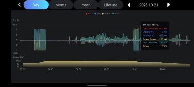

and here's the timeline:
where you can see shortly after the Force Discharge rule finished, when it hit its FDSoC, the house-load is being serviced from a Grid Import. Once the Force Discharge rule's time-period has elapsed, house-load goes back to being serviced from the battery
