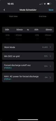

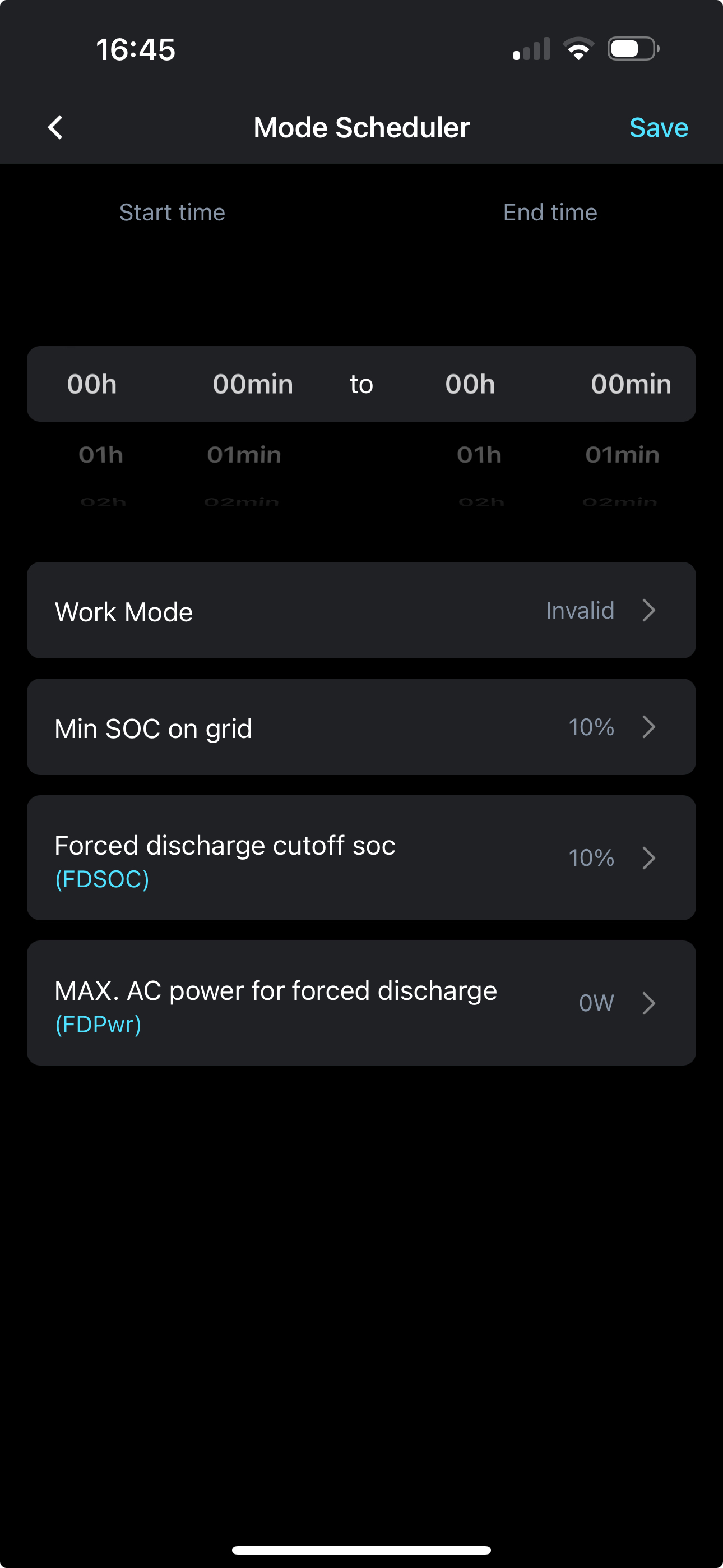

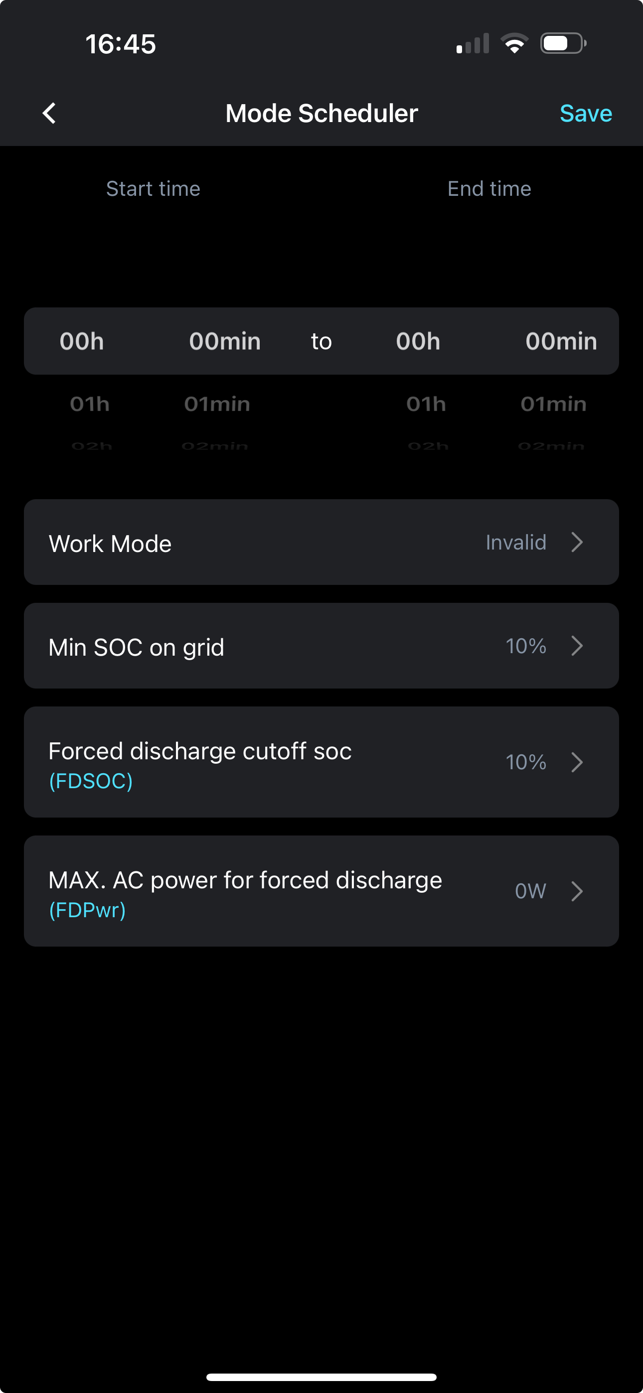

The work mode resets itself to invalid (see picture)

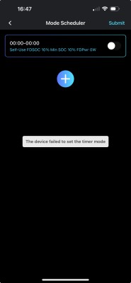

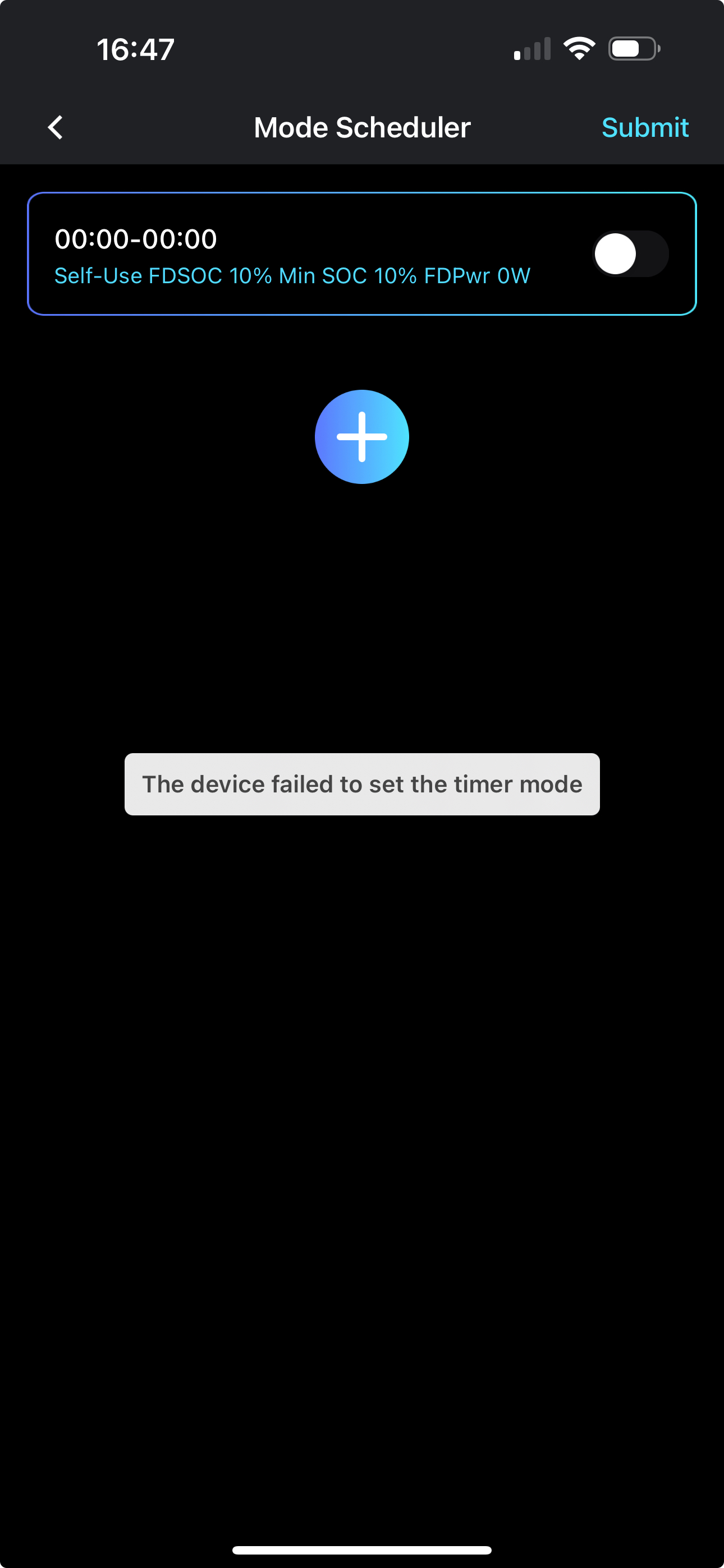

I reset this to Self-Use and get the error below and have to turn off Enable scheduler in Energy Stats

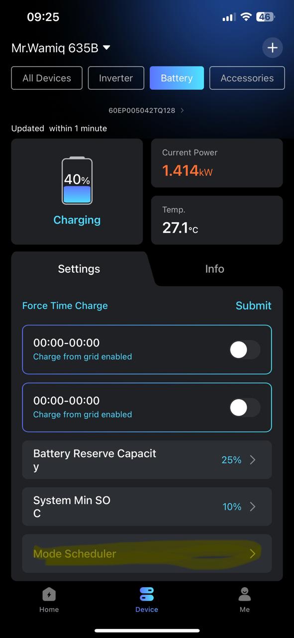

I have recently installed FOX Ess H3. My App showing Mode Schedular but it is diabled. pls guide how to get this enabled for me?
If it is greyed out, it means your firmware does not support it.
Contact your installer or local Fox service with your inverter serial number and ask them to upgrade to the latest inverter firmware.
