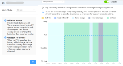

Hopefully this works for tomorrow's saving session...
Do I need to add the "self use" times if I'm already set to self use by default?
FoxESS AC-1-5.0-E Inverter

Posts: 1297
It returns to self-use when it has finished but as it deletes your normal charge periods when it is enabled, I prefer to disable it once it has finished and then reset my normal charge period and work modes manually.

I've created another template for normal use that essentially mirrors the 2330-0530 force charge, so will enable that one tomorrow after the saving session.
I will probably create templates for EV charging schedule (for additional off-peak hours) and the free electric. I will just need to tweak the hours in the templates before I apply them.

Graham, I have searched and searched but cannot find an area in the foxesscloud.com site, or the FoxCloud App, that looks like this, or the screenshots from the (very useful and informative!) wiki here https://github.com/TonyM1958/HA-FoxESS- ... #schedules
Do you or anyone have a URL (without any personal data) that might help me for this Schedule Strategy configuration area?
I have attempted to set it in the 'remote settings' on both the web UI and app, but managed to both not force a discharge for the last saver session, and then also NOT charge overnight. Both very annoying, so trying to get it sorted.

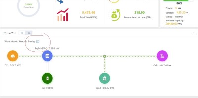

Posts: 1297
On the website click the link circled in red and it will go to the scheduler, but if you don't have up to date firmware it won't work - you need Manager 1.70, Master 1.60
