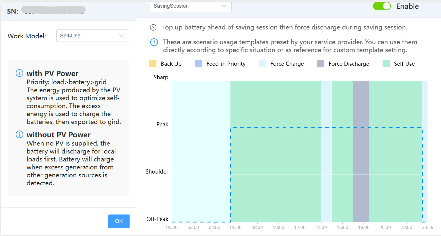

Hopefully this works for tomorrow's saving session...
Do I need to add the "self use" times if I'm already set to self use by default?
FoxESS AC-1-5.0-E Inverter
FoxESS ECS Series: 1x FoxESS CM2900, 6x CS2900 batteries
Lux Hybrid 3.6K Inverter
9x 320W JA Solar panels
Tesla
Octopus Intelligent Go
Posts: 1305
It returns to self-use when it has finished but as it deletes your normal charge periods when it is enabled, I prefer to disable it once it has finished and then reset my normal charge period and work modes manually.

I've created another template for normal use that essentially mirrors the 2330-0530 force charge, so will enable that one tomorrow after the saving session.
I will probably create templates for EV charging schedule (for additional off-peak hours) and the free electric. I will just need to tweak the hours in the templates before I apply them.

That's my understanding too. I've set an hour in the early afternoon to force charge, hoping to dump 15kWh (less my own usage) back to the grid.

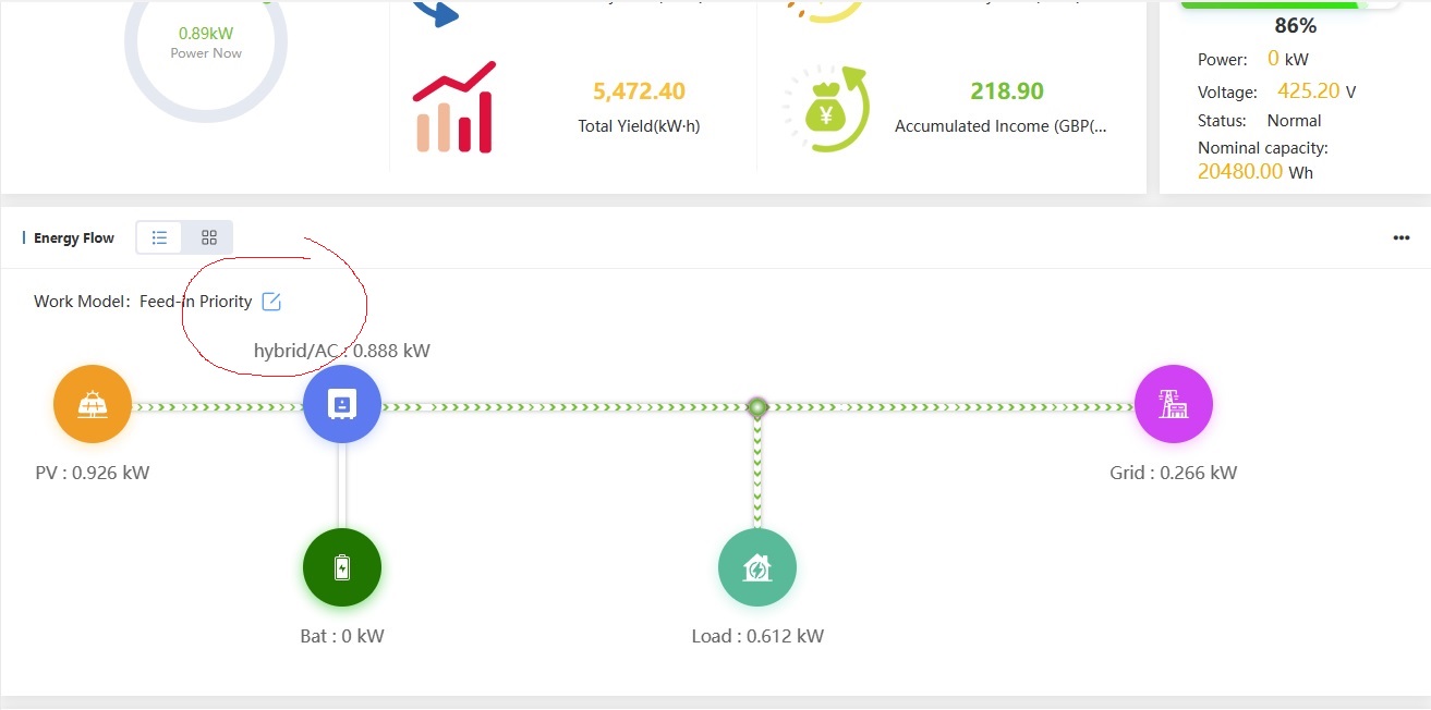

Posts: 1305
On the website click the link circled in red and it will go to the scheduler, but if you don't have up to date firmware it won't work - you need Manager 1.70, Master 1.60
