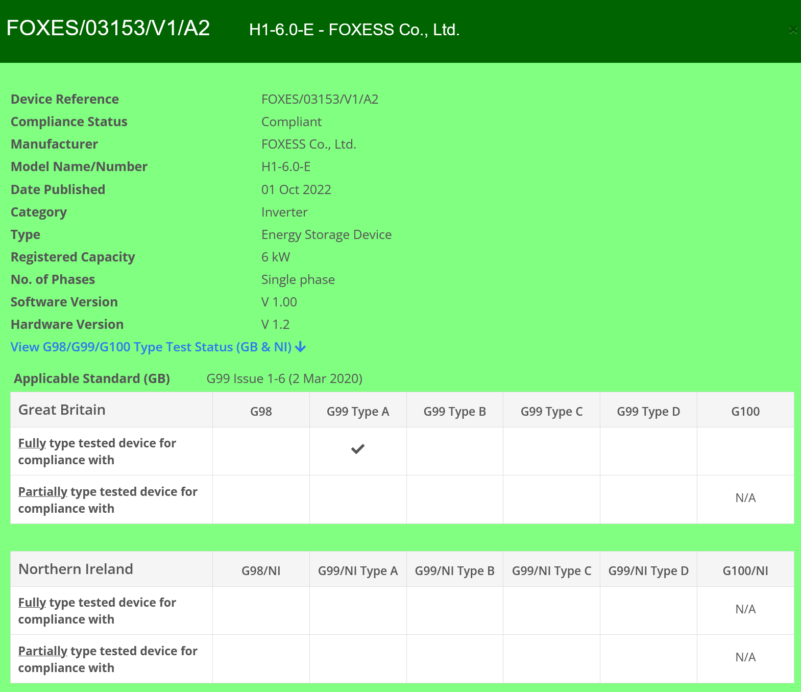

However as far as I can see, the H1 family of devices are not G100 certified eg
As such, if I want to upgrade my inverter I assume I need to do the G99 I would have had to do last year, had I known what I know now? (with the possibility of getting told "no", of course)
Hmmm, here is a G100 declaration for the H1 and AC: https://cdn.shopify.com/s/files/1/0257/ ... 1675684985

Thanks for the thoughts. Sounds like I do need to call the DNO at some point then, see how they "like" to do it. Do you have any idea why there is a G100 "declaration" for the FoxESS inverters but no evidence of them having being tested to that - seems odd!

Yes it's an odd one, for G100 there is no accreditation, it's more like a set of guidelines that are 'in addition to' G98 or G99 - so in effect it's like a G98/9 'plus' as long as the DNO accepts the principle.
