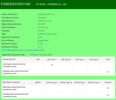

However as far as I can see, the H1 family of devices are not G100 certified eg
As such, if I want to upgrade my inverter I assume I need to do the G99 I would have had to do last year, had I known what I know now? (with the possibility of getting told "no", of course)
