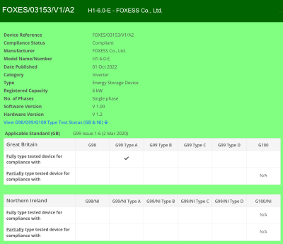

However as far as I can see, the H1 family of devices are not G100 certified eg
As such, if I want to upgrade my inverter I assume I need to do the G99 I would have had to do last year, had I known what I know now? (with the possibility of getting told "no", of course)

Hmmm, here is a G100 declaration for the H1 and AC: https://cdn.shopify.com/s/files/1/0257/ ... 1675684985

The G100 would make sense, although 'technically' you could upgrade your inverter, leave it's safety set as G98 and make sure an export limit is set to 3680W but some DNO's don't seem to like that, some prefer to see a meter installed rather than a CT, and others agree - in that scenario all in-house use is 5 or 6kw (depending on inverter), export is limited to G98 (16A).

Yes it's an odd one, for G100 there is no accreditation, it's more like a set of guidelines that are 'in addition to' G98 or G99 - so in effect it's like a G98/9 'plus' as long as the DNO accepts the principle.
