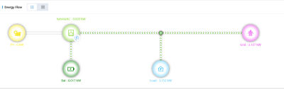

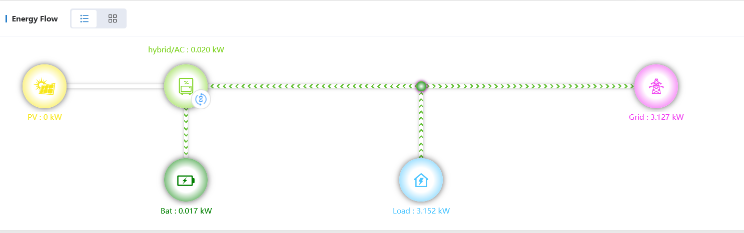

I'm utterly confused by some of the data. When looking at the Energy Flow information (graphic) in the web interface, the flow direction (of the arrows in the animation) is TOWARDS the grid (as per screen grab below). Feed in Power shows a value (currently around 2 kw). I have no solar as yet and Work Mode is set to "Self Use".
Q: Why does it appear to be sending power to the grid or am I completely misunderstanding?
Many thanks for any help/advice.

In case it helps anyone else - I've been in touch with Fox Uk who were very helpful (refreshing these days!) and it turns out that the installer has put the CT clamp the wrong way around. It's pointing to the meter as it should be, but perhaps it's reversed at the other end - who knows - I've reversed it, and all is well :)

Thanks for confirming the cause of the fault, useful for anyone else with a similar issue
