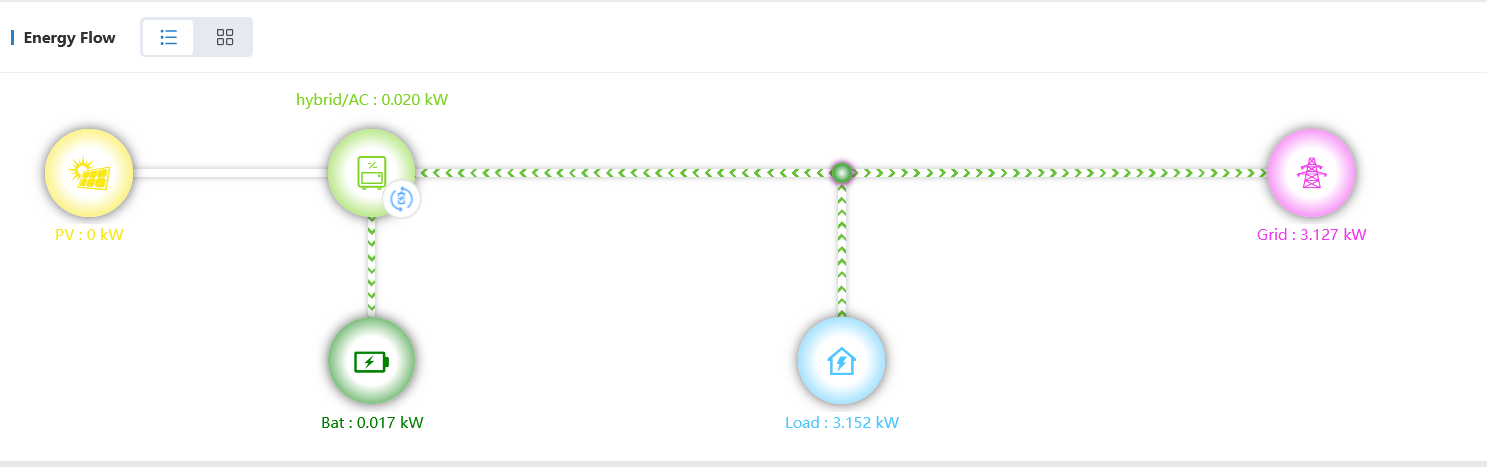

I'm utterly confused by some of the data. When looking at the Energy Flow information (graphic) in the web interface, the flow direction (of the arrows in the animation) is TOWARDS the grid (as per screen grab below). Feed in Power shows a value (currently around 2 kw). I have no solar as yet and Work Mode is set to "Self Use".
Q: Why does it appear to be sending power to the grid or am I completely misunderstanding?

CT clamp is on the live wire pointing in the direction of the Meter.
I have no Solar installed yet (coming at a future date when funds allow), so I'm simply looking to make use of battery storage until then.
Work mode is set to "Self Use".
