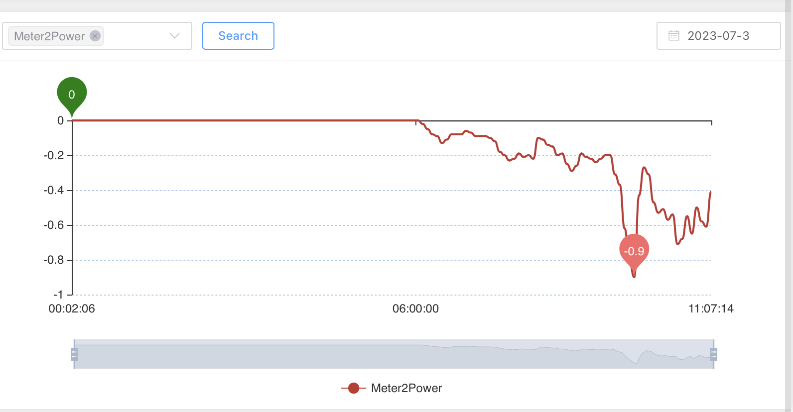

I have a similar question, but more related to the CT2 clamp with the AC1-5.0-E inverter. I added the extra clamp to monitor PV output, the manual suggest to put the arrow towards the house loads, but normally this would point towards power source (as does the grid CT clamp).
Having it pointing at the loads gives a -ve power figure as expected, even though it is +ve as it's a power source. If I swap this round the power figure goes +ve as expected, but the load_power inverts at the same point.
Which way should the clamp face?
Pictures before and after switching clamp direction...
Any help appreciated.

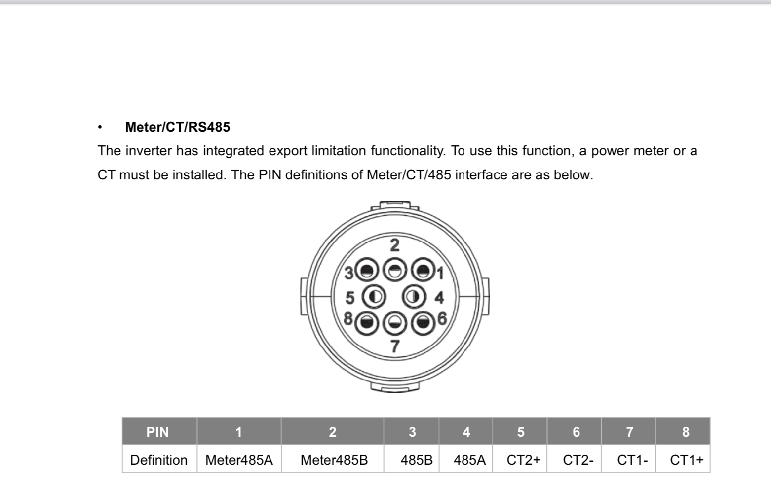

They do just wire into the existing ‘meter’ plug where CT1 is fitted - the plug is a bit fiddly to get into, it comes with a tool but the installers tend to keep them, you can do it with a couple of flat bladed screw drivers - if you do a search on here i’ve posted a few pictures over the months of how to access the connectors inside
