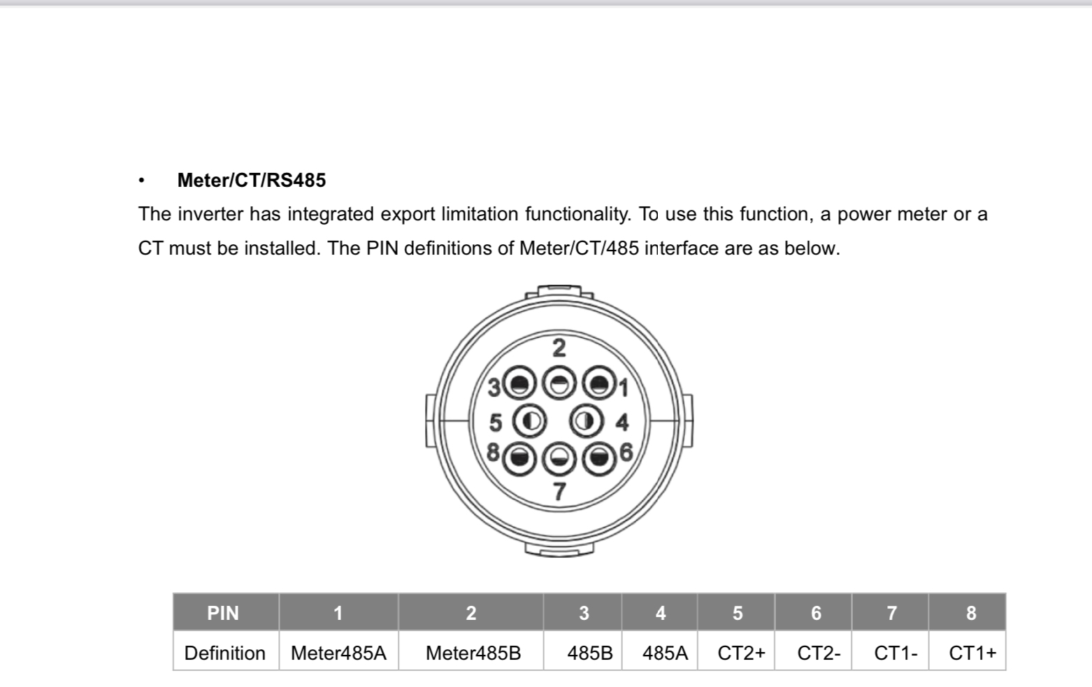

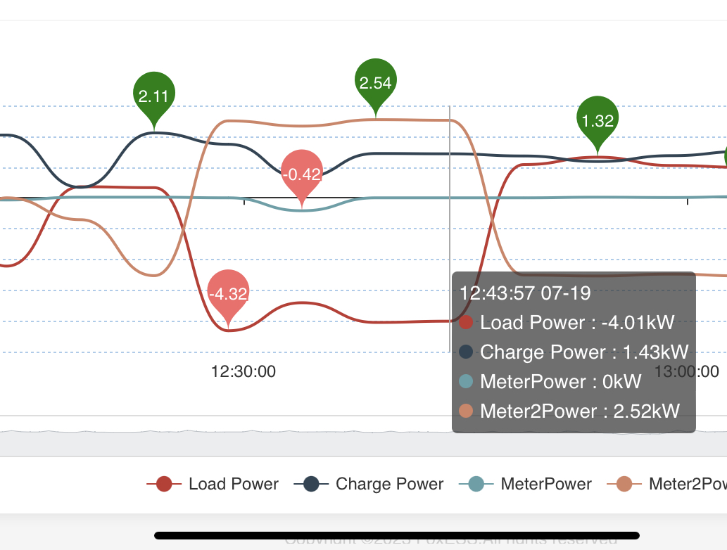

I have a similar question, but more related to the CT2 clamp with the AC1-5.0-E inverter. I added the extra clamp to monitor PV output, the manual suggest to put the arrow towards the house loads, but normally this would point towards power source (as does the grid CT clamp).
Having it pointing at the loads gives a -ve power figure as expected, even though it is +ve as it's a power source. If I swap this round the power figure goes +ve as expected, but the load_power inverts at the same point.
Which way should the clamp face?
Pictures before and after switching clamp direction...
Any help appreciated.

Paul, sorry for the delay. As Dave posted got mine from tradesparky and it's the same as his link, the fox one. I've got a spare tool if you need it. Just drop me a note and I'll pop it in the post. I put mine on the AC line next to the inverter as the PV and battery inverters sit next to each other. Follow the manual on the direction, it points towards the house loads, not the PV inverter. The signal will be a -ve power when generating, as attached picture. Just enable CT2 on the inverter when connected.
