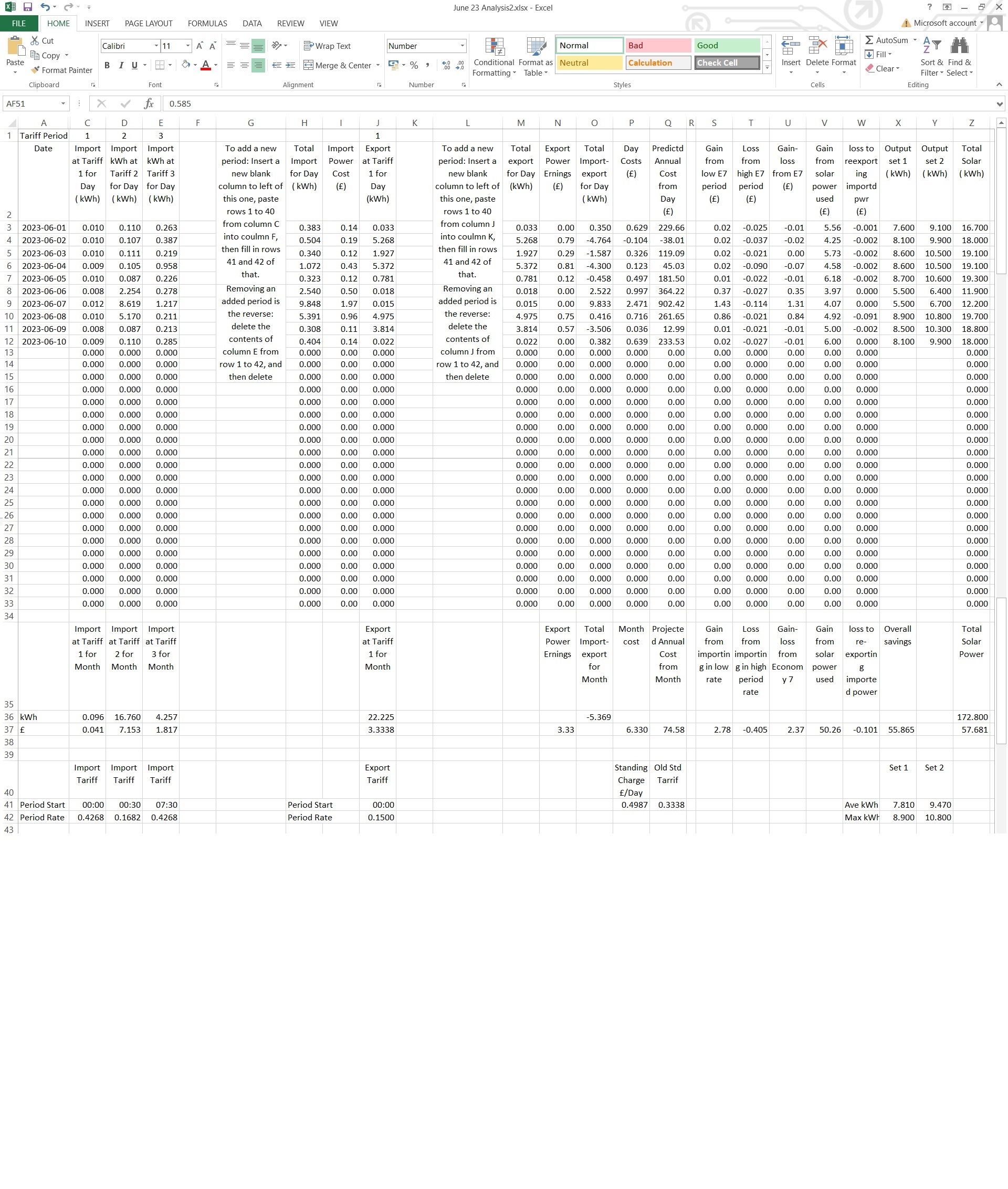

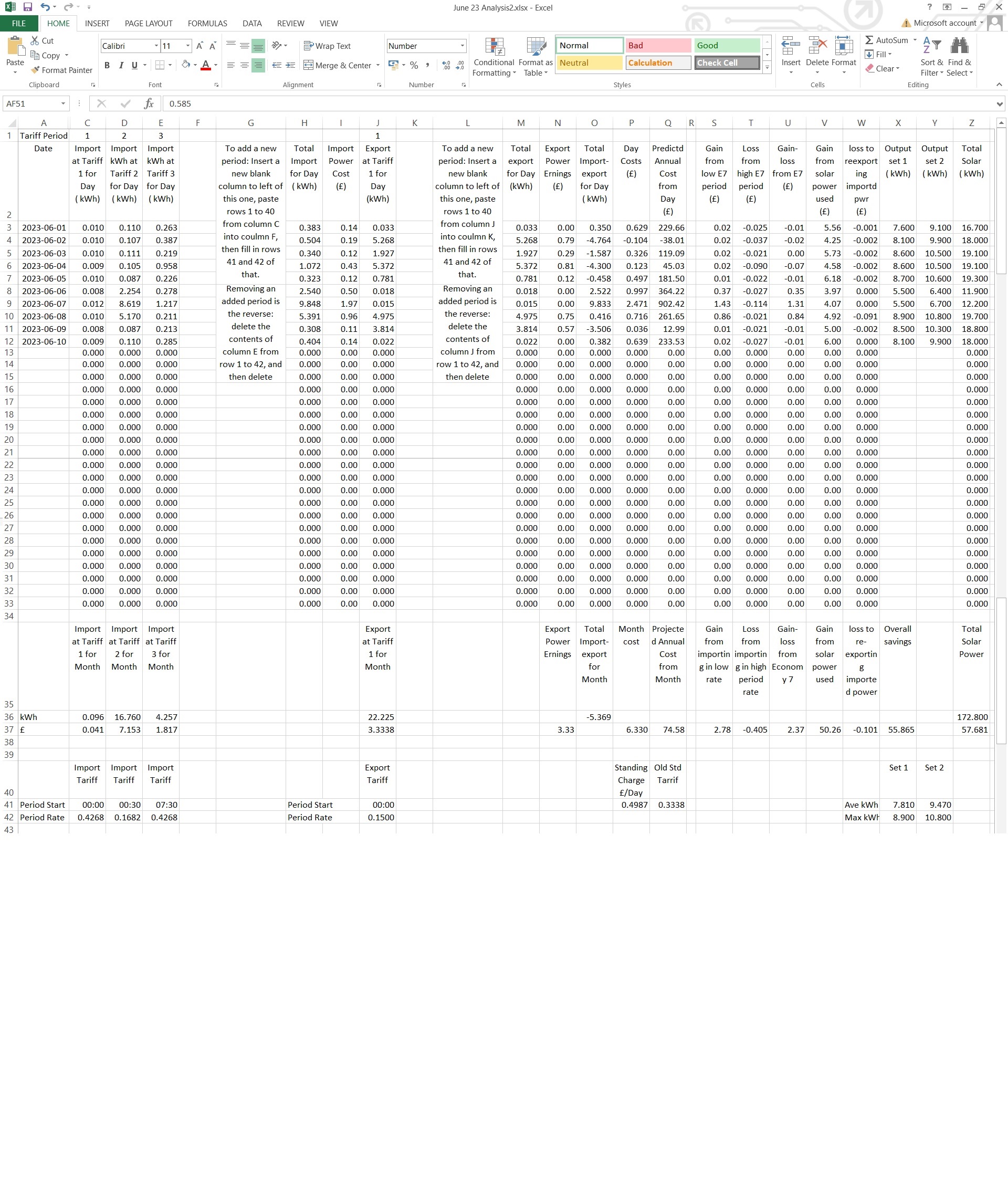

I also use the data I can get from Octopus, as CSV (Comma Separated Variable) files. I paste the power import and export data from those files into an Excel spreadsheet I have written, and now enter the day's panel set yields, to analyse a month at a time.
All the stuff to the east of column R is about what I'm saving through having Economy Seven and Octopus Outgoing fixed set up, and what it costs to import at night and export in the day if the battery fills - not much, it turns out. It predicts, probably with poor accuracy, what the year's bill would be if every month was like this one. It's not quite right yet, but it's getting there.

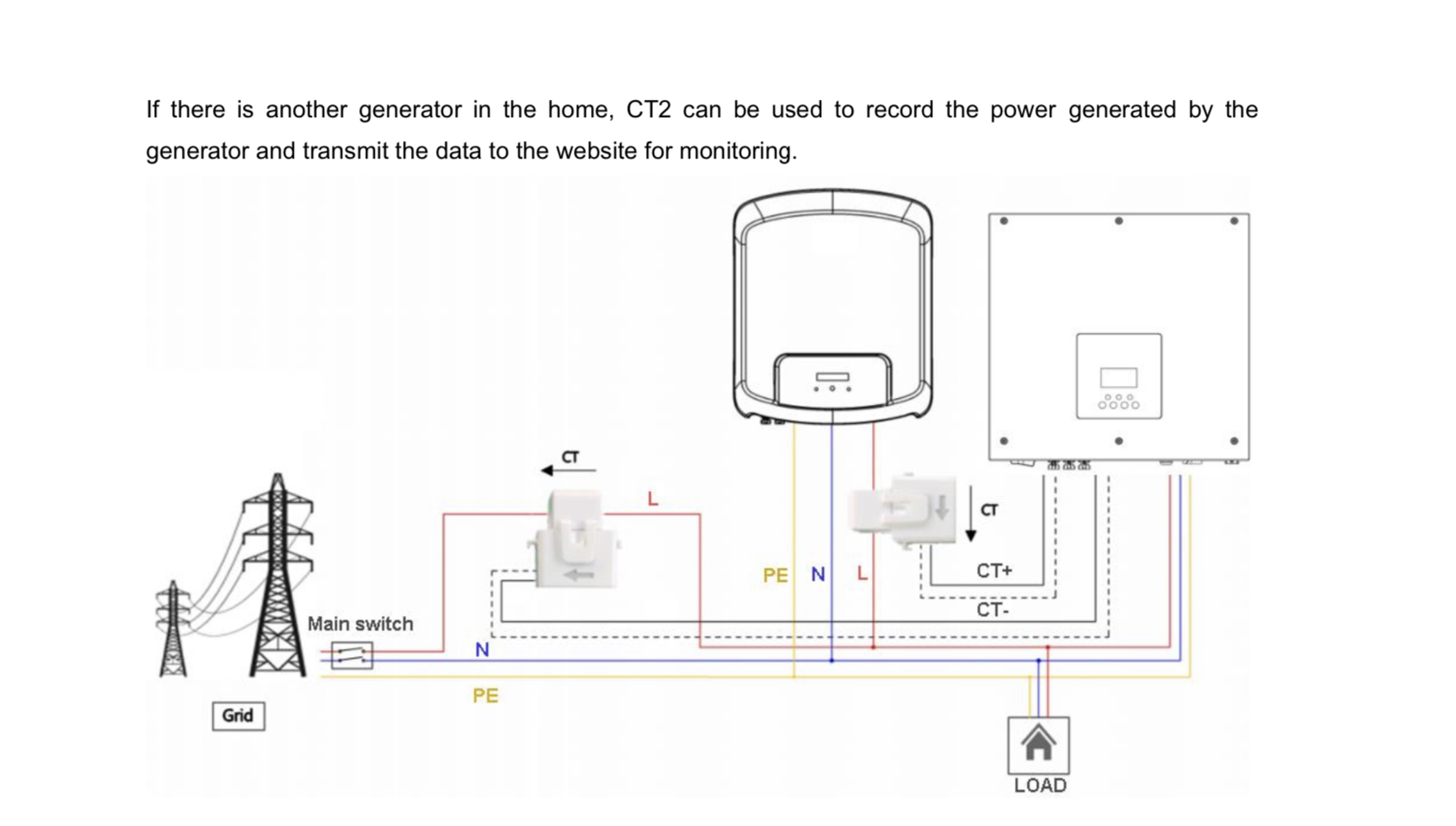

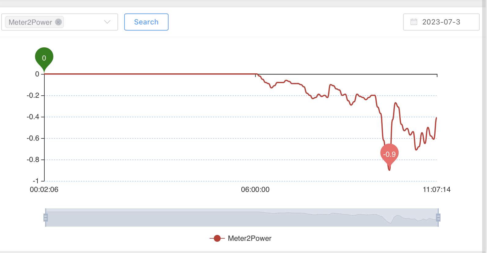

I have a similar question, but more related to the CT2 clamp with the AC1-5.0-E inverter. I added the extra clamp to monitor PV output, the manual suggest to put the arrow towards the house loads, but normally this would point towards power source (as does the grid CT clamp).

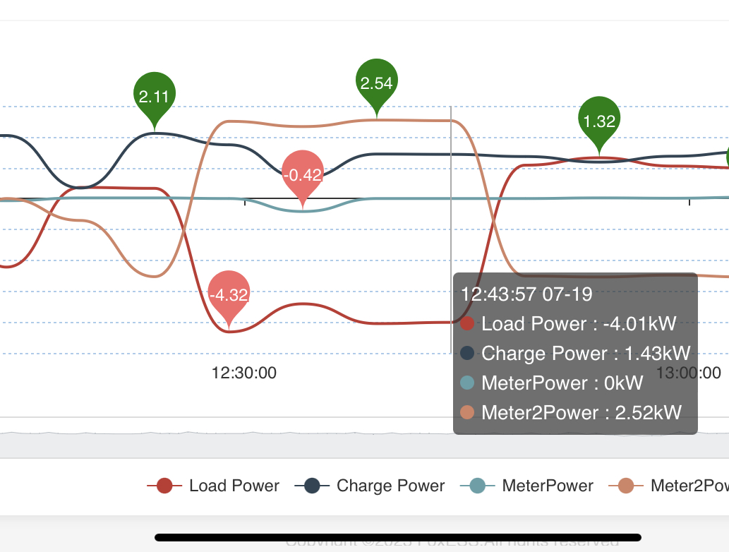

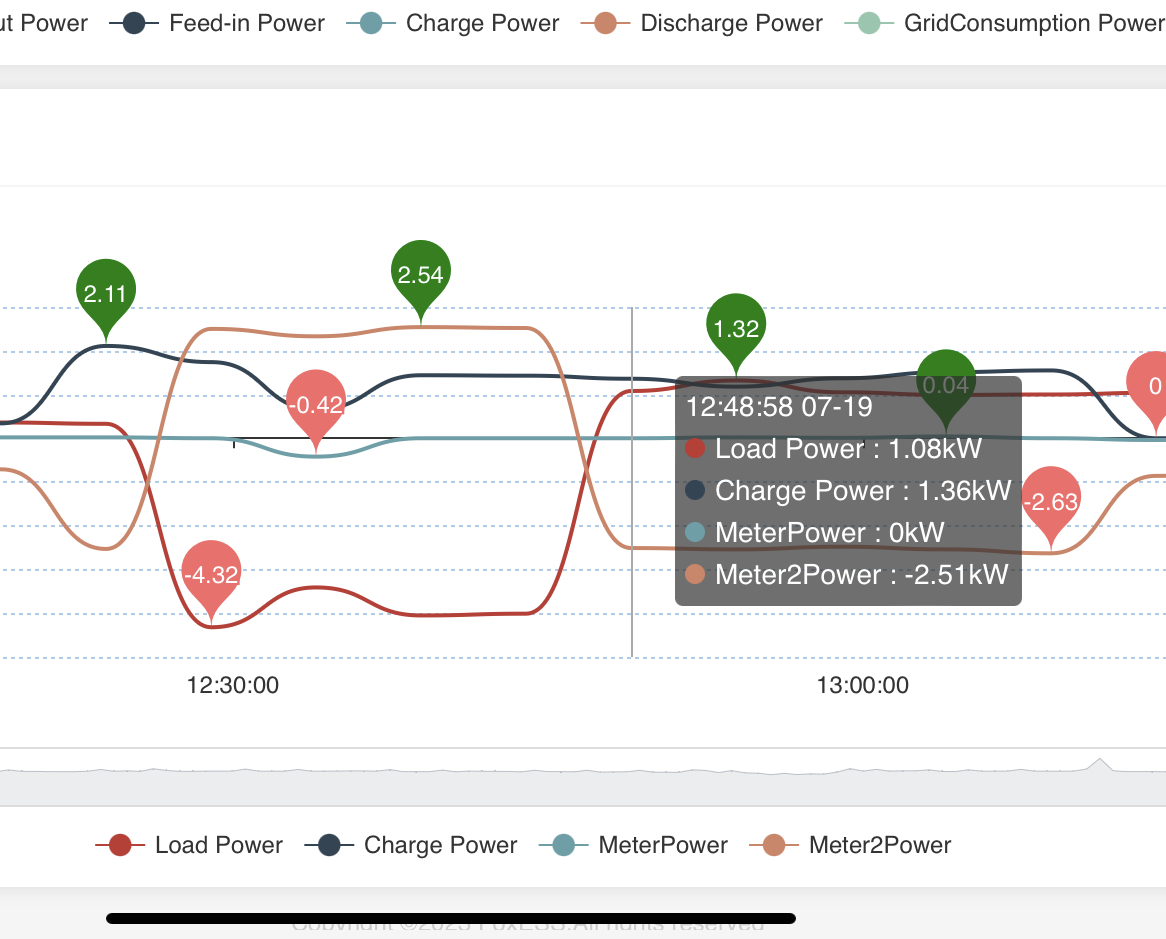

Having it pointing at the loads gives a -ve power figure as expected, even though it is +ve as it's a power source. If I swap this round the power figure goes +ve as expected, but the load_power inverts at the same point.
Which way should the clamp face?
Pictures before and after switching clamp direction...
Any help appreciated.
Ian

Actually, I use the Excel sheet for daily analysis. I'm trying to see if there's a value of max state of charge that will minimize both the export of power I drew in overnight and the consumption of power at the higher tariff for economy 7. And to get what I need for that I need the daily Output Power values for the two solar panel set inverters and the change of SoC for the day from the app, and the charge capacity of the battery, which I worked out from how much Output power in kWhs gives what change in SoC - using the change in SoC for the day and the charge capacity of the battery to get how much power overall was stored or drawn from it.
However, it's very much more an issue of minimizing consumption in the high tariff period, which just means charging to 100 percent every night. Still, it's something to do till I can get back to fixing the Dolomite Sprint, TR7 Sprint, and Herald.
If I just wanted to try to minimize the power consumption from the house, I'd just look at the load value from the app. But minimizing that consumption would basically mean continually beating the kids with a stick, etc., and the SS (Social Services, not SchutzStaffel - well maybe) tend to frown on that a lot. So, I have to resign myself to minimizing the cost of whatever excessive quantities of power the little darlings (The Horde of the Things) might use - it's the continuous infrared cooking of the tortoise and boiling the turtle in whatever that soup it's swimming in might be that wind me up most.
But there's still some work to do with this spreadsheet: I've now got it to calculate the daily house Load Power (Grid consumption - Grid Export + Solar Output Power + Battery Output Power). But I've now found I can get the Load Yield value on the Sites Details page. Those two values have a day-to-day profile with a very similar shape, but differ by between 1.5 and 2.3 times, i.e the house load I calculate is about twice the Load Yield value, which is disconcerting. Moreover, the differences and ratios don't match up with any other parameter.
However, I just manually entered the data to calculate Load Yield from Feed-in Yield, Consumption Yield, Battery Output Power, and the Solar Output Power values, i.e. using nothing from the Octopus CSV data. From that I get a Load Yield value that is between 2 and 5 percent of the house Load Power I calculated first, i.e. also very different from the Load Yield value on the Sites Details page. So I think that latter value from the app must either be calculated or measured wrong somewhere, or isn't what I think it is.
