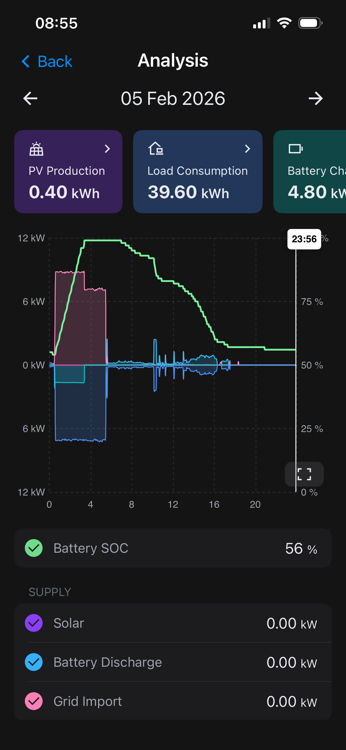

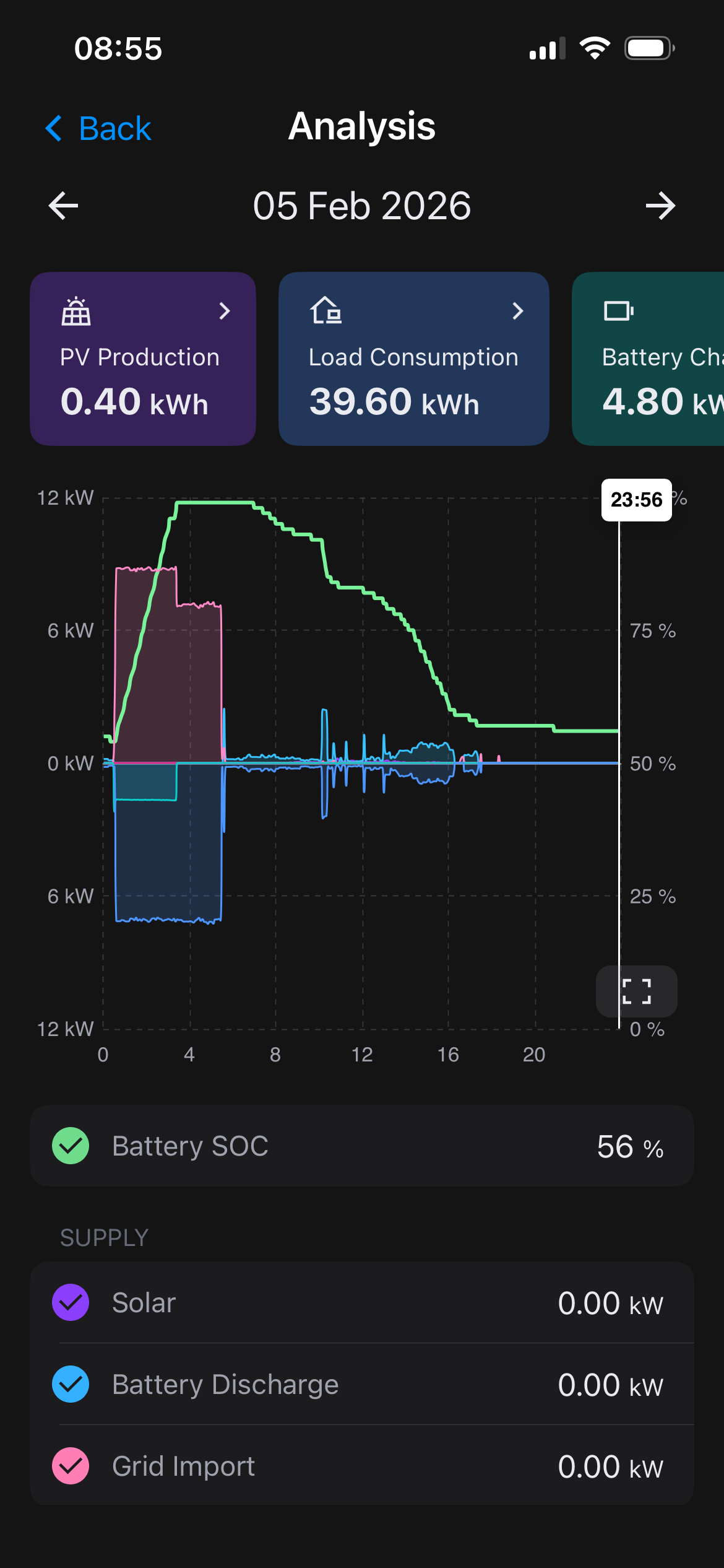

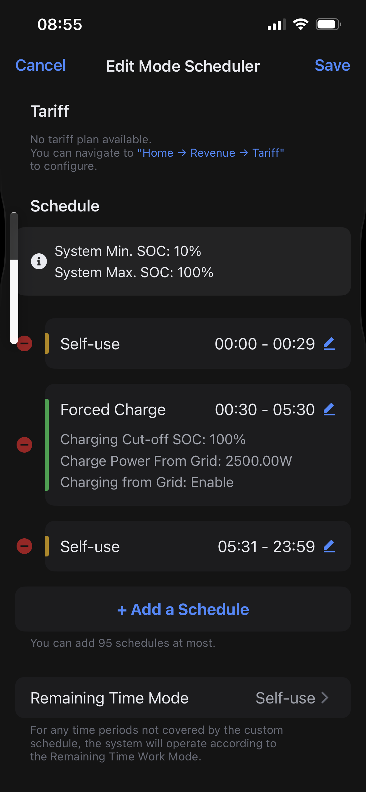

Can you post the app settings you are using for the charge period, and also it would be helpful if you could post the graph you see when you click on ‘Total Production’ so we can see how much load is being reported.

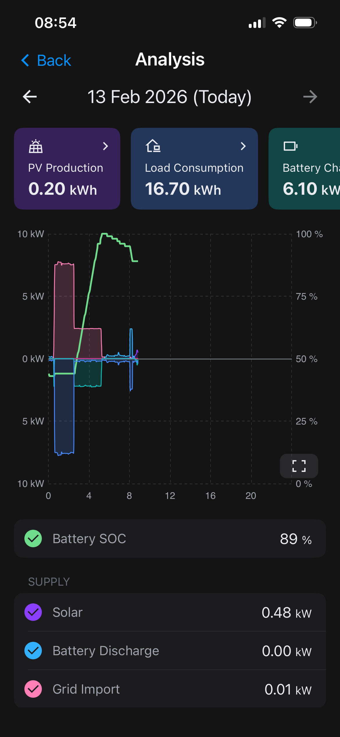

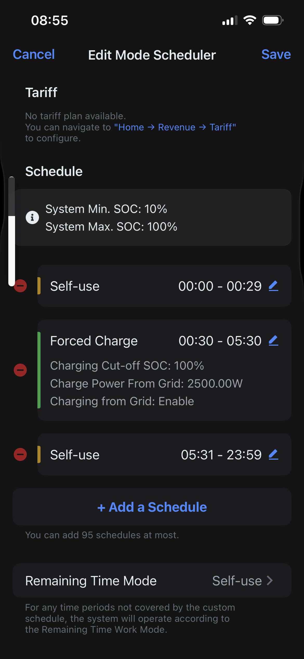

Attached settings and how it was charging and second how it charges now. I had to reduce the EV charge duration so the Battery would charge regardless. But prior both would charge in parallel so could get 5 hours EV charge and Battery to 100%
You either need to reboot your Inverter as it has gone a tad loopy, or you are having a FW bug perhaps that needs an update.
At 10,000 Watts of Import, now 12,500 either should have allowed the battery to charge at the same time as you had head room with your EVCP being around 7,xxx Watts.

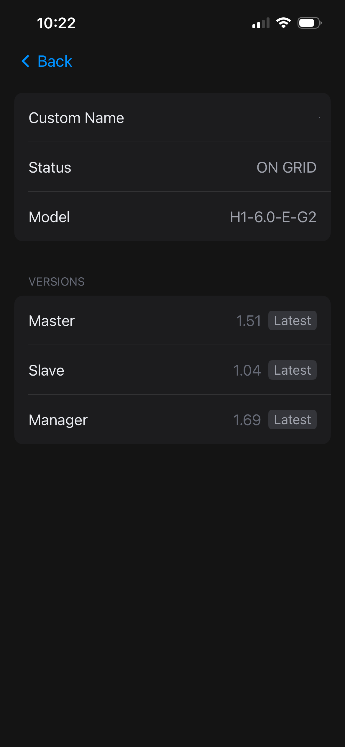

Can you find your Inverter on this list and tell us what version you have vs what is available?

p.s. Your Force Charge end time should be 05:29, and the self-charge start at 05:30, though this is not causing the trouble.
I do see the FW versions are fresh, not sure when the upgrades were loaded.

Your force charge settings look ok, and firmware is up to date according to Fox cloud.

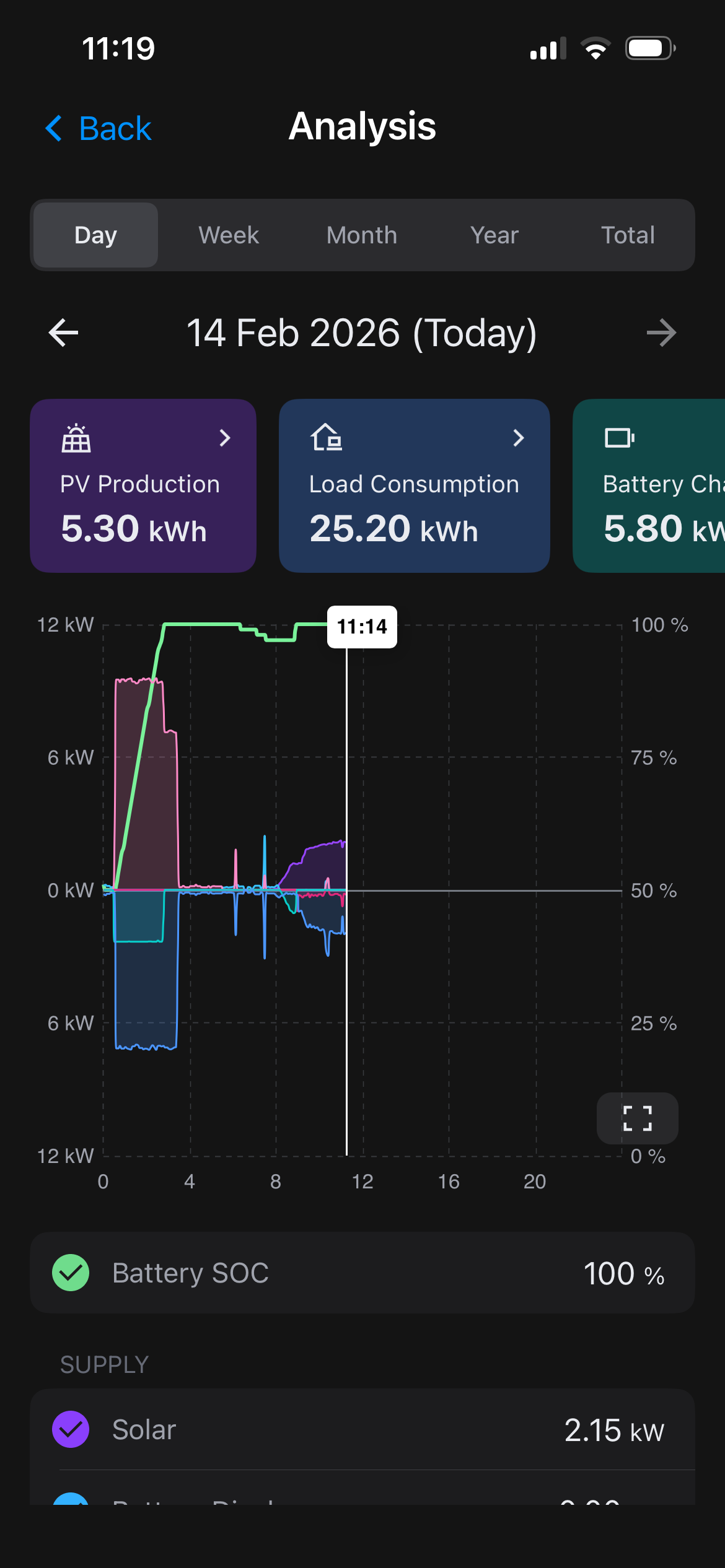

Thanks for all the help. Looks like now fixed, although it did not charge battery at 3.5 kw as per settings. As attached
